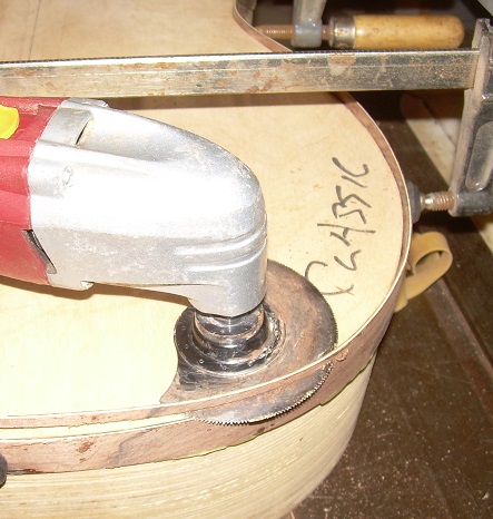

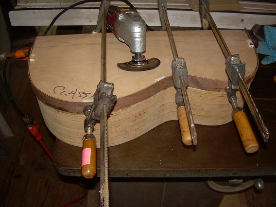

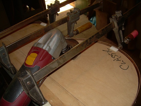

While I was in the shop today I found some purfling offcuts that I had molded some time ago. When I cut them on the table saw I usually have some of the layup left over (I only let my fingers get so close). Carl's idea of using the the bending form and mold as an inside/outside clamping caul would probably work better than what I did (it might be easier to align the work).
But here goes - the first picture shows the off cut clamped to a bending form using f body clamps. I tried using rubber bands but that was a "fail". the second picture shows the smal lwhite spacer blocks that set the width of the purfling strips. That was the most finicky part of the process, and where what Carl has suggested may make things easier.
Re: Cutting purfling after gluing
The oscillating tool with a half moon blade is held flat on the bending form and saws through the purfling layup. The half moon blade allows you to keep cutting even as the blade meets the work at varying angles. I also allows you to cut "under" the clamps.
When I switched to the mold the layup was originally molded with I found I could use less clamps and set things up easier. D'oh!

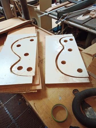

Here's the caul/jigs I used for gluing the solid linings, melamine over particle board. Lined the edges with packing tape to resist the glue. Holes are for clamps.
Tell us how it worked out Enrico.
Not pertinent to this thread, but now I glue the strips up for the linings per a description by Bryan Bear. Somewhere, maybe here, or OLF.Tell us how it worked out Enrico.

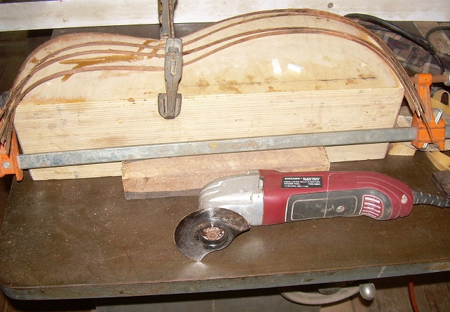

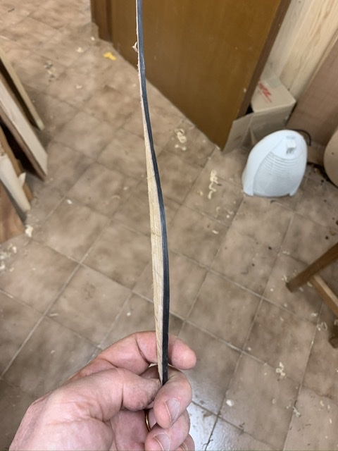

Thanks to all for the nice suggestions. I want to give you an update. I did it on the bandsaw. I glued a sacrificial mold just at the waist area. It only took 5 minutes to build and it turned out perfect. Yes, it can be done on the bandsaw quite easily. I didn’t feel there was a time when I risked doing some damage. The only problem so far is dealing with even thickness. That can be the weak part of the process. But as we all know, usually when you try alternative routes, you make life easier at a certain point and discover that you have troubles somewhere else. Sometimes there is not a perfect way of doing things but something that works for someone and doesn’t for others. In this case I am not completely happy mainly because I have to spend some time to thickness the purfling. And the results are not perfect. I could obviously make up some jig to cut it more precisely. Probably it can be done.

Another picture
