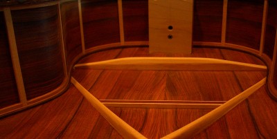

Bob,
If you are doing a solid laminated lining, then just use some of your lining material for the side braces as well, running the braces the full width of the side.
Glue the side braces first. Then fill in between them with your first layer of linings, which are easily cut to fit between the braces just by holding them butted up to the first brace and then mark the 2nd brace and cut.. Your subsequent lining layers go over top this first layer and lock in the side braces automatically.
Maybe a picture would be clearer..

Thanks. I know mine won't come out nearly as artistically as yours Randy, but that does seem a whole lot easier than tucking. It will also help solve the problem of having cut one of the liners 1/32" too short.

Your work is exquisite Randy. That is a truly beautiful guitar interior!
And your side braces are perfect = no stress risers there at all - it is all woven together.
