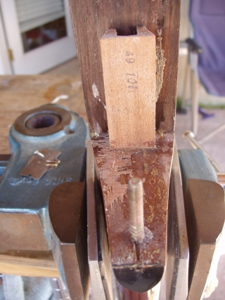

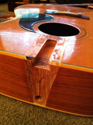

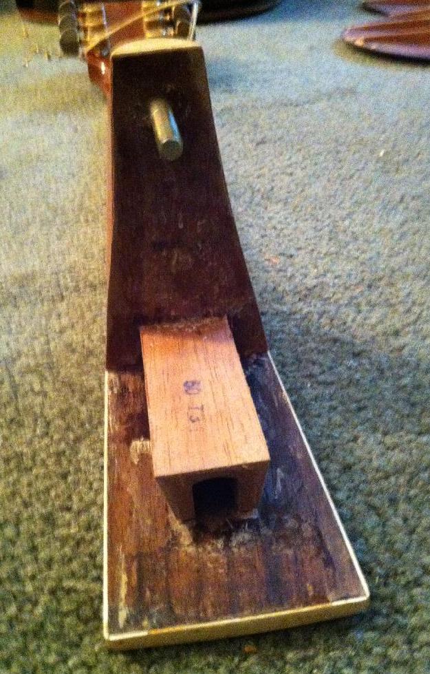

If it's like the one I did a few years ago, it's a bolted in butt joint, inlet into the body about 1/8". Under the fingerboard extension was a sliding dovetail, and I can't remember if it was glued or not. There was one metric hangerboltat the bottom of the heel.
I may have some photos of this; I'll check.

I just found these:
conn body dovetail pocket.jpg (60.01 KiB) Viewed 8842 times

Jeff thanks for the info. How did you get it unglued. Did you steam it? If so, where?

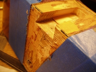

I know its not, but that heel-block looks like OSB.
Posts: 1475
Re: Conn Neck Reset
Post by Michael Lewis »
Chuck, that's just the various layers of the side lamination where things got pulled apart.

Got it apart. Sliding dovetail just like Jeff said. Glue everywhere. Steamed through the 14th until I got a small opening of the butt joint, then steamed through that opening. After much wobbling from the peghead I was able to enlarge the opening of the butt joint. More steam finally made it come loose. Thanks again Jeff, you saved me a lot of misery.
