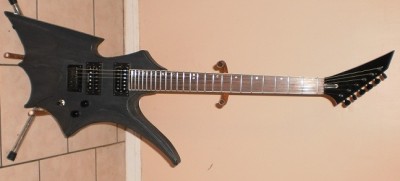

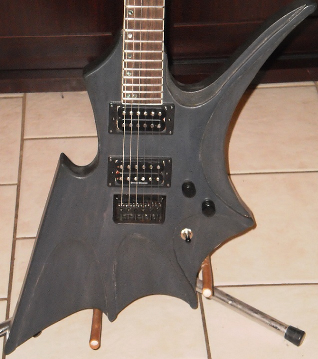

Here's my latest guitar i finished. It's been sitting around for a while and i finally got around to putting everything together. I got the idea for the shape from a picture of a batwing style guitar; this is my take on the design.
Body: Basswood
Neck: 24 fret maple / rosewood fingerboard
Pickups: Duncan Designed HB-102 / Vol, Tone, Toggle
Bridge: Black Hardtail string through
Tuners: Black Goth w closed backs
For the finish I had some red and green minwax colorstain laying around. I mixed them together til i got a concoction of color that I was happy with. It's sort of a midnight purpleish blue. I put tru-oil over that. The Basswood didn't take the stain overly well as it is a little blotchy but it's very sutle and kind of gives the look of a natural bat wing. I didn't plan it that way but I'm happy with the results.
I put some strings on it and did a quick set up. I'll have to fine tune everything but as is right now is pretty good. It has good action, plays fast & is pretty well balanced.
Here's a pic.
Body: Basswood
Here's a pic.

Haha, was that an intentional misspell?Eric Schmitt wrote:Tuners: Black Goth w closed backs
Pretty brutal looking guitar Eric!

Unfortunately that was not on purpose but it is pretty funny. Amazing what one letter can do ha ha!

How is the high end of the pickups? Do you come anywhere close to bat frequencies?
Anyway, that's a cool metal axe!

That looks awesome.

It kind of makes me want to show my flattery for it by building one with a similar shape. I've never had a floyd, and it looks like a shape that would beg for one.

For some reason I now have "Peace Sells" running through my head.
Nice job!
