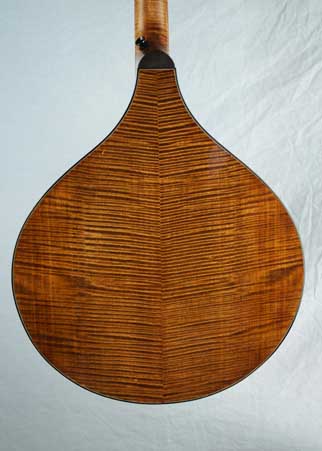

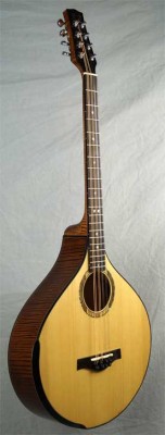

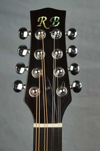

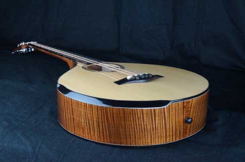

Here is my newest instrument.
Irish Bouzouki / Octave Mandolin
Curly Soft Maple back and sides
Adirondack spruce top
Curly Soft Maple neck
Ebony fret board and headstock veneer
African Blackwood Bridge
Spalted Birch and abalone rosette

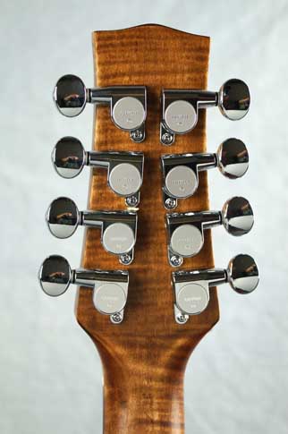

Gotoh mini tuning machines
23 inch scale length
KTM SV finish on body
Colortone alcohol dye sealed with shellac and a coat of System 3 epoxy.
Waterlox oil finish on neck with FP headstock veneer.

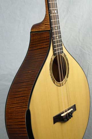

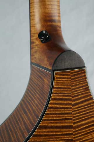

It is a great looking instrument - I love the tiger stripe.
I am intrigued by the arm rest area. I can't tell from the pictures, but it looks almost like you beveled or rounded off the corner and covered it with plastic or laminate - but maybe that's an optical illusion. Can you explain more about that?
- Jim McConkey
- Posts: 1094
Re: New Irish Bouzouki / Octave Mandolin
Jon, not to preempt Ron's answer, but it appears beveled and someone in the MIMF did a tutorial on how to do it a while back. As soon as the Library makes its grand reappearance, it should be available.
Ron, don't let that stop you from telling all about it here!
- Posts: 153
Thanks for comments folks, I really appreciate them,
Jim - It is 3 1/2 inches deep and the neck joint is a flush bolt on.
Jon - as Jim mentioned it is Laskin style arm bevel. I believe Tony Karol did the tutorial. I know it is up on the OLF archives as well.
Dave - I get my SV directly from Grafted Coatings, the manufacturer. They will ship quarts or gallons.

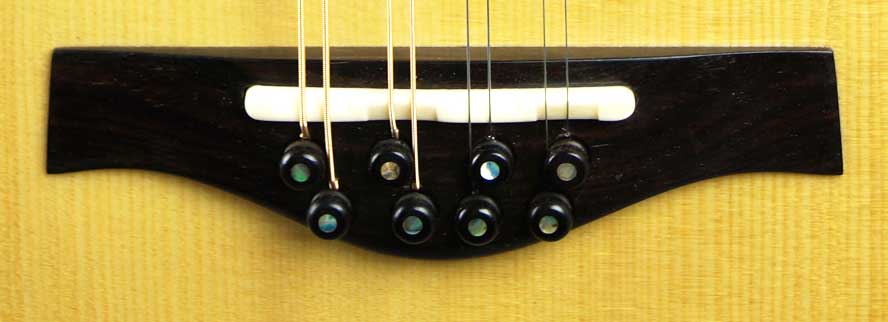

- Posts: 1325
Beautiful instrument. I'm trying to build one of these as my first acoustic project. Can you post a closeup picture of the bridge so I can see how you spaced the pins? I assume the saddle has to have slots to appropriately space the strings.Thanks.

- Posts: 153
Hi Peter,
Here is the photo of the bridge. I highly recomend Graham MacDonald's "The Bouzouki Book" if you are planning this style of instrument.
