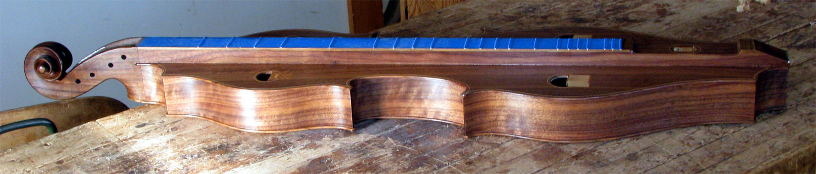

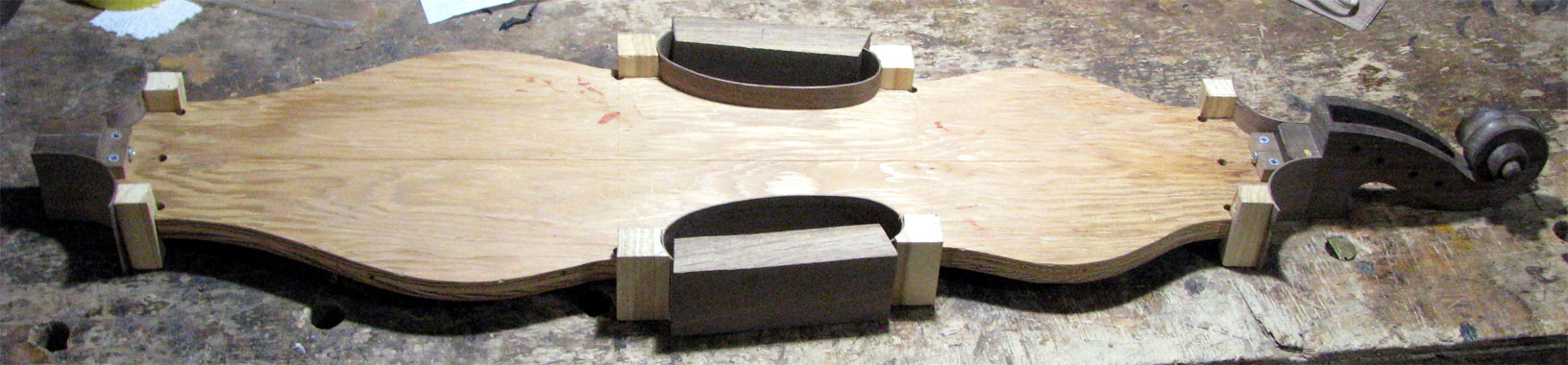

- Posts: 1306
Re: Appalachian dulcimer mould
I've always used a peg board for hourglass and teardrop shaped dulcimers. The sides are threaded in and out of a pattern of dowels to define the shape. The dowels are short enough to allow for gluing in the top liners. Once they're in the top edge is dressed off, and the top glued on. When that's dry the whole thing can be lifted off the pegboard, and flipped over onto another jig to work on the back.
A few years ago I got a commission for a fancy dulcimer in what I call the 'Ozark' style. It has corners, like a fiddle. I had not built one in some time, and ginned up a new shape and mold for it. Here's the mold with the hea and tail blocks on, and the C bouts gluing up. Here's a shot of the assembled instrument with the first coat of varnish.
