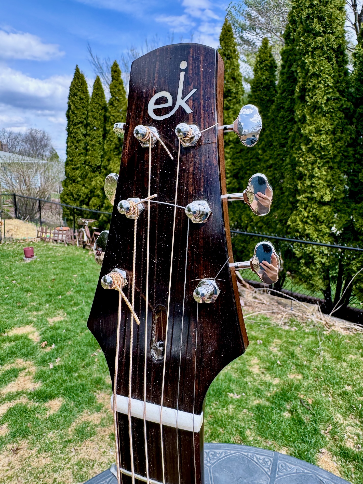

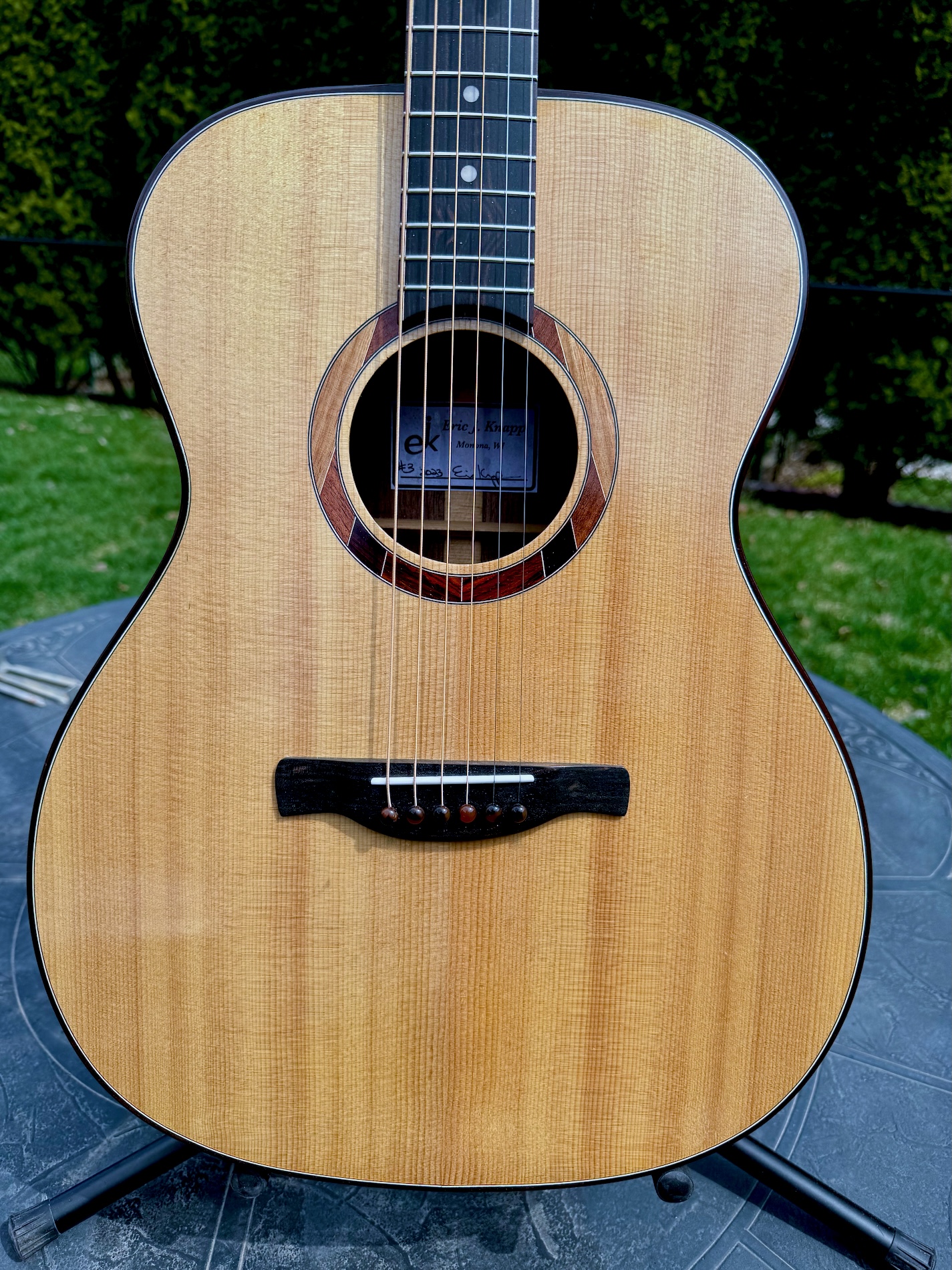

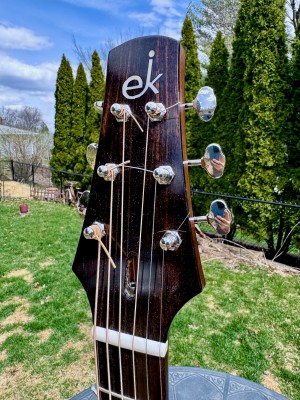

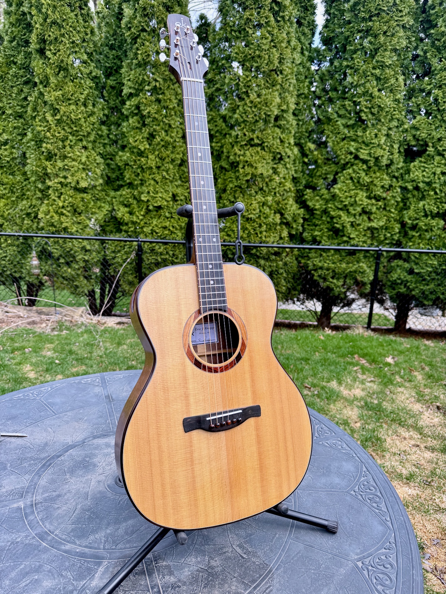

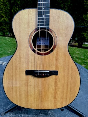

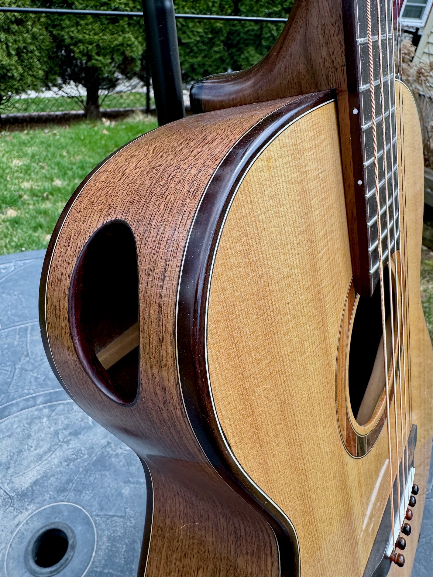

Hello, Folks.
Here is my third guitar. It's definitely better than 1 and 2 so I think I might be making progress. This was the first guitar I've played with a side port and I like it. All of my future guitars will have one. Here are the specs:
- Sitka Spruce top
- Black Walnut back and sides
- Black Walnut neck
- Ebony fretboard, headstock veneer, and bridge
- Katalox binding
- Tagua Nut inlays
Thanks for all the help and support, I'm on to number 4 (and 5, and 6...).
(More pics in comments.)

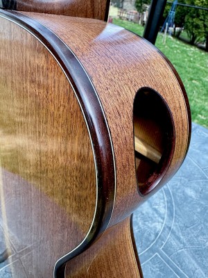

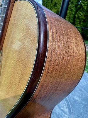

As always, I love any and all feedback. The learning process is a long one, eh?
Posts: 3249
Re: Guitar Number 3

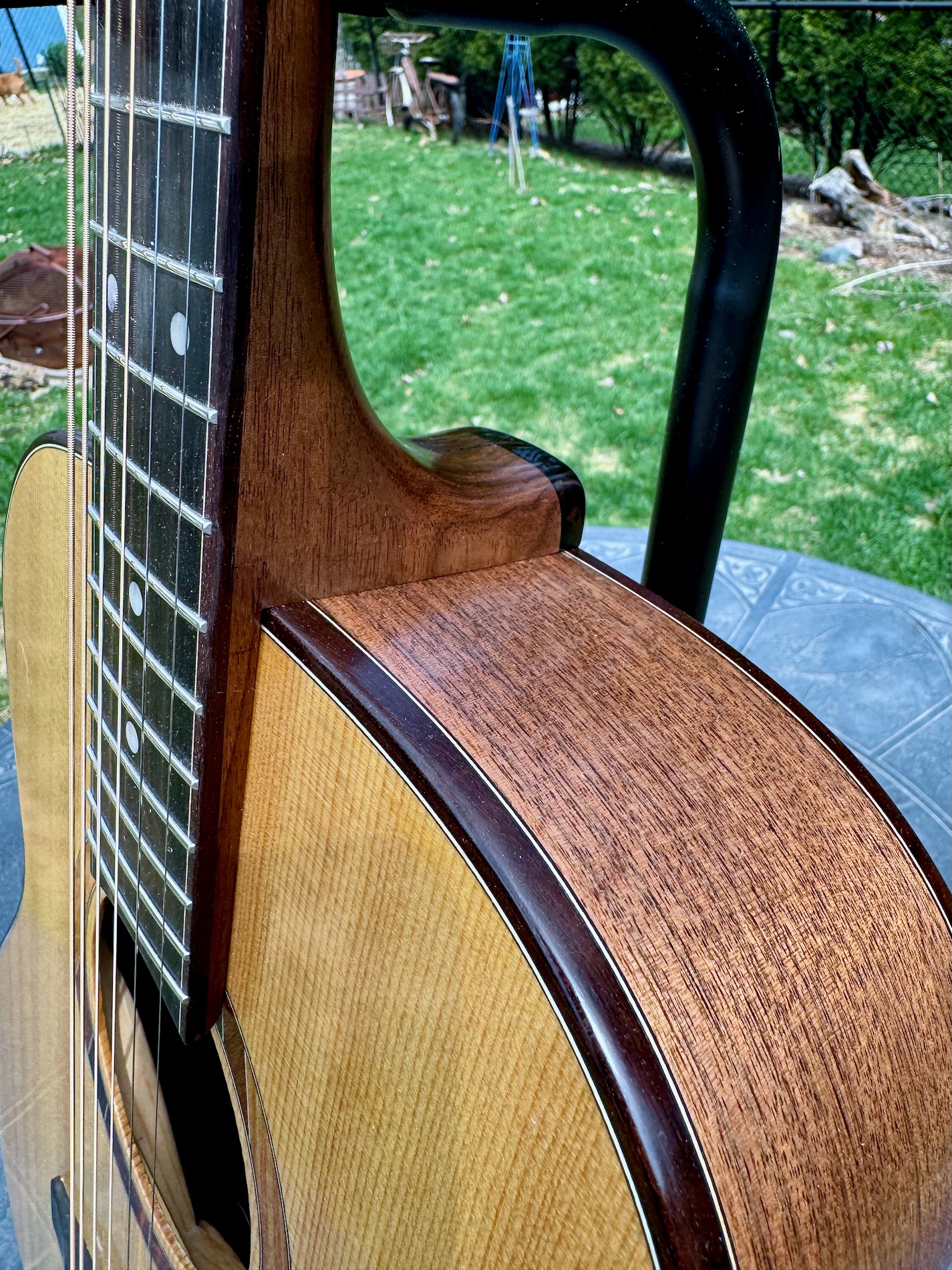

Looks great, Eric. I like the nice large radius on the binding. Should be comfortable to hold.

Barry Daniels wrote: Wed Apr 10, 2024 8:33 pm Looks great, Eric. I like the nice large radius on the binding. Should be comfortable to hold.
Thank you, Barry. It is very comfortable. To achieve that radius I ended up using two layers of the Katalox binding. One thick layer wouldn't bend without cracking. That made gluing it on a bit of a challenge but it worked.

That looks great! Traditional looking yet with a few interesting features, like the sideport, the bigger binding, the headstock, really nice.
Beautiful top also.

I also like that significant round-over on the binding. Beautiful work.

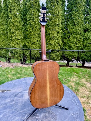

Thank you, Jarno. I've had that top wood for about 40 years. The board is big enough to make 8 or 9 guitars. It sounds good to my ears too. I'm happy it's like that after hanging on to it and hoping for so long.

Karl Wicklund wrote: Thu Apr 11, 2024 1:26 pm I also like that significant round-over on the binding. Beautiful work.
Thank you, Karl. That thick binding was more work but I really like the results. I will probably do that again on future builds.

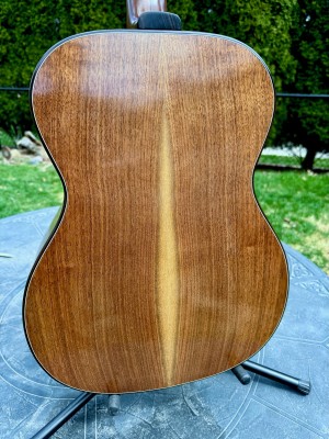

Great job! I really like Black Walnut for the back and sides for the dreadnoughts I have built. Affordable, locally sourced and attractive.
I like the way you "celebrated" the sap wood on the back. What did you use for a pore filler? I've been using an ebony powder mixed with thinned Titebond glue as a homemade paste filler.
Eric Knapp
Posts: 650
Location: Wisconsin, USA
Re: Guitar Number 3
Post by Eric Knapp »
Mike Conner wrote: Fri Apr 12, 2024 9:30 am Great job! I really like Black Walnut for the back and sides for the dreadnoughts I have built. Affordable, locally sourced and attractive.
Thanks, Mike!
The walnut in this guitar was indeed locally sourced. It came from a Wisconsin Black Walnut tree. I intend to use as much reclaimed and found wood as I can when making future guitars. I have enough walnut alone to make more guitars than I'm probably capable of.
Mike Conner wrote: Fri Apr 12, 2024 9:30 amI like the way you "celebrated" the sap wood on the back. What did you use for a pore filler? I've been using an ebony powder mixed with thinned Titebond glue as a homemade paste filler.
I used WEST System epoxy as a filler. I didn't completely fill all the pores, I like to see and feel the wood grain. That epoxy also has the right index of refraction and makes the wood glow beautifully.
