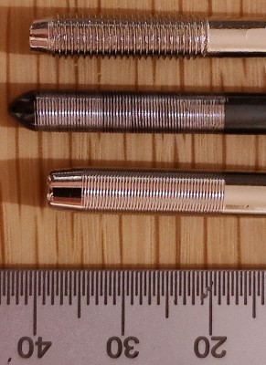

The first thing I've been wondering about are the zither pins. I'm in the UK, and have found places selling Gewa, Viking and "C. B. Gitty Crafter Supply" branded pins. Does anyone know whether any of these brands are particularly good or bad quality, or should I just get whichever is most convenient?
The other thing is that I've seen a couple of kit building guides tell you to hammer the pins part of the way in. Is this really recommended? I would have thought that screwing them all the way would be better?
