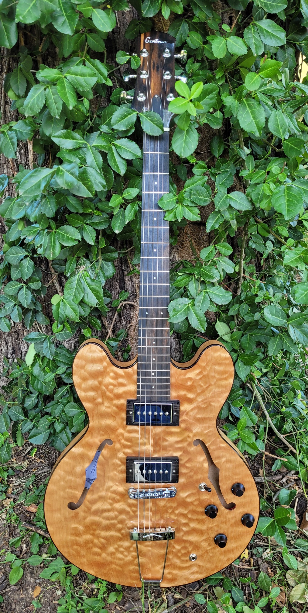

Thanks guys for the responses. I've decided on quilted big leaf maple. This is a Casino I made recently using quilted maple.
