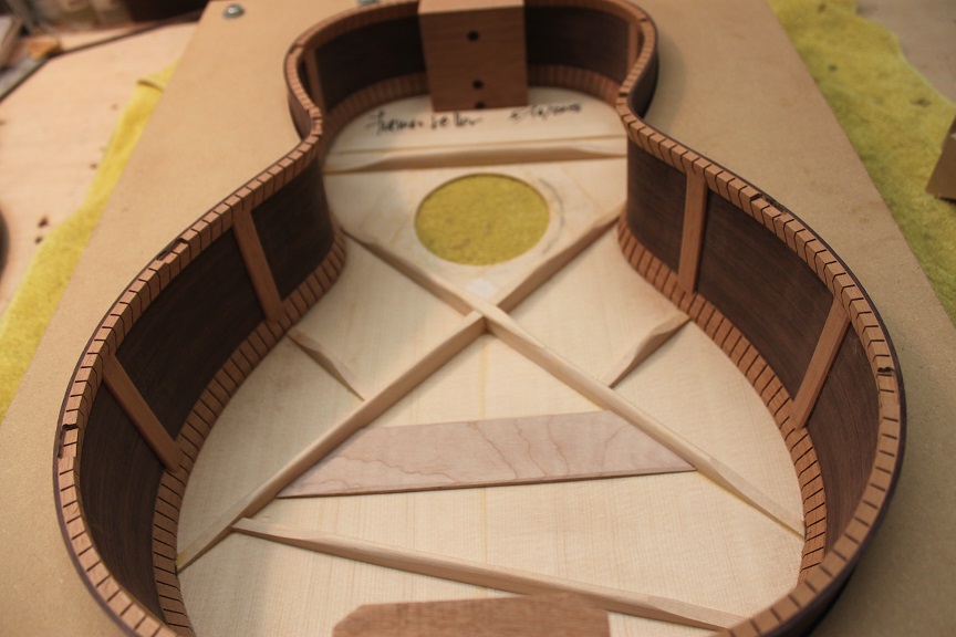

Falcate bracing takes a lot of extra work. If you want a really simple guitar, build one without any binding. I made an all mahogany guitar body sans binding and was able to knock it out in a couple of weeks. And that is fast for me. Another short cut would be to use store bought kerfing. Also, a butt joint, bolt on neck would help.

Keep it light. A smaller top can be stiff enough with less thickness, and the bracing can be both narrower (I'd use 1/4") and lower. You may find that you only want one tone bar, and one finger brace on each side should be fine. I'd make the sides thinner, too: say about 1.7mm (~.067"), which will facilitate bending a tight waist and still be stiff enough. Other than that; KISS.

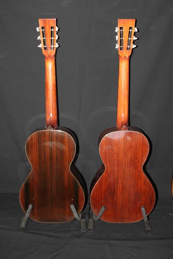

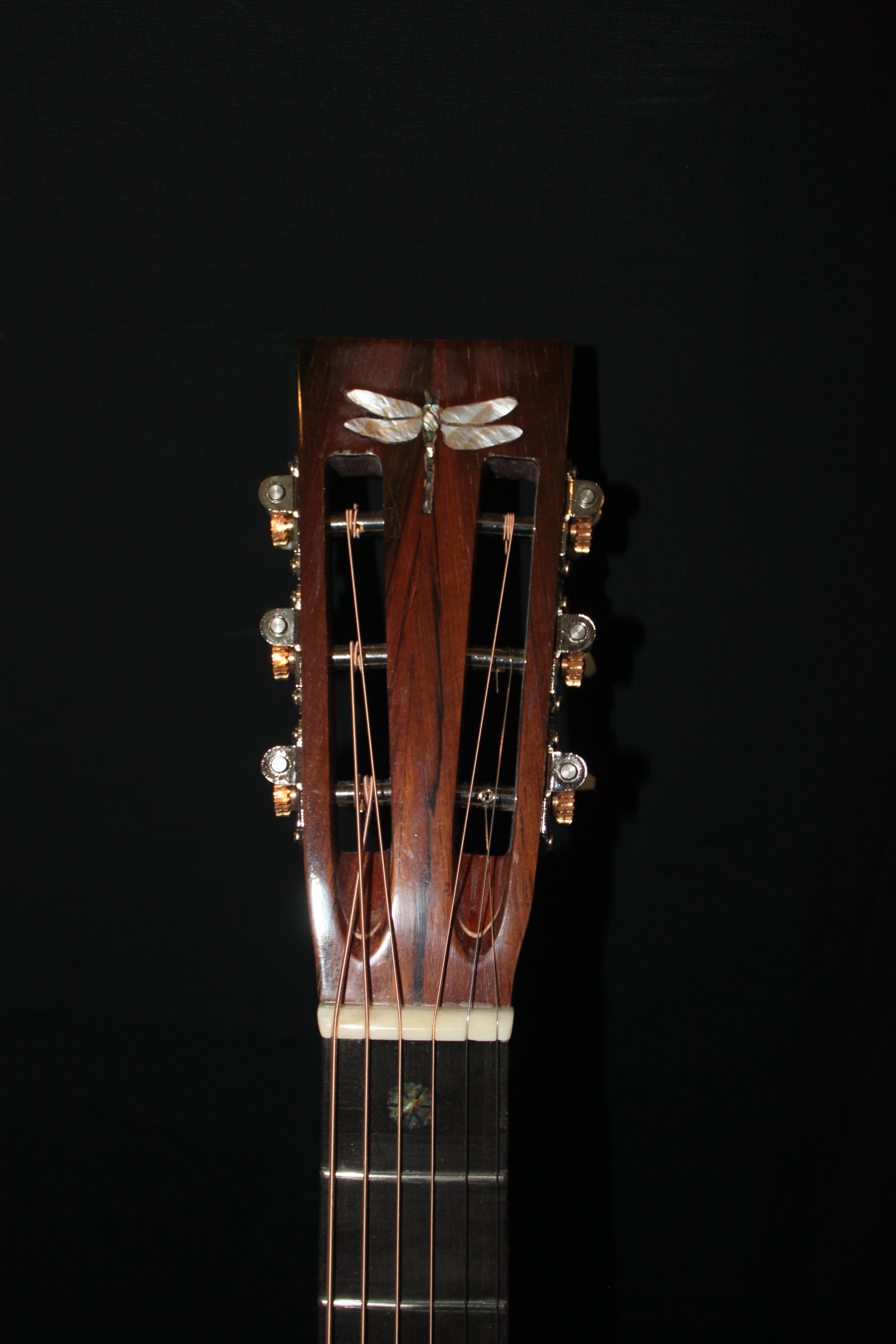

- Posts: 506
Re: Building some size O guitars-- tips? trying to fasttrack it (having a baby)
Thank you. My daughter's spirit animal is the blue darner dragonfly so that became the headstock inlayMatthew Lau wrote: ↑Thu Apr 20, 2023 1:46 pm Hey Freeman,
Those are gorgeous! Any tips for working with MOP/Paua inlay?
Andy DePaule cut the pearl for me, I routed the cavity with a dremel router. I buy the precut pau abalone from Andy or StewMac. When I glue the binding and all the purfling lines I put a piece of teflon where the pearl will go. I also have become a convert to tabling the binding in place without any glue, then "tack welding" it with drops of water thin CA. Pull the tape and run a bead of thin CA all the way around. Pull the teflon and install the pearl, flood that with CA and bingo, Style 42 inlay.
