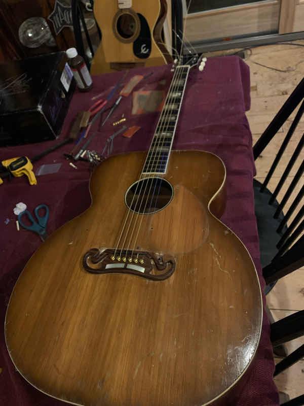

The guitar in question is an old late 50s silvertone 620, which is a cheap copy of a j200. It has a solid spruce top, but laminate sides and back. Replacing the back would also allow me to replace the existing ladder bracing with x-bracing under the top. 2 birds with 1 stone kind of thing. The guitar doesn’t sound bad as is, and looks REALLY cool with its age and mojo. I just wonder if, sonically, I’d have a better sounding guitar if I proceeded. The sides and back appear to be mahogany/maple/mahogany.

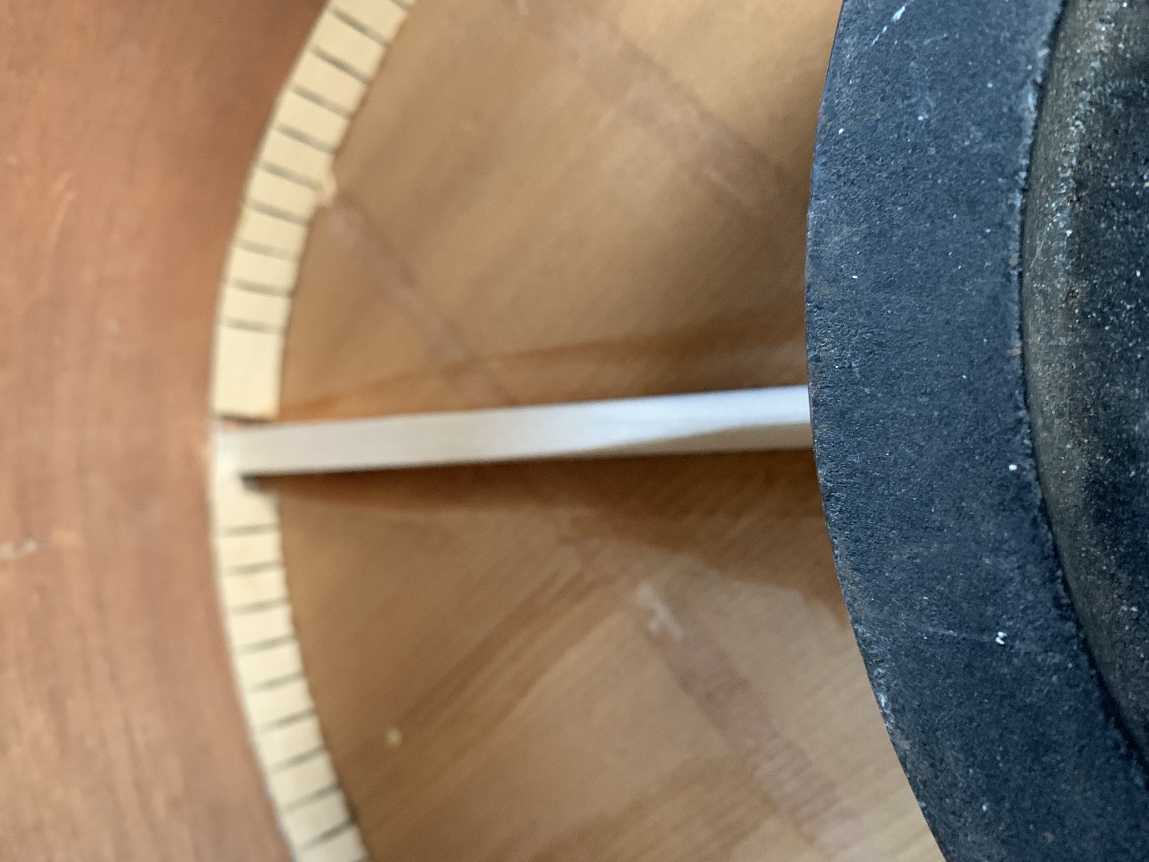

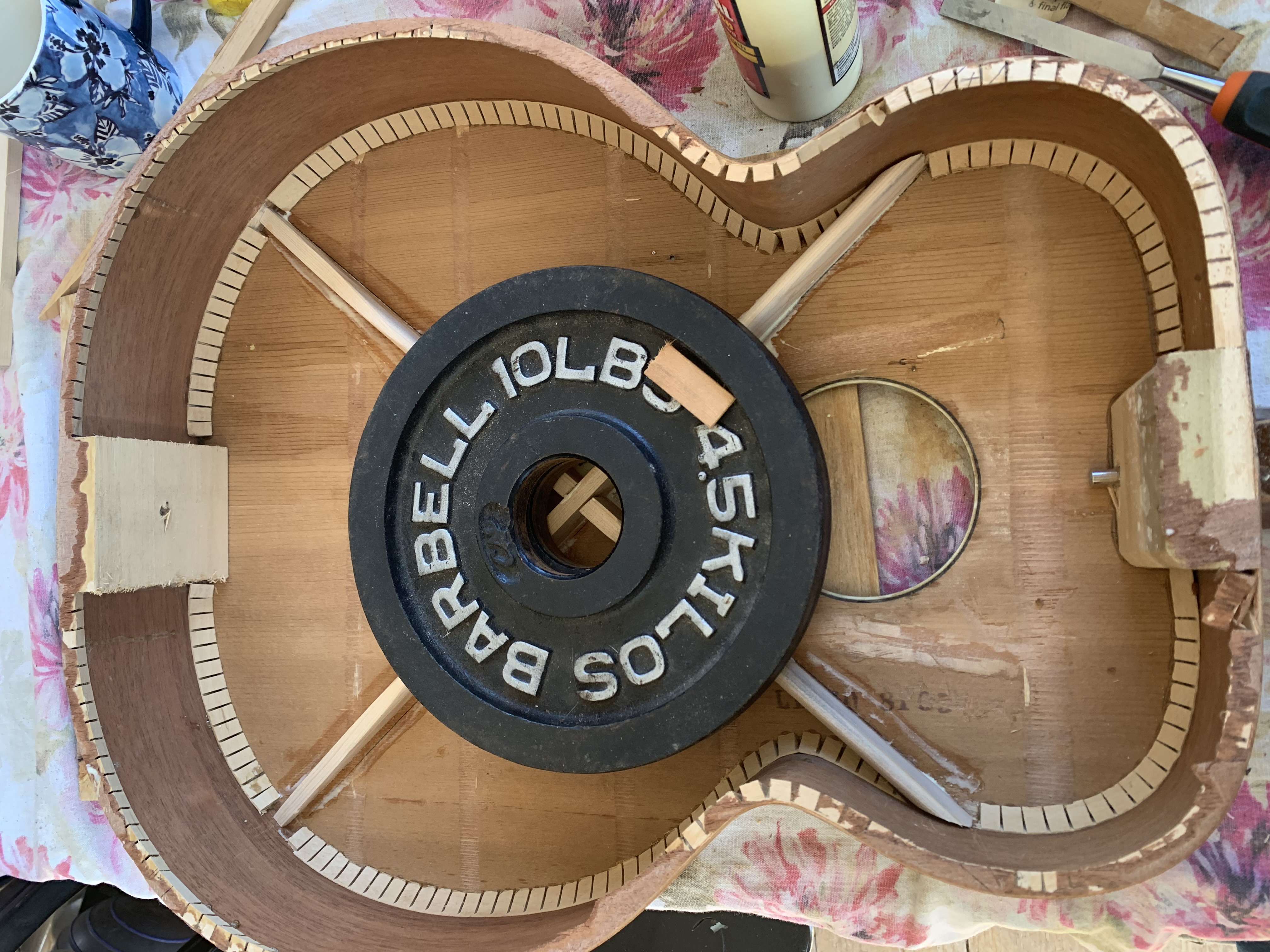

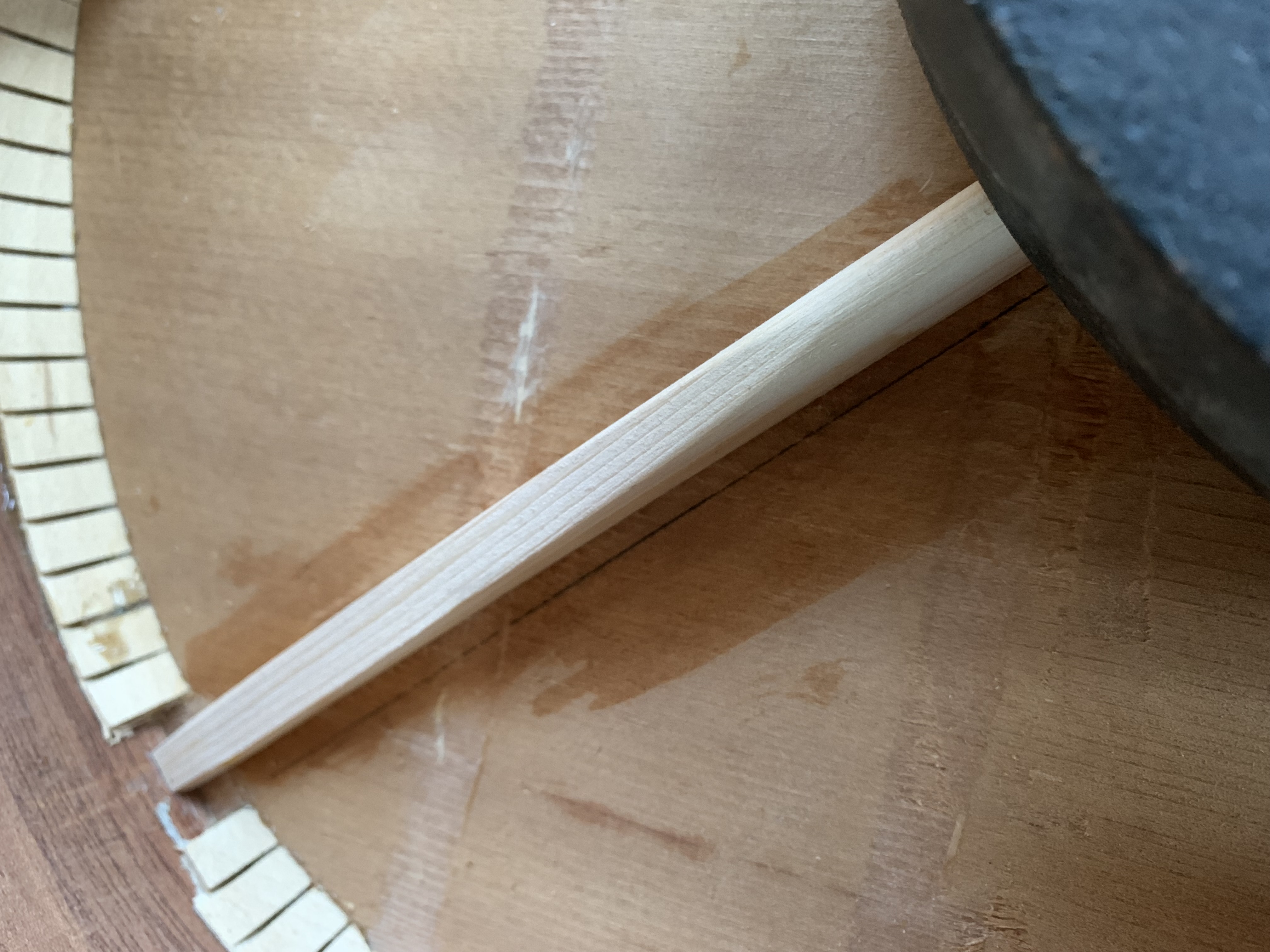

Thank you, Alan. I’m not there quite yet- I’ve removed the ladder bracing from the soundboard and cleaned it up and installed the main “X” 0f the new x bracing. They are tall, pyramid shaped, rounded tops. Had to lift the soundboard upper bout to meet the braces with the bottom of the soundboard, but it is done. The rest of the bracing (on the top) is what I’m wondering about. Here’s a picture-

It wasn't clear that you were talking about the top bracing.
Did you arch the top bracing? That's often a flatter arch, about 25' radius. It can be made flat, but many of us believe that arching the braces helps reduce cracking problems down the road. Many makers make the upper transverse brace flat, which facilitates getting the neck set and bridge height right.
On my builds I start with the smaller braces on the top: the tone bars, finger braces, and 'A' braces on either side of the hole. These are glued full height, and trimmed down as needed to notch under the 'X' braces and the UTB. The ends of the 'A' braces inlet into the neck block.
A good rule of thumb is that any brace that won't be trimmed down to zero height at the end needs to be inlet under something. This generally is the case for all the brace ends between the bridge and the upper block, since bridge torque is pushing them down.
Many glues have fairly low peel resistance; once an end of a brace comes loose it's easy to work it up from there. If the brace is tall enough at the end to be stiffer in bending than the top (which would be much less than the thickness of the top at that point) downward pressure, or a knock on the top, can start the peeling.
Be sure to use some sort of patch on the open side at the crossing of the X braces. The X crossing is also under a down load from the bridge torque, and this tends to spread the lap joint open. The notch is a big stress riser, and it's not uncommon for the brace to start to split there. Tying the open end of the joint together can prevent this. I like to use a short (1" or so) piece of spruce from the top for this: the actual tension load on the patch is not large, and it doesn't need to be thick, but you need to have some glue surface. Flatten the top of the braces out if they've been rounded off to glue the wood patch down. Martin relied for years (and maybe still does) on a cloth patch, and these can work well. I believe the original ones were linen circles, such as were used in muzzle loading guns; a heavy cotton will do. Soak the patch in glue and work it on over the junction, making sure it conforms well out to the edges, and use paper towel to take up the excess glue. I've used this on guitars, such as Taylors, where the braces have been rounded over before they were glued to the top , producing gaps on both sides of the joint and leaving no flat spot to glue a wood patch.

- Posts: 3249
Re: Replace old ply back with solid wood?
I would replace the kerfing at the end of the braces to reinforce that area to prevent the delamination Alan described. A triangular piece of wood on the upper ends of the x-brace goes a long way in adding strength.
- Posts: 3249
For the bracing on the top you should add the normal braces of an X-brace pattern, including the upper transverse brace (UTB) and a couple of braces on either side of the sound hole.
A couple of finger braces from the lower legs of the X-braces to the edge of the guitar would also be appropriate. And I would also add one tone bar in the lower bout.
