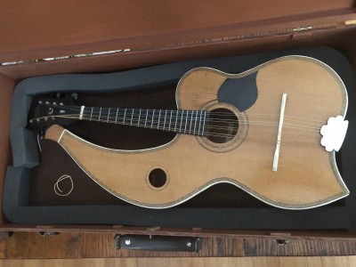

was recently asked to use this product on a historic Knutsen Mandolin with severe damage to the nut. Extremely deep string groves, the nut had been raised to allow more cutting and sections between the paired strings had broken off. Even though I suggested cutting a new nut, being a historical instrument, the owner insisted that I try filling it in and rebuilding the original nut with Nut Rescue powder. Simply put, it was not successful. I was unable to successfully pack the material into the tiny, deep sting slots and the glue would not absorb into the powder correctly to saturate it. I was able to break it out with my thumbnail. Ultimately, I told the owner (and he finally agreed) that the nut simply needed to be replaced. This is not the failure of the product per se, it simply was the wrong application of it.
I think, as others stated above, that this is a convenient way to make a temporary repair with many applications, but not the product to use for a significant re-building. I have not tried the dental material, but have heard good things about that for this type of an application.
