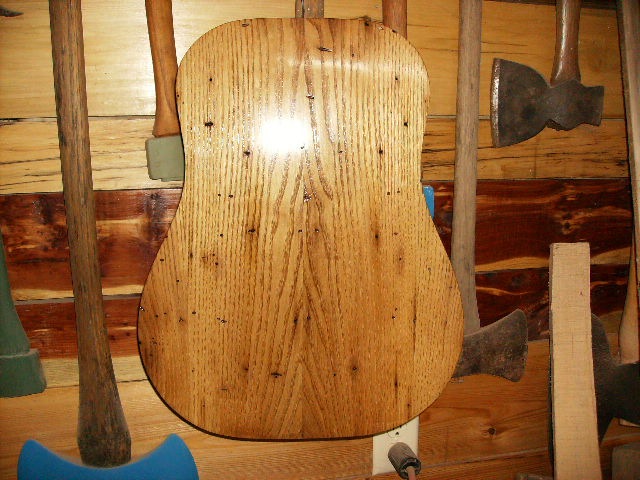

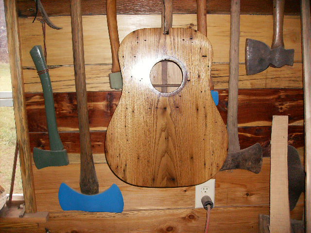

Thanks for the replies. Here are some pics of an all chestnut I have already started. I have some american chestnut that was saved from an old piano that does seem very soft. But the wood I used for this guitar I sawed from a log that had been buried at the edge of a creek for at least 90 years and is really pretty hard. It seemed to bend good to . I just had to try it for the top to just to see what it will sound like. I'm planning to build another one with a different soundboard wood just to compare the sound. Sorry for the bad photography.

I like it, and will be interested to see how it sounds. Probably not something that's going to grab the market by storm, but "just to see what it sounds like" is right in line with my own maker interests. I'm glad there's room for experimenters and dabblers and pros all here on the same forum.

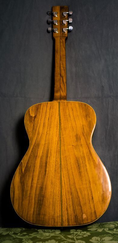

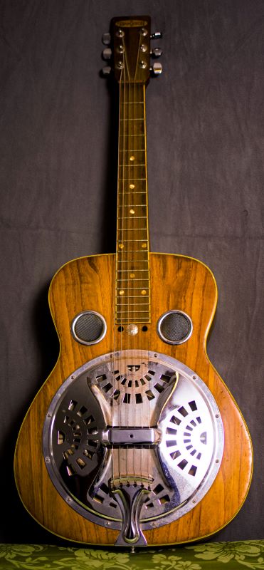

I have a chestnut Reso that my uncle built back in the late eighties, there is quite a story that goes with it, I was working with him when he built it and he told me that at that time the wood was 75 yrs old, so I am assuming that the chestnut was harvested around the time of the blight that wiped them out, anyway I know for sure he built 2 of them, takes to much time to tell the story, so in short, he must have sold or traded it shortly after building it so it eventually wound up in california then traveled back to tennessee, where a kind soul I met gave it back to me as gift back to the family this was around 2003 my uncle was killed in a tragic accident in 1998, it is a beautifull instrument with great volume, makes a great reso, im not sure if it would make a good regular six string, because great sound for a reso has more to do with set up, so I cant compare, I will try to post a couple of photos when I figure out how to resize them

Bob , my sycamore is still drying so I haven't planed any of it yet to really see what it will look like. JW ,thanks for posting pics of your guitar, glad you got it back . Your chestnut doesn't look anything like mine .Do you remember what finish your uncle used on it? Looks like it has held up well.

Nitro- I don’t know that he ever used anything else- yup! Glad to get it back! I still remember the day he got killed, he was standing in front of his shop and a fella fell asleep at the wheel and ran off the road and hit him, he was killed instantly, he had recently had a prostrate operation and couldn’t move out of the way fast enough, he was 72 yrs old- a lot of his mandolins and guitars are still around mostly in sc and Georgia
