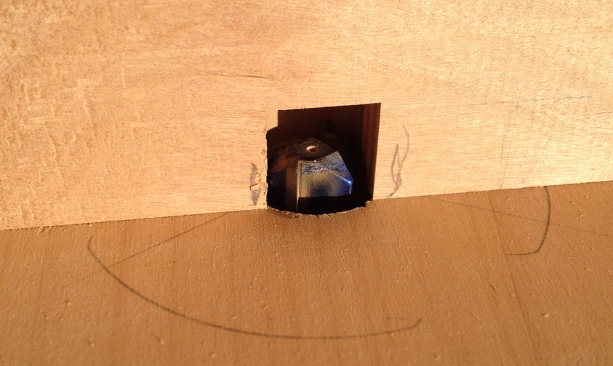

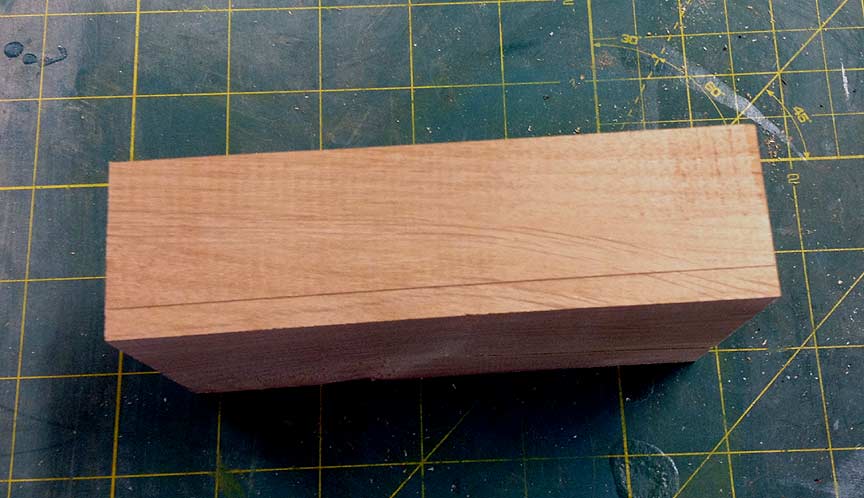

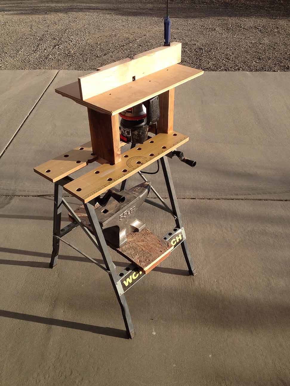

Thanks Ryan - that's a good alternative. I took Bob's suggestion to heart and made a very simple routing table using a generic workmate stand. The fence pivots on a screw and clamps on the other end.
This test piece has a 1/4" wide by 0.012" depth like I will do on the fretboard, but that again will be awhile until I get the headstock done.
