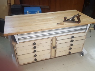

I'm very late to this party, but here's one that works for me.
I built a bench using a variable height mechanic's table that adjusts from 26 to 42 inches. The tool chest has drawers that are accessible from both sides, with drawer slides made from HDPE cutting boards. The slides are beveled like French cleats, and they keep the drawers perfectly aligned in the carcass and also allow opening drawers from both sides. The vertical center drawer has magnetic sheet material to hold rulers and scrapers.

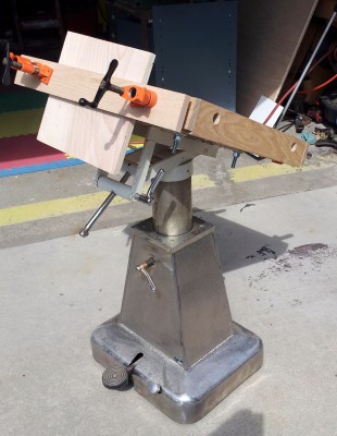

This is more of a sculptor's stand. It's made from the base of a veterinary operating table. It tilts to 85 degrees and rotates 360 degrees, as well as travels vertically on a long-ram hydraulic jack. Currently, the top is 24x24, but I may change it soon.

Hey Bob,
That is beautiful!
FWIW, I'm up to me ears with dealing with this COVID stuff at my dental office. With the Gamma variant, we may have another shutdown...and my associate is getting his own office. He gave his 2 weeks notice on Sunday after church.
That is beautiful!
