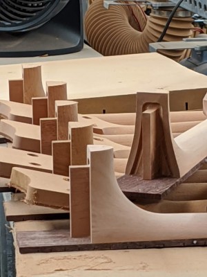

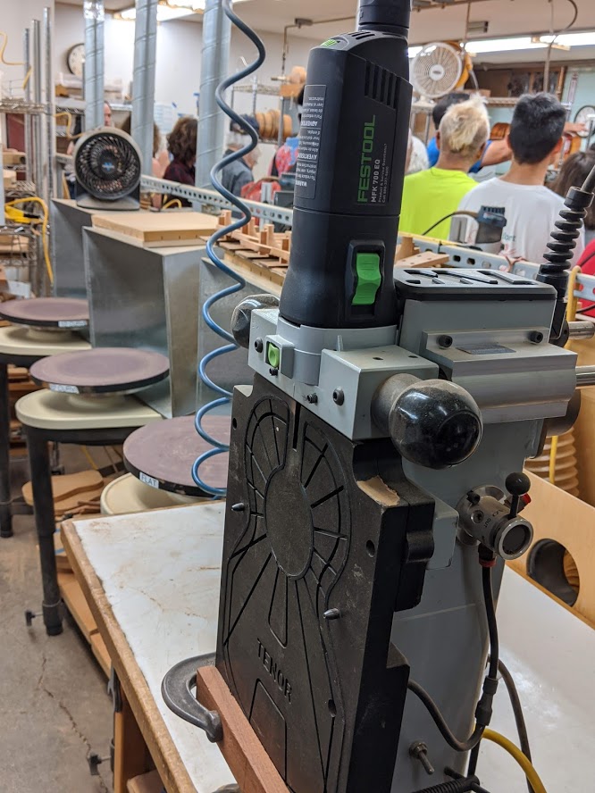

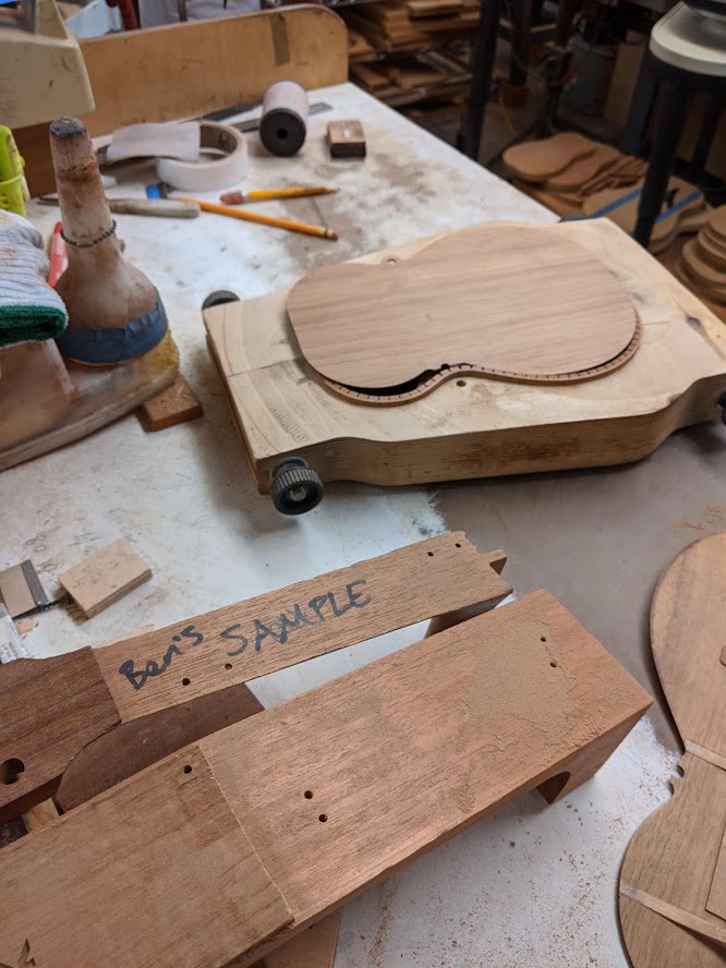

Starting with Kamaka- classical bracing. Classical molds. Festool and industrial machinery. Mortise/tenon neck.

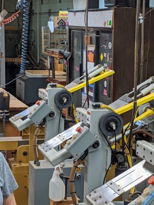

Of particular note, they use a heavily automated side bender like the Taylor factory

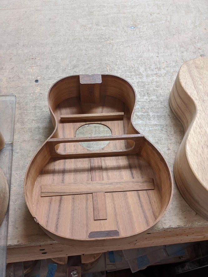

Note: this is for a Tenor body.
Bracing? There is none aside from the bridge plate.
Center-seam reinforcement to avoid delamination of face (costly repairs)

Note that the bracing just under the soundhole is a square.
This is their "magic brace" which frankly cuts down on assembly dramatically.
They make these in huge batches, and glue in about 2 minutes to top/sides.
I like the idea a lot, and will likely do a version of that (but with mortise and tenon.)

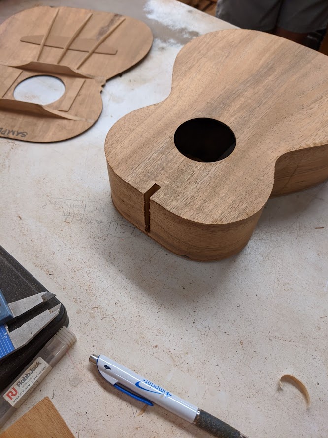

Also, there are NO LINERS. No kerfing

Note: the neck is just a but joint.
In contrast to Kamaka's mortise and tenon, they just use giant disk sanders.
They glue a but joint to the neck...not sure if it's epoxy or titebond.

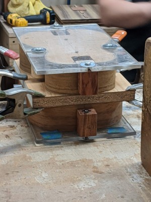

Lastly, there's the jig itself.
It's a scrap of particleboard, some threaded rod, and plexiglass.
Sometimes they'll use a heavy weight (like a jug of glue) to clamp things together.
Also note there's no taper/arching to the body.---why? to save money and labor!
