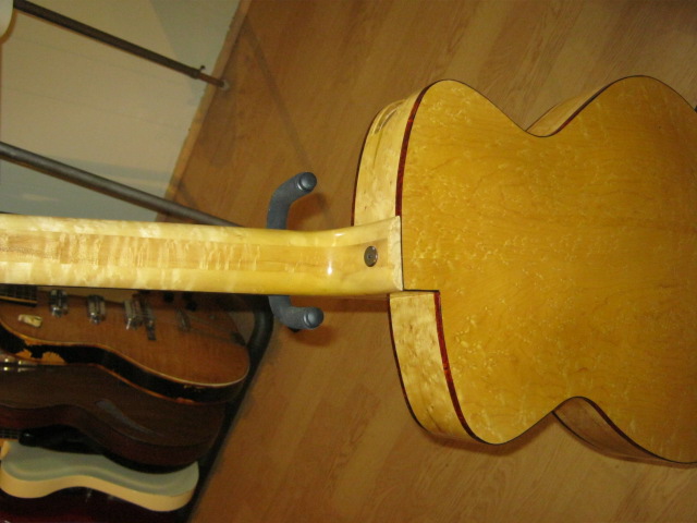

My take is that the wood in that log is perfectly fine. You don't need quarter-sawn maple to built out of, you could rough it with a chain saw, if you could get pieces that are 8" - 10" wide you could make a traditional archtop back and sides set out of it. I've built with maple from trees that fell down, I've built from birds-eye maple that was harvested 50 years ago and simply rough slabbed and left in a barn. In fact, if you squint, it kind of looks like a hollow body Jazzmaster (no F-holes though)...

Hi Andy,Andy Bounsall wrote: ↑Wed Aug 05, 2020 8:50 pmOK, here’s part of it...
I was thinking a carved archtop jazz guitar, but shaped more like a hollow body jazzmaster (with f holes). I want a loud 8 string ( "D" and "G" doubled) acoustic guitar that also is electric
So far it doesn't sound too wacky - I've build a number of 8 string acoustics with the "D" and "G" strings doubled and they have turned out well. A hollowbody thinline jazzmaster might make an interesting project. I'm not sure I would want to attempt it with that particular piece of wood without giving it a close examination. A good evaluation of the client's expectations would also be in order.
