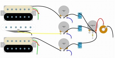

Hi there, I'm building my first guitar and have decided to go with a humbucker/single/humbucker layout for my pickups. I've also got on/off slide switches for each pickup as well as individual volume and tone knobs. I think I've laid out the wiring correctly but I'm not entirely sure and would be very grateful if someone who actually knows what they're doing could have a quick look. I've attached a picture of my wiring layout.

I'm no good a this stuff, but it looks like all the tone controls are going to interact, even with the unused pickups switched off. All the outputs from the volume pots are connected together, so there is a signal path back through the volume pots to the all tone caps to ground - worse if the volume pots are at max. You could put the switches from each volume pot to the output jack to avoid this when the unused pickups are off, but I don't know what hooking all the volumes together will do to the signal when they're all on.

Does the signal go back along the unused volume and tone knobs? As far as I am aware, I thought it'd take the path of least resistance to the jack. However, what you said about the connected volume knobs does make sense. I haven't been able to find a schematic for a three volume knob design, but I'm pretty sure I've seen it done.

The jack doesn't have a low resistance. Guitar amplifiers generally have a high input impedance (think resistance), so if that is in the range of or higher than the 250k pots, more of the signal for the higher frequencies that are shunted to ground via the tone controls will pass back through the unused volume pots to their tone controls and to ground, especially when the volume pots are at maximum, which is when they have a zero resistance to the signal.
Assuming you want to be able to switch in or out one, two or three pickups, I think you could have each pickup go to the separate volume pots, then to switches on each output, then all to the jack. You could add a single master tone pot at the jack.

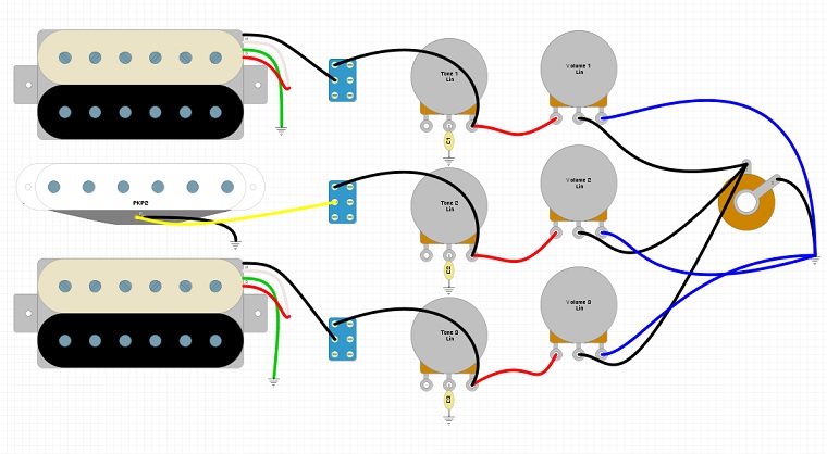

Ah right, ok. I've done a quick redesign and I think it avoids having the signal going to ground through the volume pots. I've attached another picture.
- Posts: 1323
Re: Need help with unusual wiring
Yes Will, that's how I was thinking. Maybe someone else will have a better idea.

The way you have it wired, the volume controls will interact when you have more than one pick up on. Think of typical Gibson wiring. If you connect the pick ups to the center lug of the volume pots and the other lug to the switch, you'll be able to blend multiple pick ups a bit better. Think of a Jazz Bass.
Your 3 tone control version would just keep dumping highs from the "accumulated" signal. In other words, the tone control doesn't attenuate highs from an individual pick up (unless that's the only pick up on), it attenuates highs from whatever signal going to the amplifier.
My preference with this kind of set up is 3 switches going to a master volume and tone. If you wanted to get fancy, use on/off/on switches with the other "on" being out of phase. Kind of redundant but very easy to use.

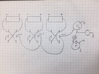

There will be no snickering about my diagram. I've had the graph paper since grade school (a while ago).
The wiring is 3 on/off/on-reverse phase with the outputs tied to a master volume and tone. The volume/tone circuit here is the "50s Gibson" wiring. I used it for no particular reason. Some people say it makes a difference.
Some comments:
You don't need to cross the "X" connections in the switch. It's neater, more professional and more of a hassle. you can wrap one arm of the cross around the body of the switch.
When I put this in a Strat type I use the screwholes from the pick up selector and add one in between. A ground plate under the switches gives a convenient place to tie the switch grounds which I then tie to the output jack.
I suggest reading the diagram and following the signal path of a pick up from ground to the output jack. This is how I learned what does what.
To point out the obvious, pickups added by the switches down will sound the same as the same pickups added with the switches up. I could be clearer, but what can I say?
Some comments:
