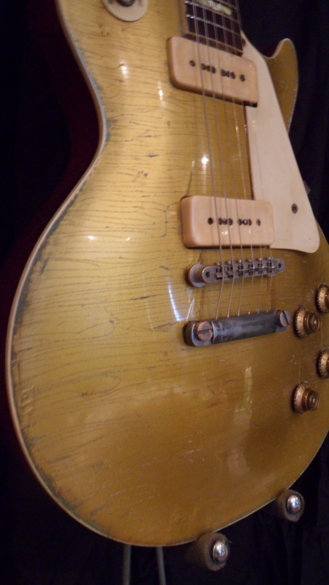

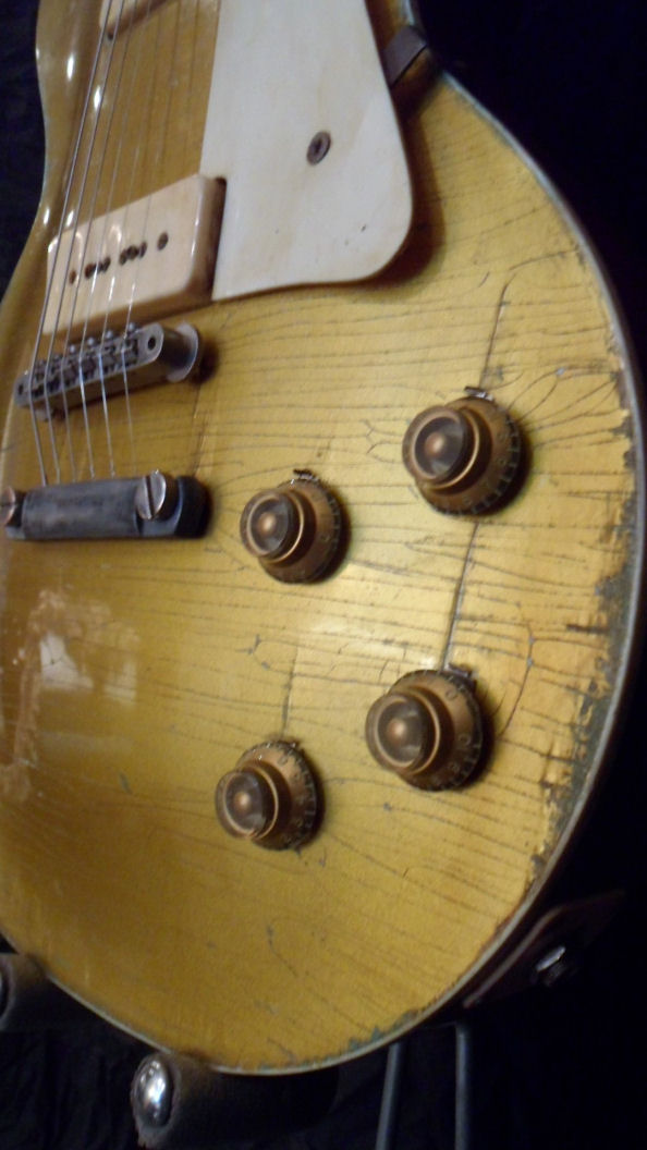

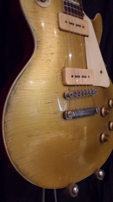

I feel your pain!...I do a lot of relic guitar finishes and it's always quite "hit and miss", some go really well and others just don't behave. I don't know what the Stewmac lacquer is but I always use nitro cellulose and a make that is low in plasticisers. I don't like using the pipe freeze/spray cooling as it is to violent and tends to produce a pattern that's more like the craze cracks on old pottery. Like you I put the guitar in a freezer then warm it gently afterwards although the paint finish has to be at least 3 months old, nowadays I use a number of techniques from scribing the checking lines and freezing and some other techniques..Here's a picture of a goldtop I did the other day that I was really pleased with although it did take a long time to do but other people have said that they can't tell it from a genuine one so that was very pleasing.
