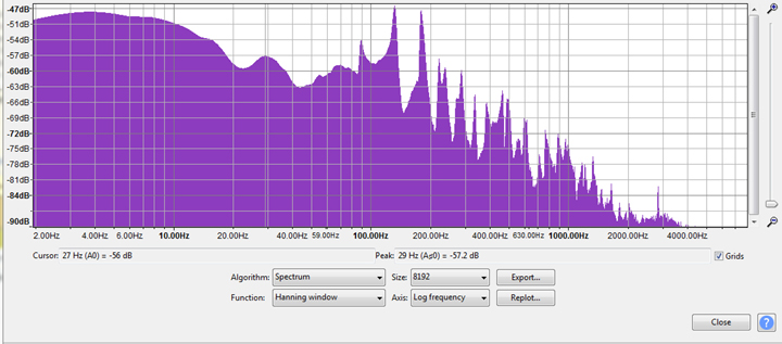

I posted this on another forum but this forum seems more relevant to the guitar I'm building. I need a little advice regarding tap tones. I’m building my first full scale archtop guitar with a carved top and back. I’m using Benedetto’s book on building archtops for help. Currently, I’m working on the top and have got to the stage where I am ¼” at the bridge, tapering to 1/8” at the recurve. I’ve cut the “f” holes but I haven’t yet installed the bracing. Tapping the top at the nodes, I’m hearing a deep ringing tone around 94Hz.
But I am wondering if this is too deep and I may have gone too far. I just made an Audacity recording and did an analysis of the taps, but I’m having a hard time figuring out what I’m looking at. I’m getting peaks at 89Hz, 132Hz, 179Hz, and 221Hz, 237Hz, 285Hz, 334Hz, 382Hz, as well as others in higher frequencies. The 94Hz that I’m hearing does not appear as a peak. My question is, am I still on the right track? Are there target frequencies I should be aiming at, at this stage or should I wait until I get the bracing on? I can't attach the Audacity file , but here is a screenshot of the frequency analysis.
BTW, the top is a very tight grained bookmatched Engleman spruce that I bought back in 1994

I assume that the top is not attached to the rims yet, correct?

No, the top is still not attached to the sides

I never worry about the pitch of the tone, but about the quality of the tone. I look for a clean drum sound, with sustain and ring to it. The pitches will rise a lot when you brace it, and when you complete the box. The tap tones and air resonance of the box is what matters most, and only then can you "tune" the final graduation of the top. Again, all I ever look for even at that point is a clear, clean drum sound and even vibration over the top and back.

I agree with Brian. Since every piece of wood is different, it doesn't make sense to try to force the top to produce a predetermined frequency spectrum. You're just trying to get that particular piece of wood to sound as good as it can. So how do you know when you're there? As Benedetto says, that knowledge can only come with lots of experience. I've built 9 acoustic archtop guitars and ukuleles, and I'm still feeling my way largely in the dark. The analytics are fun and interesting, but really not much help at this stage.

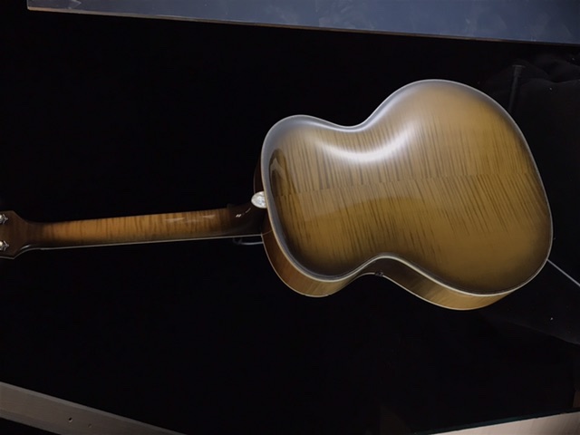

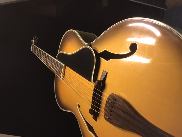

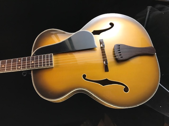

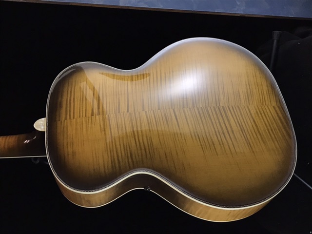

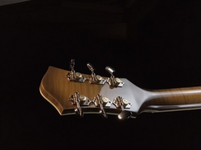

So, I thought I would post pictures of the completed guitar and thank everyone for their advice and knowledge. Thank you. I’m quite pleased with the way it plays. Mellow as far as archtops go but perhaps not as loud as I was hoping. Anyway, not bad for my first.
