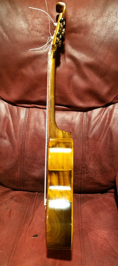

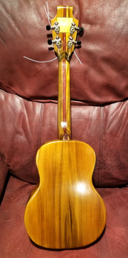

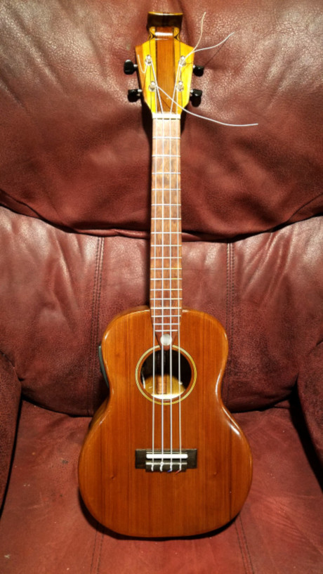

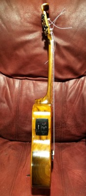

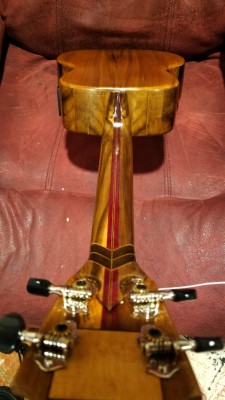

It's been a long time since I've posted anything here, but I'd like to share this ukulele I just finished for my good friends' daughter. It's a 17 inch scale Tenor ukulele with an old growth redwood top, poplar sides, back, and neck, and a bubinga fingerboard. The redwood was from an old I found buried in my backyard. The poplar was from a shelf I built. The rest was left over from other projects.

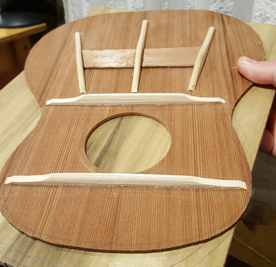

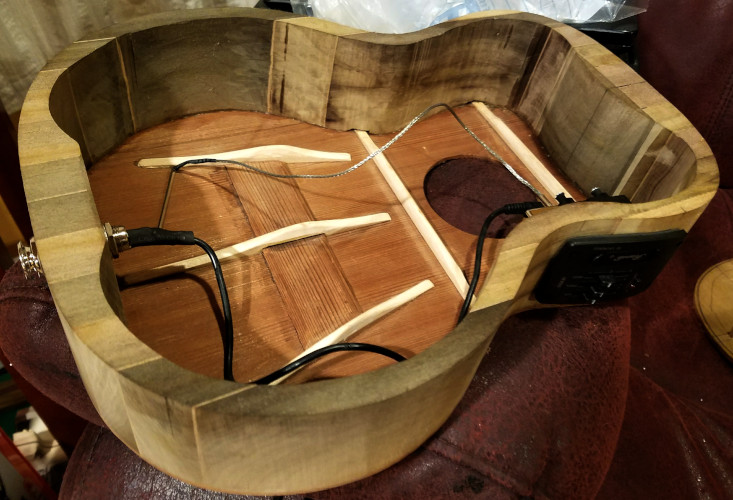

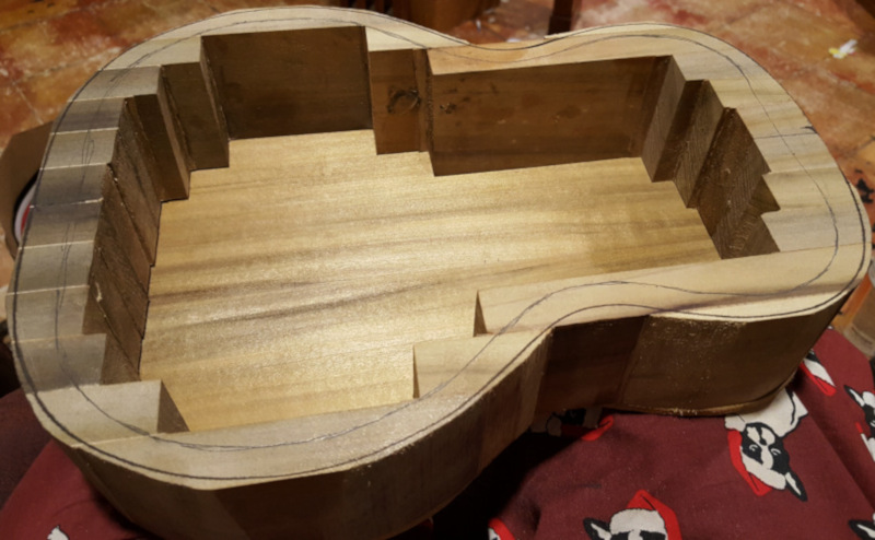

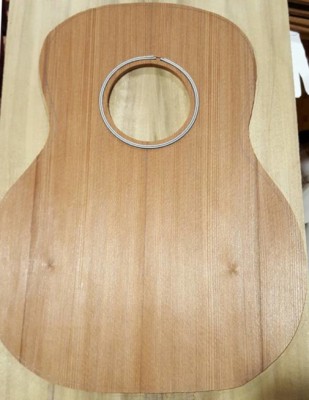

Here are some pictures of the construction

This is a construction method I was curious about trying, and the ukulele was kind of a proof of concept for an acoustic/electric baritone guitar I'm working on.

Why did you not build it with thin bent sides?

Barry Daniels wrote:Why did you not build it with thin bent sides?
Mostly just curiosity. That's about it. I have a bunch of short lengths of nice lumber that I want to find a use for. I wanted to know what an instrument built this way would sound like, and how heavy it would make it. I was kind of inspired by some old Renaissance guitars built in a similar fashion.

Karl Wicklund wrote:Curiosity is as good a reason as any and a better reason than many. How did it turn out, as far as sound and playability ?
It sounds great acoustically, and amplified, and it's a joy to play! I couldn't be happier with it. I need to the new owner if she can upload a video of it being played.

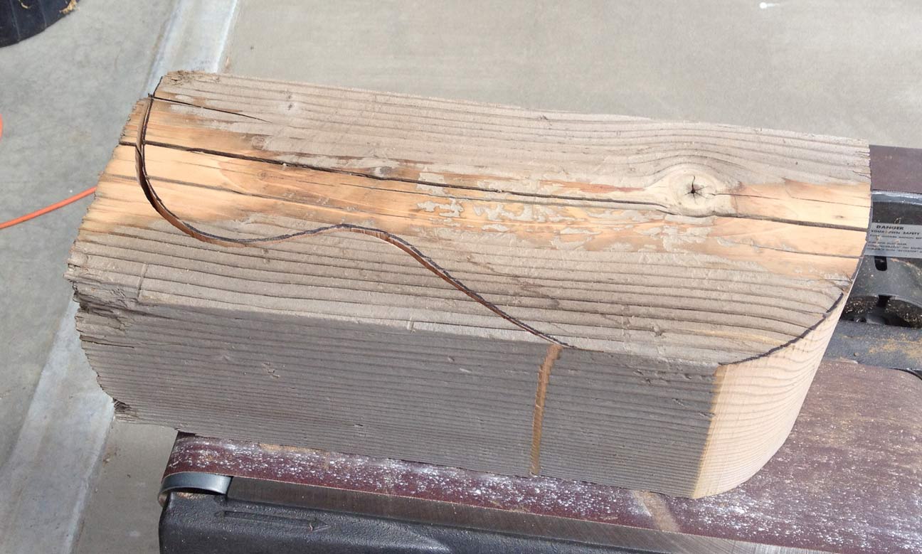

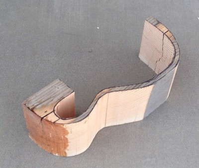

Nice looking instrument, Adam. I guess great minds think alike - I just started building an acoustic/electric round neck resophonic a couple of days ago using a similar construction method. However, instead of gluing up the side pieces I'm using a hunk of 8X8 doug fir that's been sitting outside for 10 or 15 years. Lots of checks and cracks to fill. It will be instructive even if a failure.

The nyckelharpa uses a similar construction technique (sawn sides). On some of the older ones I believe they would hollow out a baulk of timber for the back and sides as was done for the early Irish harps.
