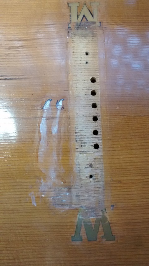

I've got an old Harmony 1203 and someone put some waterslide decals on the spruce top to cover up some damage where the bridge was once removed.
Does anyone know a good tip to remove them without damaging the wood ?

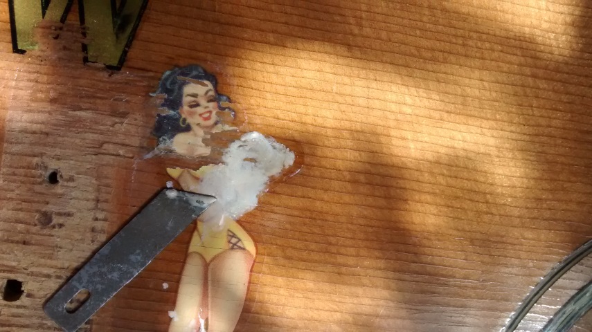

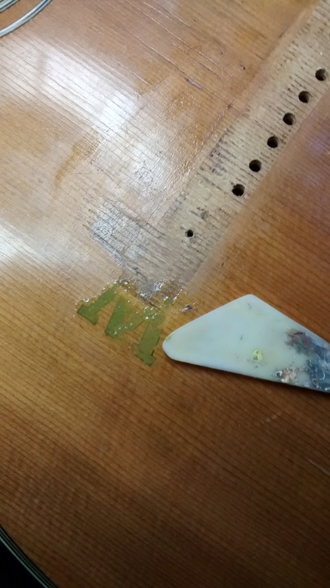

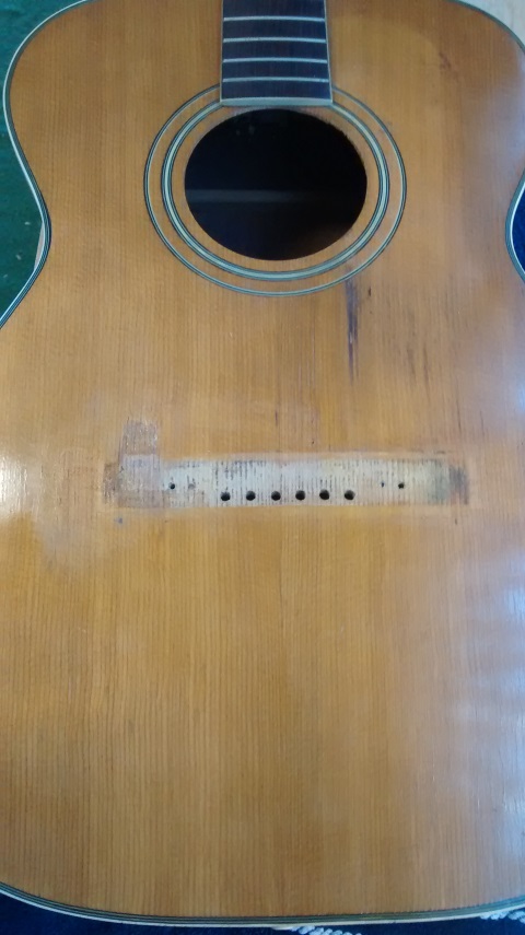

Re: Best Way to Remove Waterslide Decals - Update
The decals have been removed !
I used an amalgamator recommended by Frank Ford via a link posted by Barry Daniels (thanks)
http://www.frets.com/FretsPages/Luthier ... ator1.html
As expected the amalgamator will take off not only the decal but also the lacquer.
Well my other last alternative on these stubborn decals would be to sand them off so I went with the amalgamator
Pics detail my progress.
I found that waiting 10 or 15 minutes was sufficient and with a little coaxing from a razor and a plastic pallette knife they came off easy although they dissolved completely and didn't peel off in one piece. There is still some lacquer left so hopefully a little wet sanding will bring it to life I started off scraping it with a razor The wet goo wipes off with a paper towel. Being careful here and trying not to wipe off the lacquer under the decal A plastic pallette knife works better This pic shows bare wood where a previous luthier has removed the bridge. I'm sure this was the reason for the decals as they covered the damage that was done.
