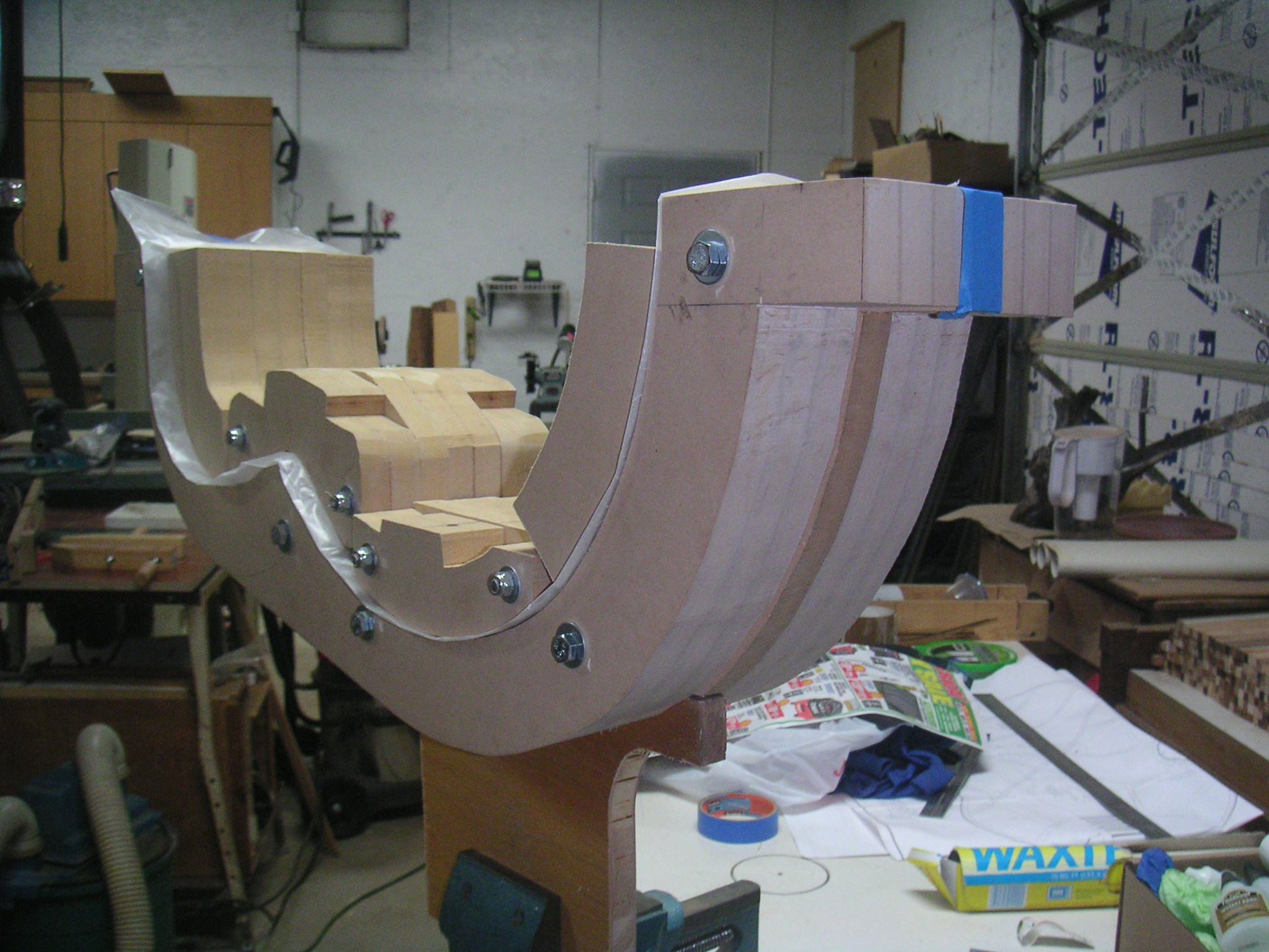

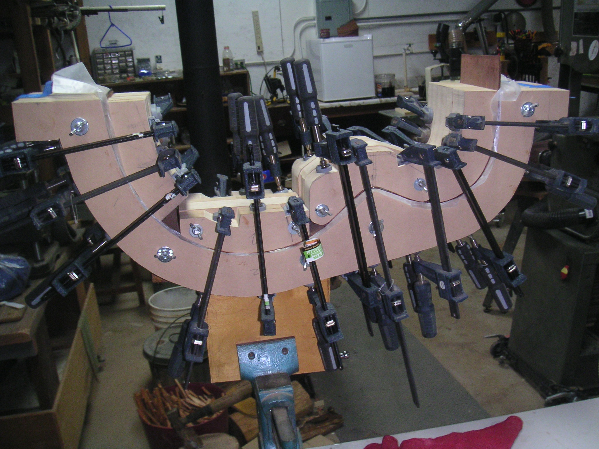

Here's what I put together... outside mold bolted together with a spacer and extension to go in the vise. Inside waist and lower bout spreaders bolted with spacers and other scraps glued to make the cauls, clamped with 25 HF clamps.
Carl
An addition for the next time I use it will be a sheet of scrap formica to even out the clamping pressure.Carl
