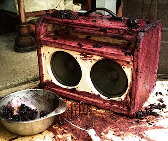

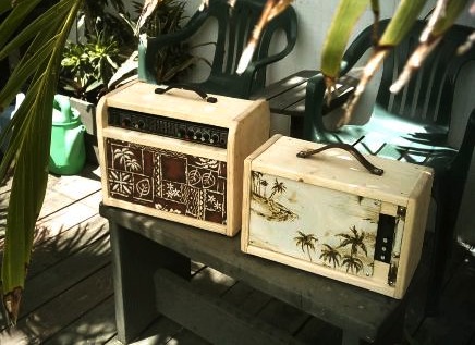

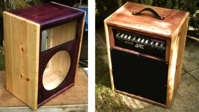

Some people have suggested that the alum does something to lock the colour in. I found some pics I took about 8 years ago or so when I had a crappy camera. It's of stuff I made cabinets for. All the stuff sounded way better than it started. It was inspired by a website by a guy named Charles Altmann in Germany. I had to try out his ideas and I can't tell you how much difference it makes to make speaker cabinets along the lines of violins. You wouldn't cover a violin in carpet and expect it to sound good.
The pics are of a JBL pa speaker I reboxed (the horn was made of wood), a GK small amp, a BOSS micro monitor and there's a before after fading pic of the Art amp I reboxed. All these things I reboxed were products that I could tell had decent electronics but the boxes were making them sound obnoxious. The JBL had a metal speaker grille that coloured everything and the plastic horn was horrible. The GK and Art amps both had metal boxes that sounded like what a guitar made out of a garbage can would sound. It was hard to believe that these products came from good companies.

- Attachments
- Here's the GK amp looking pretty grubby.
- GK AMP AFTER AWHILE.tiff (392.93 KiB) Viewed 7602 times
