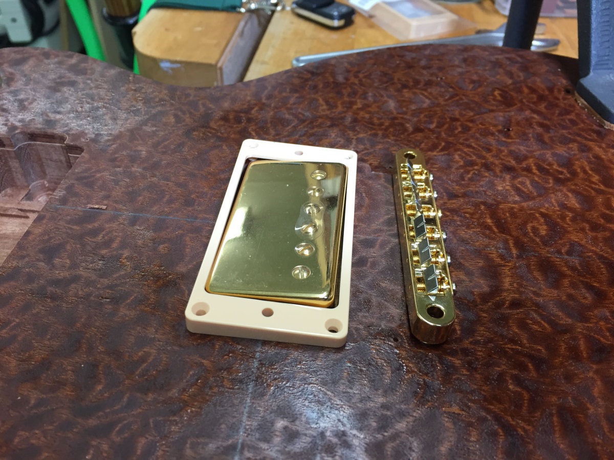

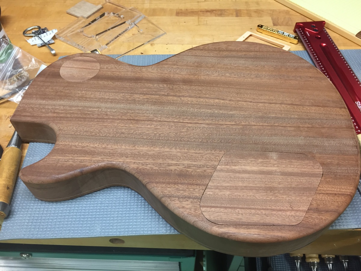

I had the body going pretty well. Made some nice wood control cavity covers and definitely at a point where I do NOT want to start over.

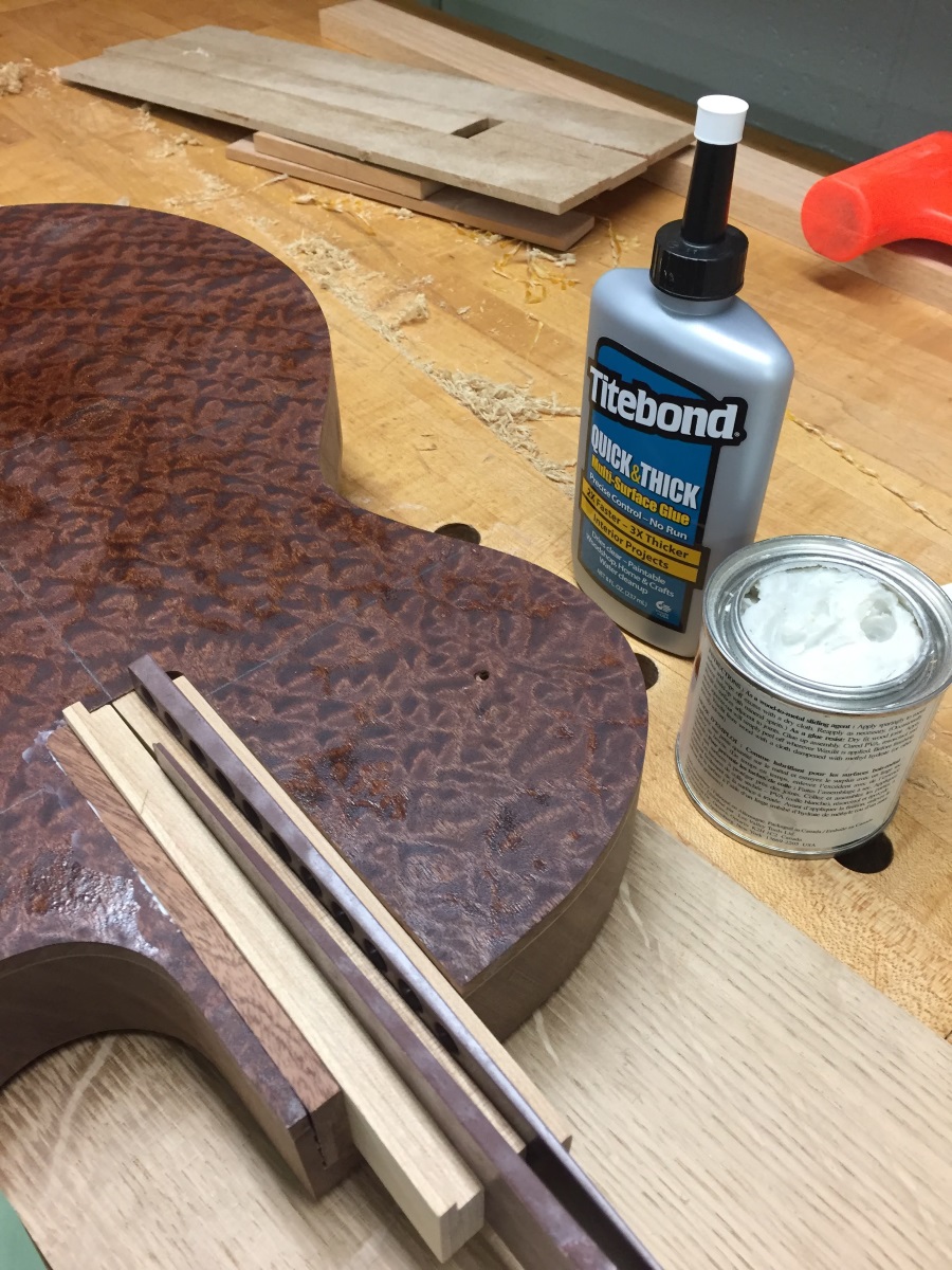

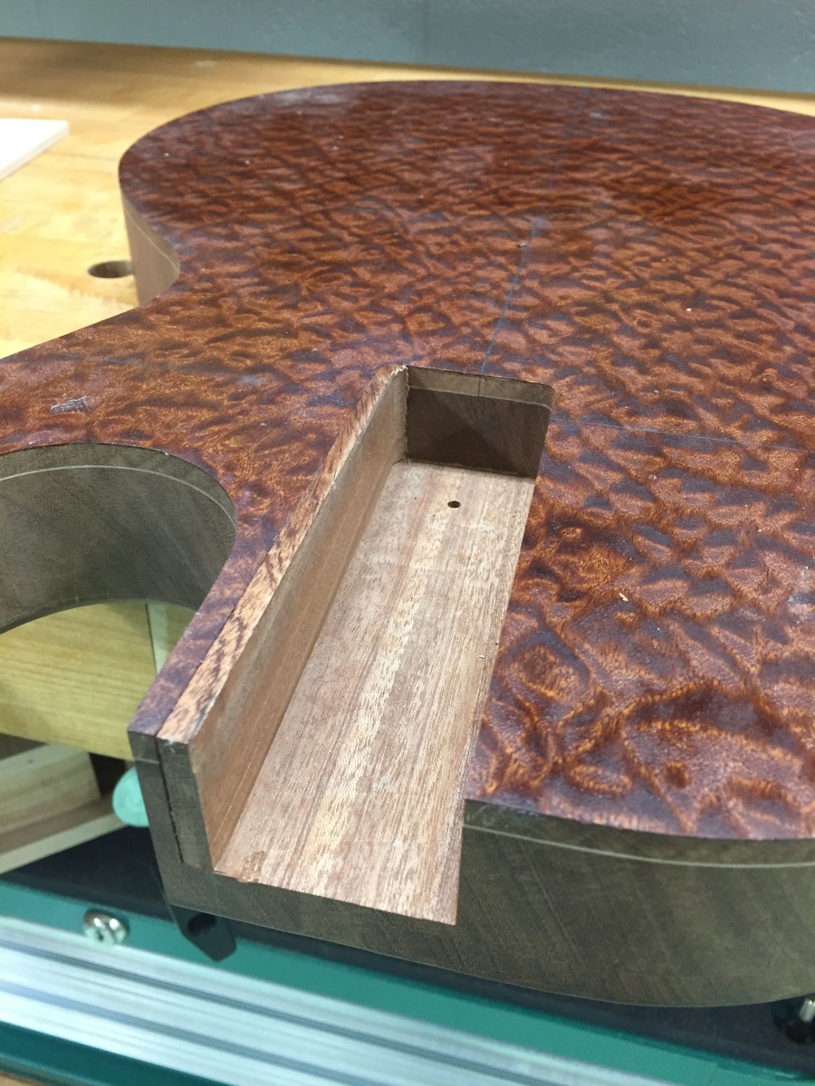

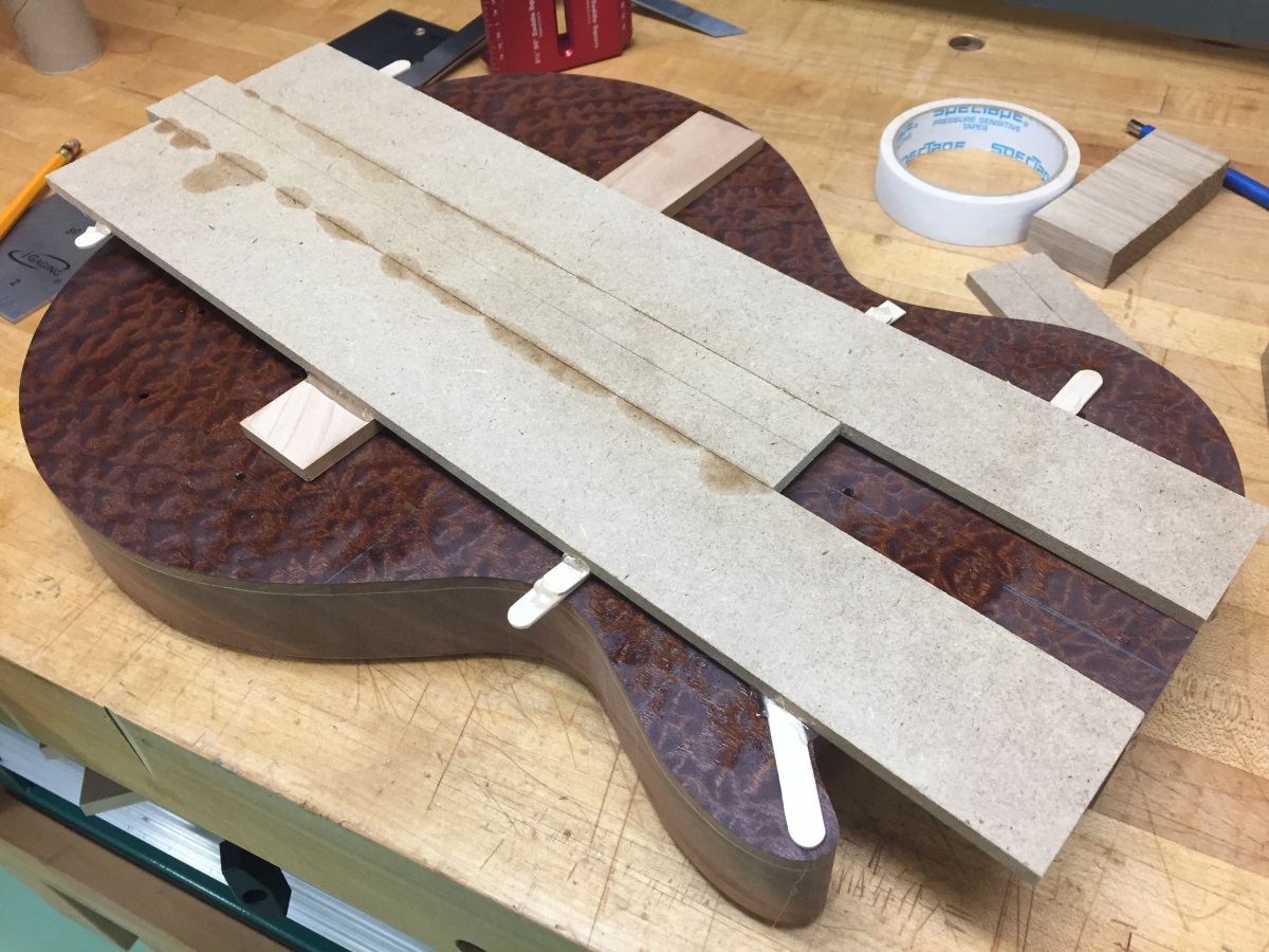

I marked the center line based on the glue line between the upper and lower halves of the body blank, and proceeded to jig things up to rout the neck pocket, with a 1 1/2* slope, aligned with the centerline.
Unfortunately, I should have double-checked the centerline against the "head" of the body. As you can see, the pocket was much too close to the cutaway. This wasn't too bad, I simply glued in a piece of scrap on one side of the neck mortise, re-drew the centerline correctly, and re-cut the mortise. The piece of scrap will be concealed by the fretboard, so it's all good.

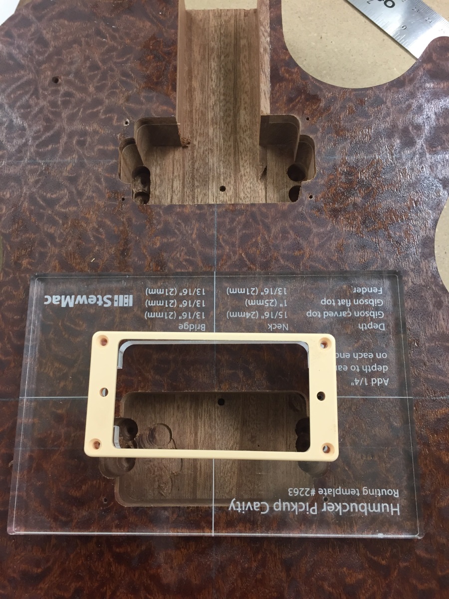

The next goof wasn't quite so easy. I'm really a measure-twice-cut-once kinda guy, but you can measure ten times and you're still going to be in trouble if the number you have in your head is the WRONG number!! :lol: :roll:
So, I ended up routing the bridge pup cavity 3/4" too far from the neck. No way could this remain like this, as it would have to displace the bridge location.

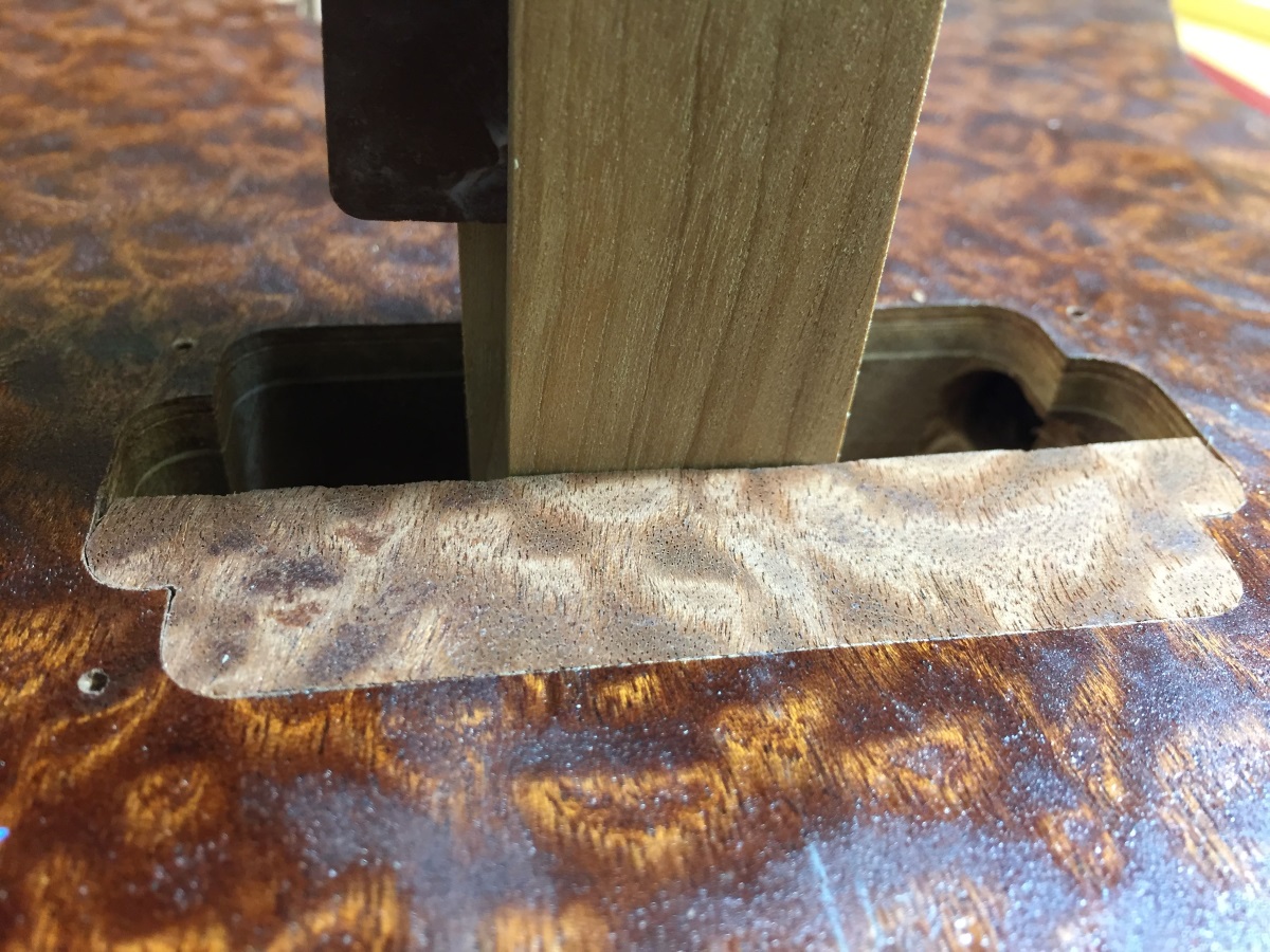

After I had myself a good laugh at this one, I decided that the veneer is "busy" enough that if I plug part of the mis-routed cavity, the veneer wouldn't have to perfectly match, especially since it would be under the strings, between the pickup ring and bridge, and part of the seam would actually be covered by the bridge.

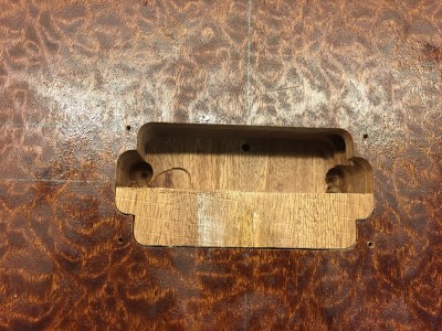

I carefully measured the depth of the cavity, and ran a piece of scrap through the planer until it was exactly 0.025" less than the depth of the cavity to allow for the veneer. I used the cavity routing template to mark out the plug on the scrap, and with some bandsawing, some filing with a mill-tooth file and some sanding, got a pretty good fit.
I glued some veneer onto the plug, and trimmed carefully so it fit as perfectly as I could get it, and glued the assembly into place, clamping with some wedges.
After applying a coat of epoxy, I wouldn't say it's like it never happened, but I'll settle for this.
