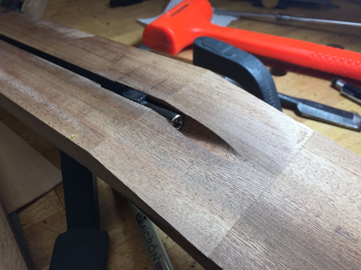

Well, to be fair, StewMac said that it "wasn't recommended", but it seems to work just fine.
I purchased one of the low-profile two-way truss rods from StewMac, plus the stupid-expensive tool for counter-boring the cylindrical nut housing. The instructions for the tool only showed it being used to place the nut at the heel of a bolt-on neck, and I was building a set-neck with an angled headstock.

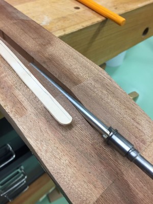

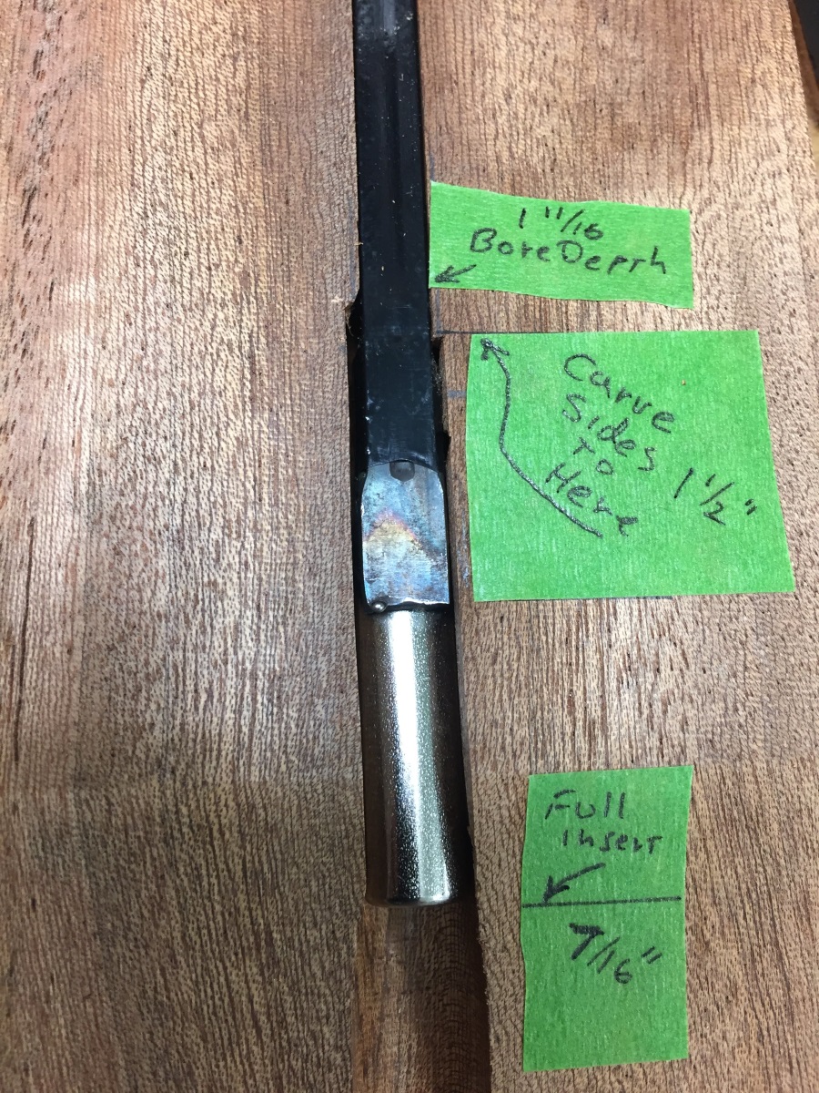

Because this is my first neck of this type, I used some mahogany scrap to practice making the scarf joint and to see if this tool could be used for this application. As you can see, it works just fine. The counterbore will even fit under the truss rod cover I bought. The second pic is to document how deep to bore for this rod when I go to make the "real" neck. All measurements are taken from the break angle between the headstock and the shaft of the neck. Note that I had to do a bit of carving to clear the top of the truss rod where it is welded, as it is slightly wider than the nominal 1/4" of the truss rod itself. Also, you don't really need the 1/4" bit that StewMac sells to install this rod, but I did have to try three different "1/4 inch" router bits until I found one that was actually 1/4". The rod measures just a scrunch short of 1/4" (.242" if I recall correctly) and the counterboring tool measures exactly 1/4" (.250"), so the router bit can NOT be undersized at all.
