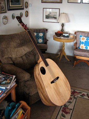

Not an archtop, but an acoustic bass I made a few years ago for a challenge here. I've played it strapped around my neck, but somewhat cumbersome. Better played like a cello, but needs an end pin, but I'm afraid the tail block may be too frail. Sound clip at the end of the thread, compared to an URB. Pretty good bass response: volume is somewhat less than an upright, adequate for a room but not outdoors.
http://www.mimf.com/phpbb/viewtopic.php?f=3&t=1830

Peter, that sounds pretty darn good! And I love the headstock carving!
Still, I don't think I'd want to play it like a guitar.

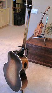

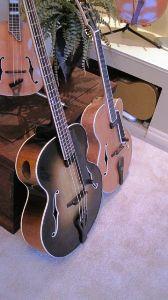

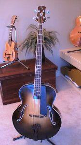

I built one a few years ago that I've posted previously based on the information and dimensions that Bill Moll so generously posted. It's a 20" lower bout and 4" ribs, 34" scale. It's about as large a guitar as you would want to play without standing it up. It definitely keeps up in an acoustic session. The friend I built it for also rocks it with a pick about half the time when playing acoustic when there are more than a couple of guitars. It also has a floating humbucker for versatility.
