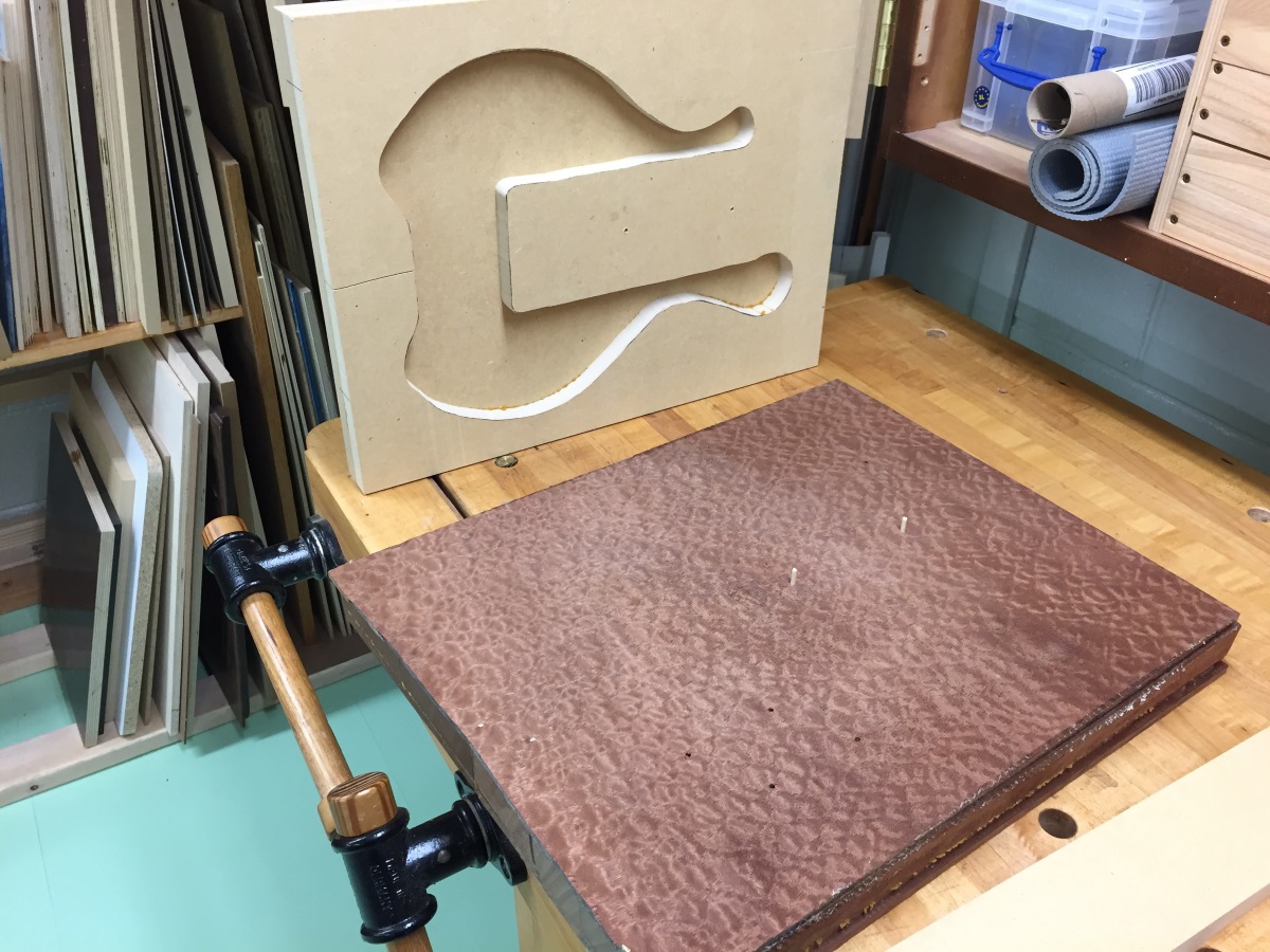

To "close the loop" on this topic, I wanted to pass along my experiences.
Bottom line for the impatient is that a vacuum press works GREAT for assembling a chambered and/or capped solid-body guitar.
For the technically inclined, I'm pulling about 22 inches Hg with my setup. This translates into a pressure of 10.805 lbs per square inch. For the 14" x 18" caul I had sitting atop the "sandwich", this comes out to 2,723 lbs! That's like having a very small car balanced on top of this glue-up!
The first experience was correcting a screw-up. My initial re-sawing left me with stock for a nice cap for the top, a nicely book-matched plate for the back, a thick slab in the center to bandsaw for the chambering. The only trouble was, the entire stack was coming up too thin. I had to joint, glue and re-attach the sections that were going to be the veneered top cap, and then thickness, joint and glue-up another plate to be veneered for the top cap.
More screw-ups ensued. I jointed the two center slabs before gluing using a glue-line rip blade in my table saw. Unfortunately the blade was just a bit off of 90* so the center slab ended up ever so slightly "V" shaped. Not obviously so, but a straight-edge revealed about a 3/32" hump on one face, and a corresponding 3/32" valley on the other. Because I wanted to ensure that the top cap was less than 1/4" thick after veneering the front and back, running the center section through the planer to get the two faces flat and parallel would have put me under the minimum 1 3/4" thickness I'd targeted.
Grrrrr.....
Also, when I jointed and glued up the plate that I wanted to re-attach to the center slab prior to band-sawing the chamber, I book-matched it. Don't ask me why, as it was going to end up being veneered, but as it turns out, when this got re-glued to the center section the grain matches very closely as the pieces ended up right back where they started before being re-sawed! Anyway, as so often happens with thin re-sawed stock, both pieces warped considerably so what I had was decidedly S-shaped.
So - I had a slightly V-shaped body blank and wanted to glue onto one face an S-shaped 1/4" thick plate...
I coated both pieces with Titebond, slipped the stack into the vacuum bag with a beefy 1" particleboard-and-melamine caul underneath and breather mesh on top and let the pump pull a good vacuum for about an hour. The pressure in the vacuum bag flattened everything beautifully. The result still had a tiny bit of a V-shape, but was down to less than .040", so about half what I'd started with.

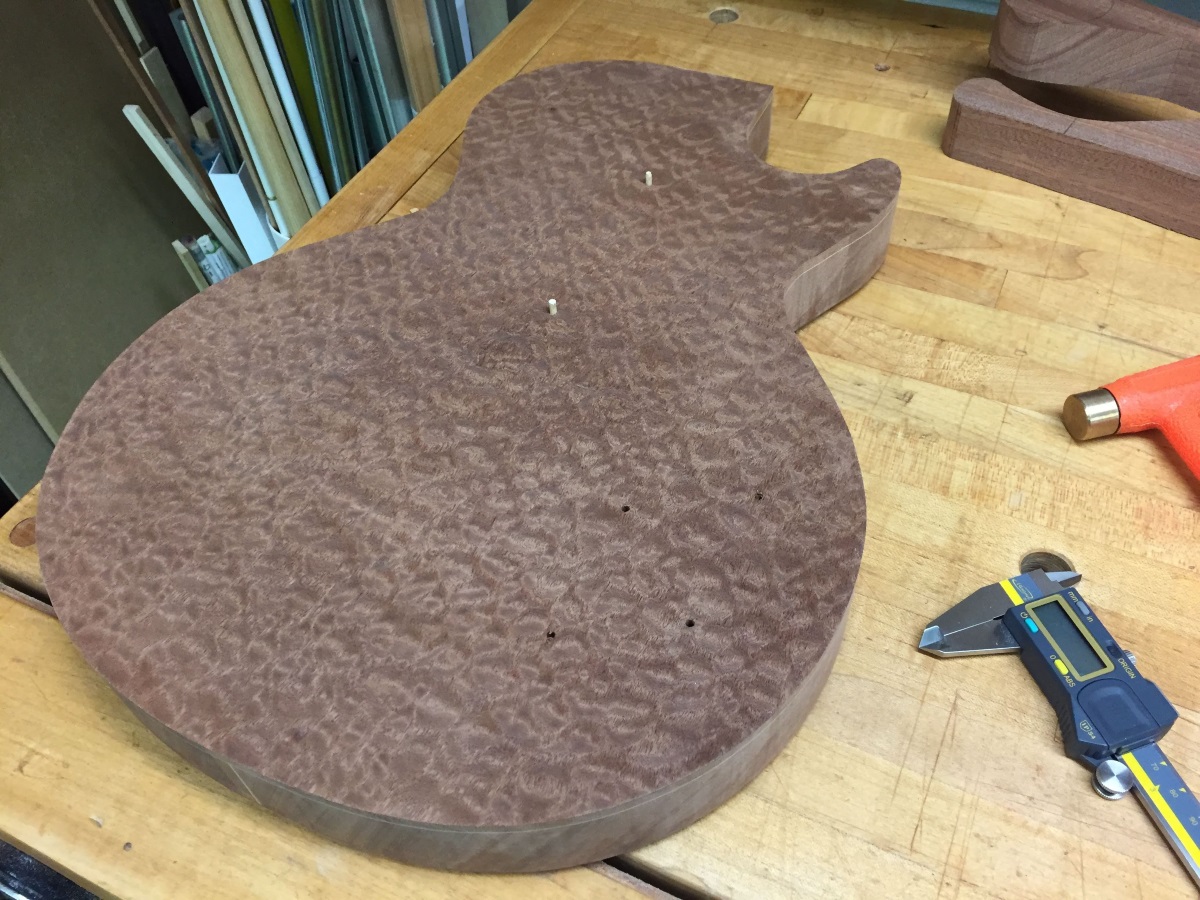

I made up the top plate from some additional stock I had that I jointed, edge-glued then planed down to about 3/16" using an MDF sled in the planer, then veneered front & back in the vacuum bag. Came out to about .225" total, so it will be hidden nicely behind the binding.

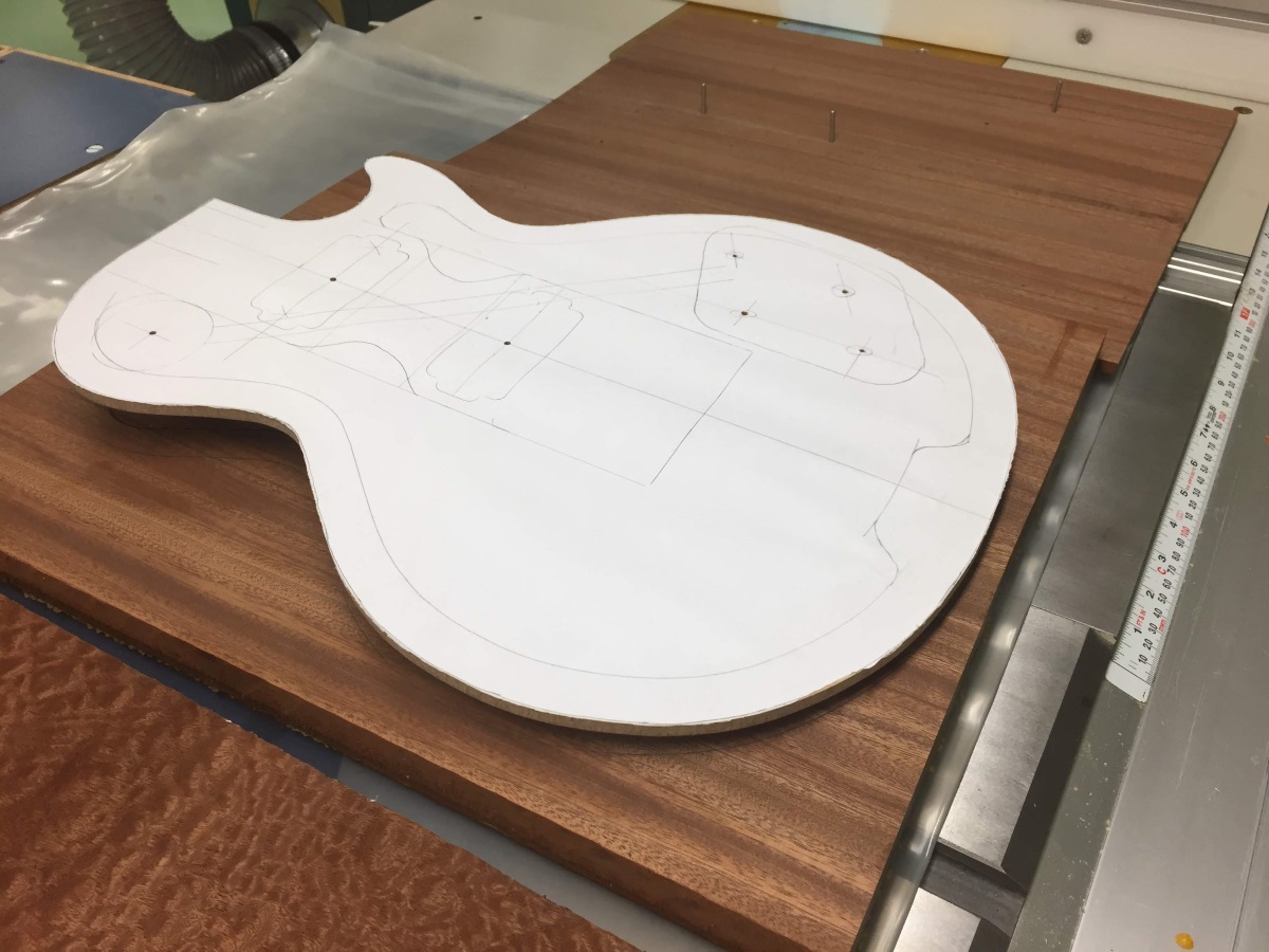

I band-sawed the center section to create the chamber, glued a piece of contrasting wood (some birch veneer) into the saw-kerf at the butt end of the body blank, and used the result as a pattern to mark out, cut and glue-up a caul to allow me to use the vacuum press to glue up the back plate, the chambered center section and the veneered cap without creating "dimples" in the cap where the chamber is, or even worse, crushing the cap into the chamber. The pattern I made for the body has two 1/8" holes drilled smack in the center of the positions of the pickup routs, and I used these to drill corresponding alignment holes in the back plate, center section, top cap and the caul so everything would be easily aligned with some 1/8" dowels.
This time I used some Titebond Extend glue so I wouldn't have to worry about anything setting up while I assembled this "sandwich", and inserted the entire stack into the vacuum bag and let it sit in there for about three hours. This is much longer than Titebond recommends, but after 90 minutes the squeeze-out was still gooey, so I stuck it back into the bag just to make sure.
When it was all done, I couldn't detect ANY deviation from flatness across the face of the body blank, and only had a little valley of .026" to deal with on the back. Ran that puppy through the planer with one very light pass so the back is perfectly flat so I could go on and band-saw the outline of the body and run a router around the pattern.
So...onwards!!
Oh - by the way, I weighed the pieces that I removed in the chambering. This will reduce the weight of the body by about 2 3/4 lbs!
