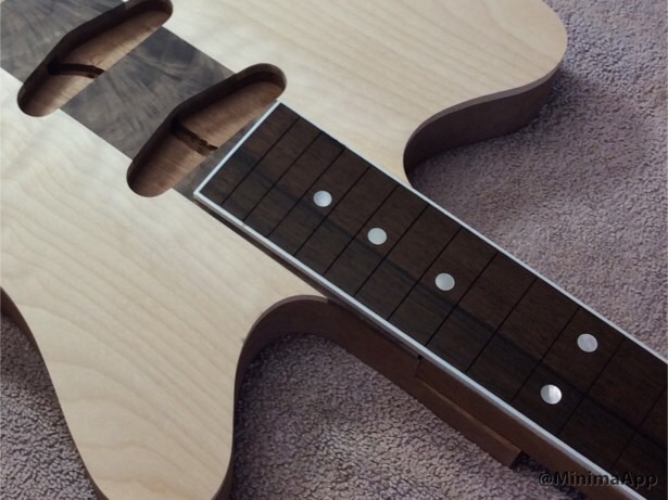

I am looking for a posting or discussion about position of dots of fretboards. I ask because I made a banjo for my partner and mistakenly put a dot on the 9th fret and discovered that banjos seem to have that dot on the 10th fret. Guitars seem to be at the 9th fret. Mandolins seem to have it at the 10th. What gives here?
