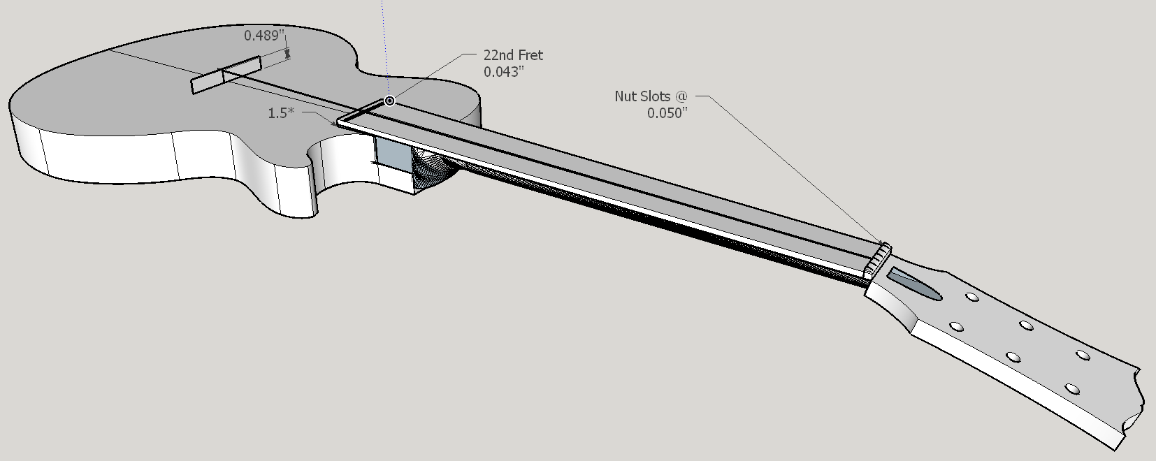

I posted awhile back asking about a bolt-on neck on an LP-style guitar. After doing the calculations (see below) that show I need a 1 1/2 degree neck angle, I'm re-thinking this, and figuring I might as well learn to do a set-neck.
A pencil-and-paper drawing and the drawing shown below both yield the same value - 1 1/2 degrees - for the neck angle. The only thing that I'm unsure of is dealing with the lack of support for the body-end of the FB. On carved-top guitars, the FB actually rests against the sloping guitar top on either side of the tenon. In my case, the top is flat. As you can see, my original drawing was considering doing a fender-style joint, to keep the neck shaft full-width below the FB. However, again as you can see from the drawings, I only have a gap of 0.084" between the FB and the flat guitar top. Is there any reason I couldn't glue on wedge-shaped "wings" beneath the sides of the FB, and a similar shim on the end of the FB to provide that support?
Thanks!
Thanks!

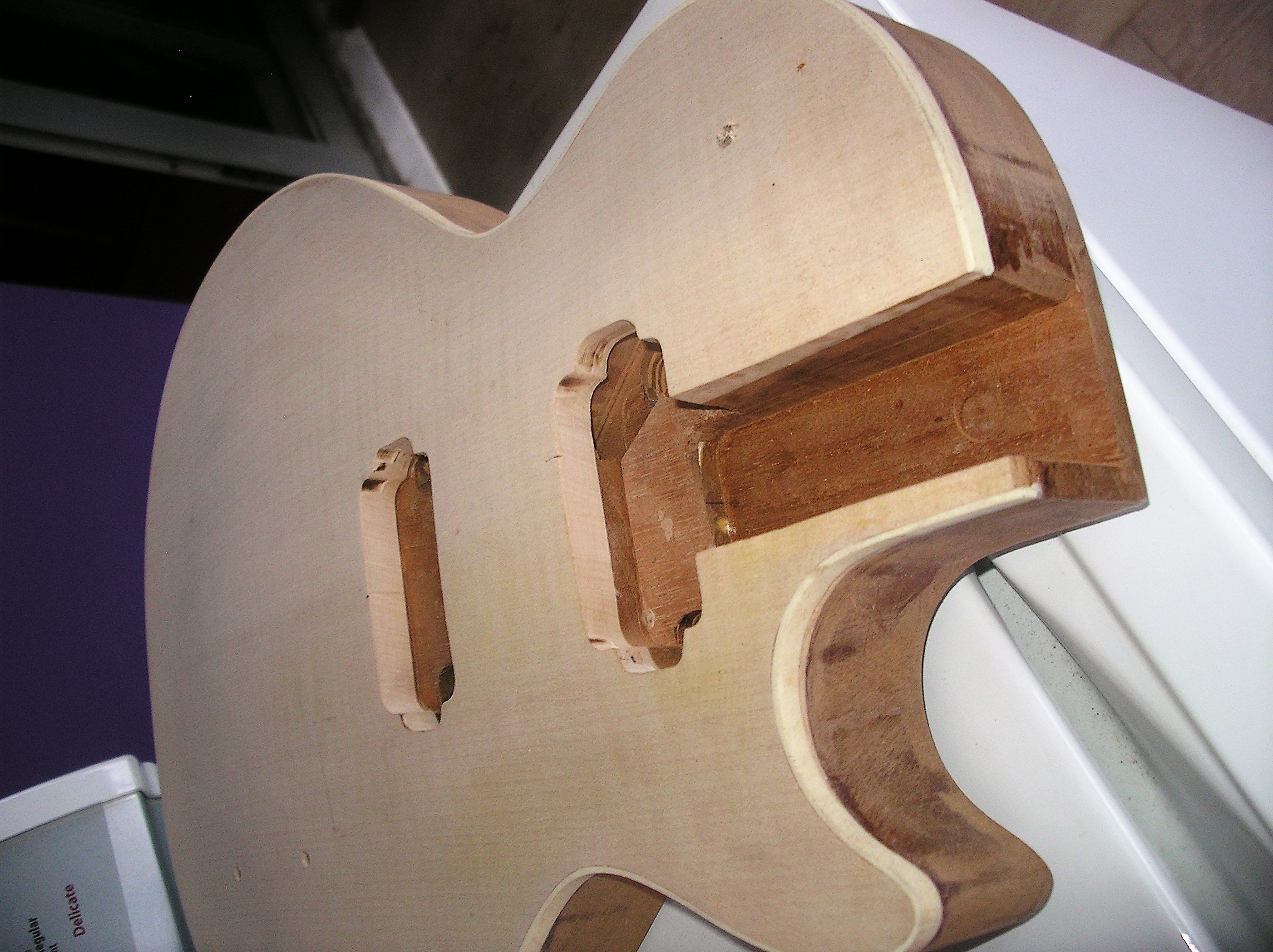

I hope these two pictures come out ok...I don't think it's vital that the tenon extends into the pickup cavity I can't see that adding a great deal more strength especially as some LP neck tenons had a rounded bottom so the neck angle could be easily adjusted. Personally though I would keep the tenon at least the full length of the fretboard, I've also seen on some cheaper LP copies that they only step the tenon on the cutaway side and leave the neck full width for the upper bout, this saves quite a bit of work as you only have to make an accurate shoulder on the cutaway side of the tenon, it looks a bit odd not being symmetrical but I can't see any problem with doing it that way?
Cheers Chris
Cheers Chris

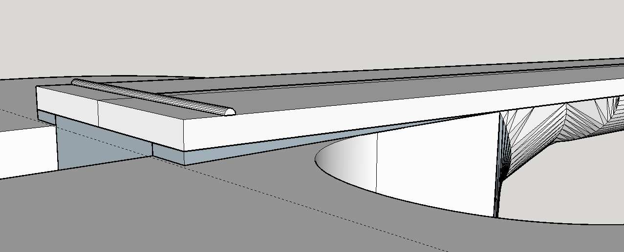

I played with the idea of a full-width tenon, but it requires a Fender-style neck rout that is open on the cutaway side. (See my second pic above). However, I was looking at a new Gibson LP at a local guitar emporium and was shocked to see this ugly boss on the cutaway side, which suggested to me it might be using a full-width tenon on the neck. It was REALLY ugly!
I think I'm going to go with a narrow tenon and wedges.

Steve, if 1-1/2 degree angle and the little wedge work for your geometry, then thats what you should use. I have been successful with 3-1/2 degrees and no overstand, but my tops are pretty arched. I have used wedges on a couple of true archtops - that is pretty common with their geometry.
I question your 0.48 bridge height - did you take that from an actual bridge or an engineering drawing? Most of the ToM's that I've worked with are closer to 0.625 at their lowest adjustment. My rule of thumb has been that the fret plane should just hit the top of the saddle at its bottom point - that seems to give adequate adjustment for almost any action you want and to provide for future changes in the guitar. (I can go thru the reasoning but maybe not this thread, I've posted the question here and at OLF on how other builders calculate their geometry but never had a good reply).
Anyway, if that bridge works then there are a range of angles and standovers that will work - the more you make the angle the more you can drop the front of the wedge.
If you decide to go with 1-1/2 degree angle I would suggest making the bottom of the neck pocket at that angle, make the tenon rectangular (parallel to the top of the neck). The neck will stand proud of the body, just fill the sides with the wedges. Most of the time the tenons extend into the front pickup cavity - there are "short tenon" versions but they seem to be problematic - I have repaired one and heard of other issues. It seems link the longest gluing surface is desirable.

From the actual bridge. It's a Mighty-Mite ABR ToM style, and I measured from the bottom of the adjustment wheels to the bottom of the saddle slots - the lowest possible position for the strings. And yeah, I'm using the same logic you do to determine the proper neck angle, though I'm taking into account the nut height.Freeman Keller wrote:I question your 0.48 bridge height - did you take that from an actual bridge or an engineering drawing?
That's the way I seem to be going, Freeman.Freeman Keller wrote:If you decide to go with 1-1/2 degree angle I would suggest making the bottom of the neck pocket at that angle, make the tenon rectangular (parallel to the top of the neck). The neck will stand proud of the body, just fill the sides with the wedges. Most of the time the tenons extend into the front pickup cavity - there are "short tenon" versions but they seem to be problematic - I have repaired one and heard of other issues. It seems link the longest gluing surface is desirable.
As you can see in the pic below, I was planning on notching the tenon to go under the pup right at the end of the FB, but while this will leave clearance for the ring between the pup and the FB, this will leave no support for the ring, so I'll need to mod this as you describe. Also note that I do plan on binding both the neck and the body. I'm doing a natural finish, so as long as I use some carefully selected scrap sapele for those wedges, they should look ok.Freeman Keller wrote:the fretboard ends there and that little gap is filled by the ring....Another slight problem is if you are going to bind the neck and body - you will have a gap between them that needs to be finished.
I'm working from some plans that I got a couple of years ago, and don't remember where they came from, but one of those plans you linked to might help with the issues of doing a flat-top.

Your question made me go back and use a different (hopefully better) technique to double-check, and I was a little off - it's actually 0.510". Not sure how much difference that will make to the neck angle, but I'll re-calculate that.Freeman Keller wrote:Interesting about the measurements on that bridge, my notes show that the three different ones that I have used are 0.544, 0.565 and 0.599.
- Steve Sawyer
- Posts: 965
- Location: Detroit, Michigan
Re: Neck joint - LP body, flat (not carved) top, neck angle and FB support
Heh, heh...
A little trig shows that my .012" bridge height error translates to an angle correction of .027 degree. I'm having enough trouble measuring a 1.5 degree angle!! I think I'm still good...
ARCSIN(.012/24.75)=.027
