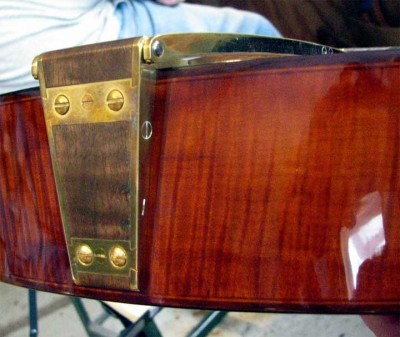

This is one of the reasons I have abandoned the Benedetto cello style tailpiece fastener. I think D’Aquisto had a better idea, which was to make a 1/2 wood and 1/2 metal hinge. The top piece is wood and the end piece is metal. A steel pin runs through both to make the hinge. I’ll try to add a couple pictures of the one I just made. This uses 1/2 of a brass hinge I got from a marine supply company, but you could make your own out of brass stock.

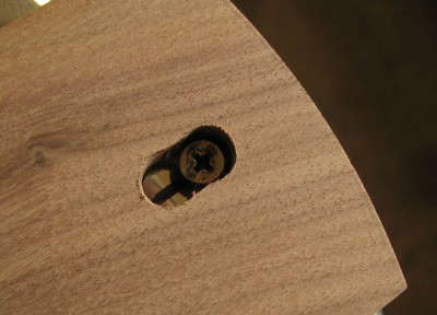

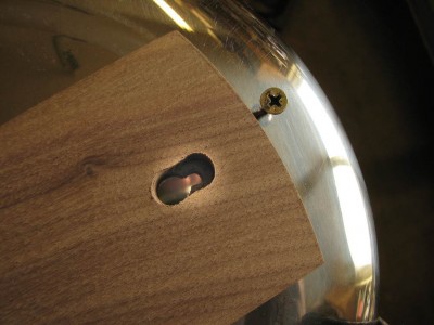

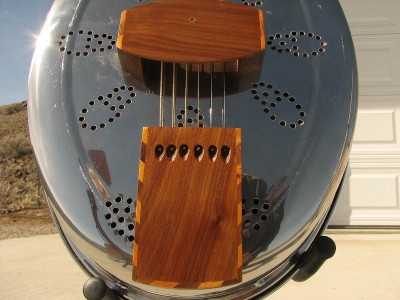

i made a similar tailpiece for an experimental resophonic guitar a few years ago, held on to the tailblock by my favorite hardware, a drywall screw.

Peter, did the drywall screw actually hold up to the string tension?
Posts: 1327
Re: End pin jack being pulled forward
John, it's been hanging strung up for 7+ years and very seldom played, but so far so good. If I were to make a gigging guitar with the same tailpiece design, I'd use a thicker screw of better steel.

Thanks, Peter. What was your tailblock wood? That seems to be my biggest problem.
Posts: 1327
Christ, the wood is alder (because I literally have tons of it). The blocks aren't going to move or deform, as they are large and well buttressed by the metal pan and internal braces. Alder seems to be adequate for holding the screw straight, plus the metal pan probably helps.

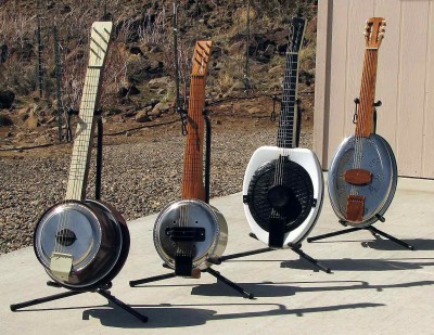

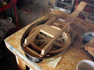

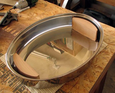

I don't want to hijack this thread, but I am quite fascinated by Peter's roasting pan resonator. I'd love to see any other info about that. I guess I'm asking for a new thread on that one Peter. I'm also curious to see what the problem turns out to be with the travelling jack and what solution you come up with, so I will be following this one eagerly as well.
Posts: 1327
Jim, that build was part of a challenge here in 2010 when I built 4 resophonic guitars from scrounged/unusual parts like 5 gallon buckets, toilet seat, roasting pan, fiberglass and plastic dishes Since none of them had proper cones and bridges, their sound left something to be desired. Unfortunately, at that time, threads scrolled down off the site and were apparently lost forever, so it's no longer available. However, I can post a summary of its construction in the near future, probably in the builds/tutorials section of MIMF. Anyway, here's a pic of the completed guitars.

John Clifford wrote:This is one of the reasons I have abandoned the Benedetto cello style tailpiece fastener. I think D’Aquisto had a better idea, which was to make a 1/2 wood and 1/2 metal hinge. The top piece is wood and the end piece is metal. A steel pin runs through both to make the hinge. I’ll try to add a couple pictures of the one I just made. This uses 1/2 of a brass hinge I got from a marine supply company, but you could make your own out of brass stock.
BTW Jim, that is one seriously beefy brass hinge. Can you share where that came from?
John Clifford
Posts: 180
Post by John Clifford »
Randolph, I'm not sure if you were addressing me or Jim, but the brass hinge part shown in my photos above came from a Whitecap brass strap hinge, part #S-604BC. You can find these on numerous marine supply websites, or amazon. It's heavier than it needs to be, but I like solid hardware and I don't think it hurts to add some mass at the tail end.

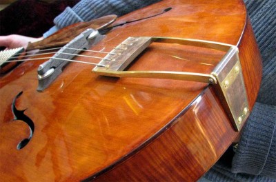

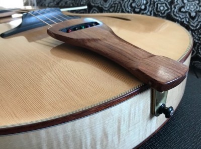

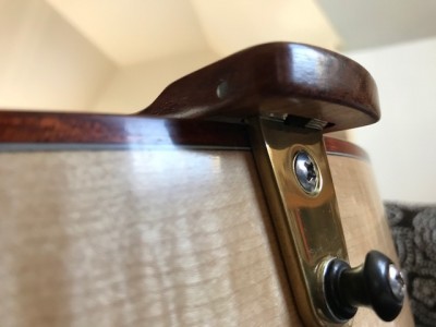

I recently delivered an archtop with a 'different' tailpiece , and was dismayed when this thread came up to find that I hadn't gotten a picture of it. Fortunately, the customer is also a student of mine, and he brought it in Saturday, so I was able to get a couple of shots.
The guitar was intended as, in some sense, homage to a Loar L-5. The intent was to come up with an instrument that would work well for acoustic jazz in the 20's-30's style. Normally I would use a wood tailpiece, but the customer thought that since the original was metal, we should go that way. I didn't like the look of the Gibson style tailpieces, so I fell back on a technique I'd used a couple of years ago to make a latch for a folding harp guitar. The issue was that the brass I can get that is thick enough to take the load is too thick for me to bend, so I had to come up with a way to piece it together. I based it on the old transitional 'infill plane' design, whereby a wood plane could be plated with metal. The metal, brass or steel, plates were cut to fit around a wood core, and screwed on. the plates were dovetailed together at the edges, and once mounted the joints were peened to tighten them up. The metal was then filed off level and polished. Here's the fixed part of the hinge, in walnut and brass with a stainless rod for the pivot. You can easily see the dovetail joints. The flat head brass screws that hold the wood and metal together are filed off flush. The fillister head screws are the ones that hold the tailpiece onto the guitar.
And here is a shot of the whole thing.
The wood part of the trapeze is hornbeam, that has been stained to look like walnut. The strings are retained as per my reading of the Elliot pinless design.
The next time the customer comes up we'll put in an endpin. He doesn't normally play standing, but wants one if he needs it.

Very cool looking tailpiece, Alan. So are there pins going through the ball ends of the strings to hold them in place?
I'm guessing this ended up being pretty heavy. How do you think that affected the sound, if at all?
