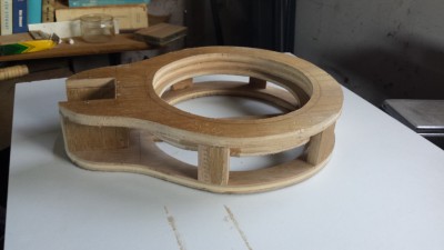

Plywood is a common choice. The important thing is to get the sound well and body really solid (and of course, different designs depending on what type of cone you are using).
I've only built one, and it sounds pretty good but weighs enough that I need a strap to play it standing.

Conventional wisdom says the opposite - you don't want the cone to flex while you're playing or it will distort.
This was my skeleton (pear-shaped body), ready for cladding.

Conventional wisdom may dictate otherwise, but a lightweight soundwell can be successful. The Brazilian Del Vecchio Dinamico uses a 1/8 inch thick bent plywood ring that sits on a longitudinal bar running from headblock to tailblock, with a ledge which supports the cone. These guitars have a beautiful tone. They have a "biscuit bridge" and lightweight aluminum cone. However, if you're looking for something more in the nature of a National or Dobro sound, then you may want to go with a heavier soundwell.

thanks folks!! 3/4" ply it will be!
