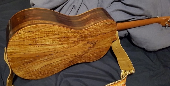

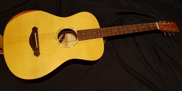

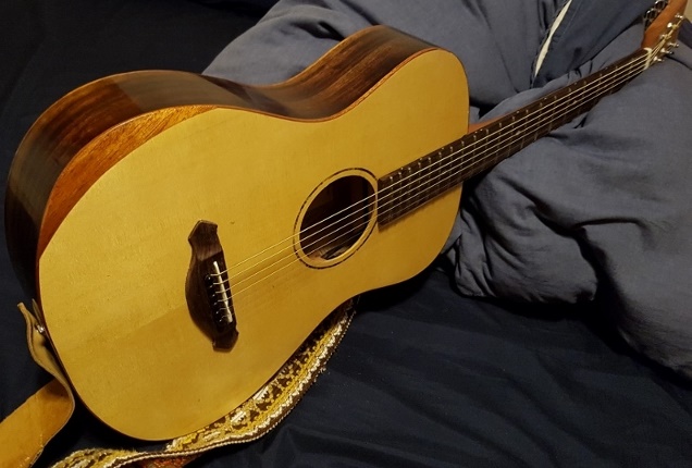

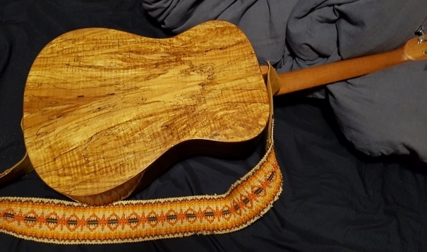

I haven't posted in a long time. I just finished this parlor guitar for my wife. She picked the woods before she started taking guitar lessons a couple years ago. It has a number of interesting things going on so thought it was worth posting. Specs are:
Top Alaskan yellow cedar
Sides East indian rosewood
Back Spalted flame maple
Binding and armrest Mahogany
Neck Mahogany
Fingerboard and bridge East indian rosewood
Inlays Abalone
Finish Padded on liberon oil finish on the body and tru-oil on the neck (I ran out of liberon)
Shape approximate copy of an unplayable garage sale parlor guitar I was given years ago - similar-ish to a Martin ooo

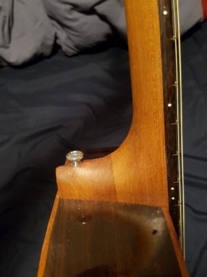

In addition to the odd wood combination and the armrest, it has a carbon fiber flying buttress supporting the neck block and a fully adjustable neck. The neck adjusts via a stove bolt that goes through the strap pin on the neck heel. If you dindn't know, you would just assume it is a regular strap button. I drilled it out so the bolt would go through it instead of using the screw that comes with it. The bolt threads into a t-nut in the neck block (no effort was made to hide it inside - I never look in there). The fingerboard floats over the body and has carbon fiber rods epoxied to the bottom to stiffen it. This is the first one I've done this way and am already totally sold on it. Within a minute of bringing it up to pitch for the first time, I had the action dialed in better than most of my electric guitars. It sounds good too which is an added bonus.
I took lots of pictures during construction (400+) and kept track of my time. 41 hours in total (less than I expected) spread out over a full year of tinkering (I only worked 42 days on it). If anyone is interested in any parts of construction, I'd be happy to post more.
Enough rambling. Onto pictures.

Re: So that's what halfway between maple and rosewood sounds like
Looks great. You don't see a lot of back and sides using different woods so I wasn't sure what to expect when I got down to the pictures. They came together nicely.

Thanks for the kind words so far. The neck is just held on by the one bolt. It should be more than strong enough to hold everything together. It will be a bit loose and floppy when changing strings but no big deal as I will expect that. The only other hardware in the neck joint is two small round head wood screws which act as pivot points. It feels rock solid when strung up. The neck extends into a pocket in the body maybe 1/4 inch. From the playing position, it looks seamless. I took my time trying to get it perfect so even if you look from the head stock down the neck, the biggest gap can barely fit a piece of paper. I used to spend just as much time flossing the neck joint as making the pocket on this one so I don't think it takes all that much more time.

Here is how I did the adjustable neck.

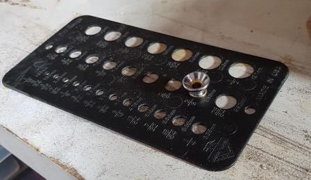

Here is a picture of the hardware I used. A standard strap button drilled out for a 3/16 hole, a 2 ½ inch 3/16 stove bolt, a 3/16 t-nut, and two round head wood screws. total weight is quite small (19 grams)

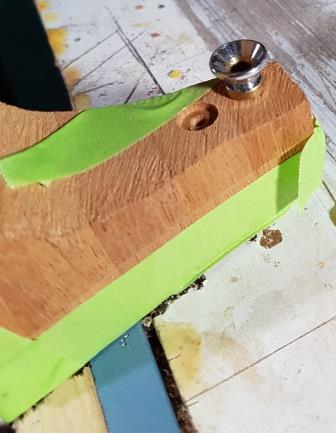

First thing to do was drill the neck. I marked where I wanted the strap button.
Then I use the strap button to pick the best drill bit.

Drill a countersink the button will fit into. Followed by a picture of the button in the hole and beside it.

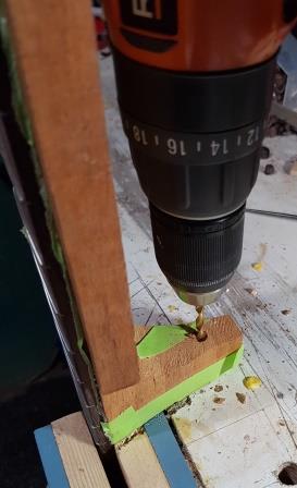

Then drill through with a 3/16 bit. The heel has a ½ inch dowel installed top to bottom so I’m minimizing the amount of wood I’m removing from the neck. It should be plenty strong.

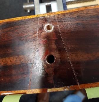

Then I placed it on the body and used a transfer punch to locate the hole in the body. This was done before I had finished carving the neck or buffed the body - you could wait until after those two steps are done as you don’t want to route until everything is finalized. Drill a ¼ inch hole (The size of the outside neck of the t-nut).

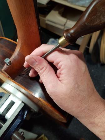

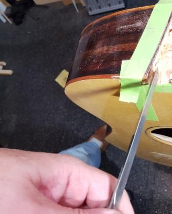

I skip ahead now to after the body is buffed, and the neck is carved. The t-nut goes inside the body and the neck is bolted on. Carefully scribe around the neck (just like you would do around a bridge before gluing one down).
- Posts: 30
- Joined: Mon Mar 12, 2012 11:35 am

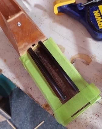

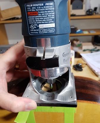

I measure how deep I want to go. Then with nerves of steel, freehand route close to the line as you dare (I stayed about 1/8 inch away). Go a bit deeper than the minimum you need to. Last picture is the rough pocket. The tape is just a visual reference for me to not go too near.

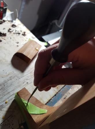

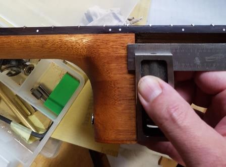

Refine it with chisels, rasps, sandpaper until you like the fit. Use chalk or carbon paper or just eyeball it. The edge is slightly undercut so it won’t hang up anywhere.

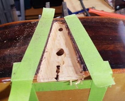

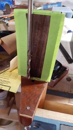

A clearance pocket is routed into the top. I’ll use a jig next time. To install the fingerboard supports, use a long aircraft drill bit and drill into the neck under the fingerboard. The CF rods get epoxied in.
