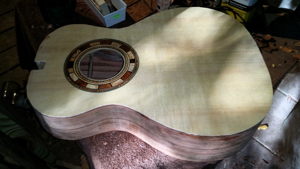

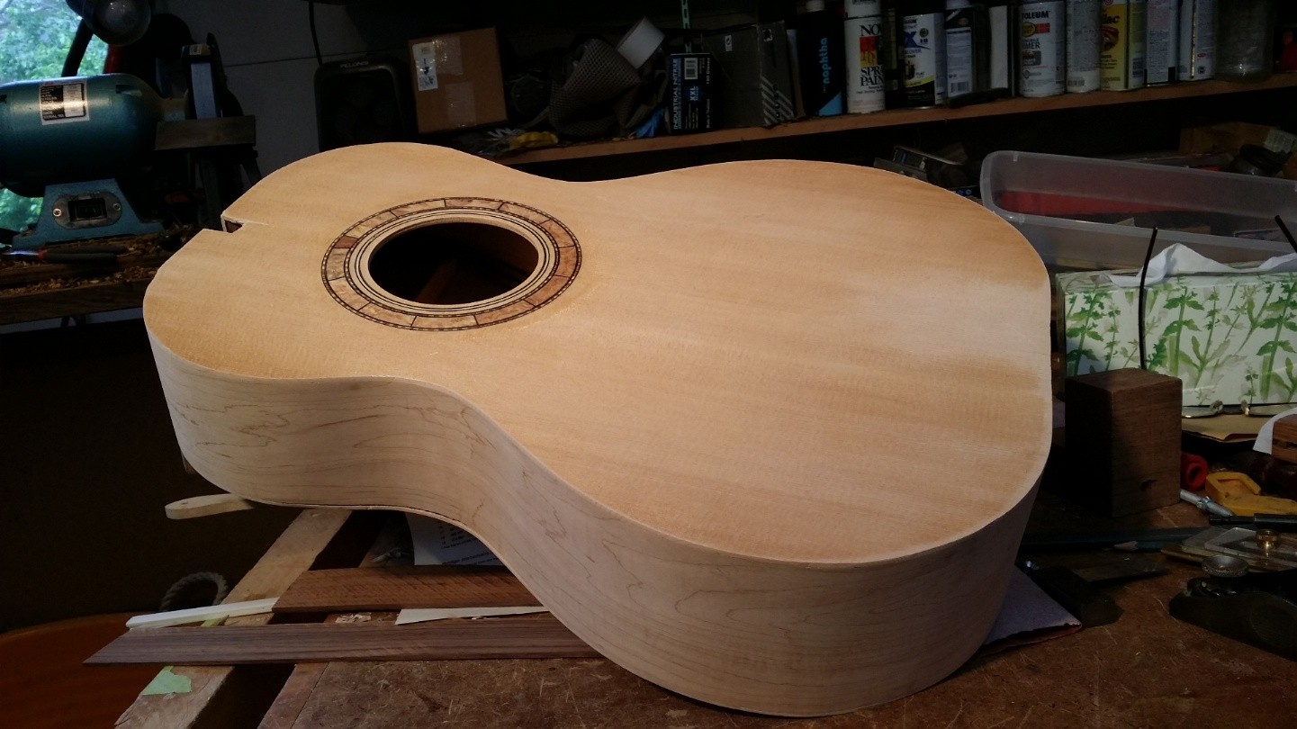

I followed the discussion on the plans Eric started last spring and printed them out. Choose the L-00 for some reason.
Moved the sound hole and x bracing up 1/2" to accomidate sh placement on sound board. Later saw series of YouTube videos on bracing and learned that might be a big change.
I used tendilions construction, as I enjoy it. Worked smoothly.
Then carved off the overhang.
Macacauba and curly Sitka spruce.
This is my 3rd build.

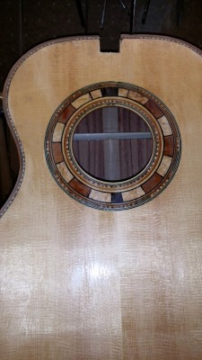

Thanks for spelling. Here is sound hole and top.

I've installed the bindings and perfling. I made them both and cut off with 1/16" Cerf table saw blade
Posts: 1390
Re: L-00 from Grellier's plans
Looking good, nice progress. It is hard to tell form the picture, what kind of top purfling are you using?
Bob Howell
Posts: 234
Location: Atlanta, GA
Post by Bob Howell »
I made one from a bunch of maple sliced off about 1/16-1/8 and various shades of brown, walnut, canary wood, santos rose wood and cherry veneer. Repeat every 2". Sliced off 1/32" with bs and glued up between VERY thin mahogany veneer, dyed black. Square, not angled. Worked out to be 5/64" wide. I have done several of these and am amazed what I can do successfully.

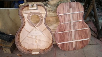

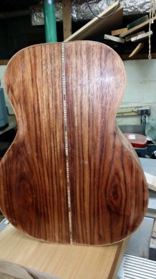

Here are more pictures. The bindings are cherry and neck will be also. The rosette is Cherry, maple, walnut, manzetta burls with holly, cherry, and black veneer mixed in. I went for random arrangement rather than symmetry.
Back strip is More of same sandwich cut 1/8" thick with cocobolo block and same veneers. Lots of cleanup remaining. Several binding repairs to make. Used HHG and have little model airplane covering iron to heat and fix.

I had installed the rosette located according to another set of plans, but when I traced out the location of the bracing I realized the sound hole must be 1/2" closer to neck. I think I moved the x brace 1/4" also and made it a 90 degree joint. Saw a youtube short that said that moving x brace 1/2" is BIG deal??? I don't know.
Beate Ritzert
Posts: 607
Location: Germany
Post by Beate Ritzert »
Wow. She's going to become really pretty.
Posts: 1390
I like that back strap!
Moving the X or changing the angel can be a big deal inasmuch as it will alter the tone, but it will still sound like a guitar (just a different guitar than it would if you hadn't made the change). As long as the lower legs of the X catch the bridge, you should be fine structurally. You'll have to make some more guitars before you can start to know how bracing changes will shape your tone.

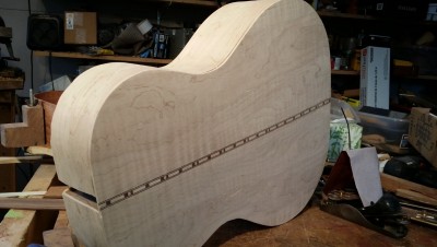

Two shots of another L-00; this one all curly maple and Sitka. I have collected a lot of figured maple over the years and last week I cut out 5-6 sets and have more to go.
This one will be naturel white. Seems a lot of trouble to dye back and /or sides without the perfling. In the past I have used tung oil thinned down to bring out the grain with out darkening maple. Now I'm wondering if wipe-on Polly from Minwax will work as well. Save buying another can.
What string weight are good with this design? The top is 3/32" most places but drops down to almost 1/16" in two places at the lower bout bottom edge.
Note the back stripe of blood wood and black/white. Saw this on Hanns Binurip's site and adapted it. He mentions old "Larson" model as his inspiration. I plan to use it in perfling also.

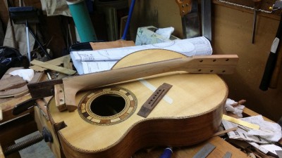

Finished up the bridge and am surprised how small it is. 5/16" by 1" by 6. Drilled 13/64" holes as discussed in GTT. Bridge pins are lose, not tight. 5% ebony pins. Guess they tighten up later down the line. Today I will locate bridge and then begin final FP finish and neck finish.
