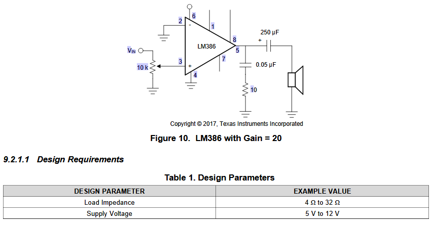

Hi Garhurd and welcome to the forum.
Can we clarify a couple things? First, the LM384 is a power (voltage) amplifier and it will provide the power increase needed for the earphones (typical application circuit from the datasheet below).
And by "sound information flag", I think you mean the input (pickup) signal?

Hello Charlie, thanks for the welcome and clear me the speaker circuit.
Yeah, I mean input signal and now I got my point.

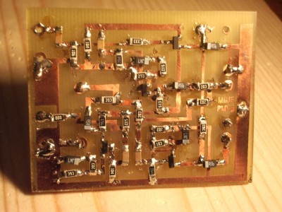

I hate the LM386, it's specs were garbage when it came out in the 1970s. We've gone through dozens if not hundreds of evolutions of "pocket sound" since then and there's no reason not to look for a better alternative or simply buy something off the shelf, or as a kit to get this job done. I'd look through some of ST's offerings here: http://www.st.com/en/audio-ics/headphon ... fiers.html
I'm sure TI also has some great options. There are some good legacy chips from the 1980s and 1990s that would serve well albeit use way more current than the latest generation. Most of the modern packages are designed as SMT only and will undoubtedly pose an issue for a one-off implementation but I'm sure there are ways around that.

You can always design and etch your own board and solder on all the SMT components. It's not easy, but it can be done. This is one of the MIMF preamps designed by Vlad Arlean, the board is 2" x 1 1/2".David King wrote: Most of the modern packages are designed as SMT only and will undoubtedly pose an issue for a one-off implementation but I'm sure there are ways around that.
