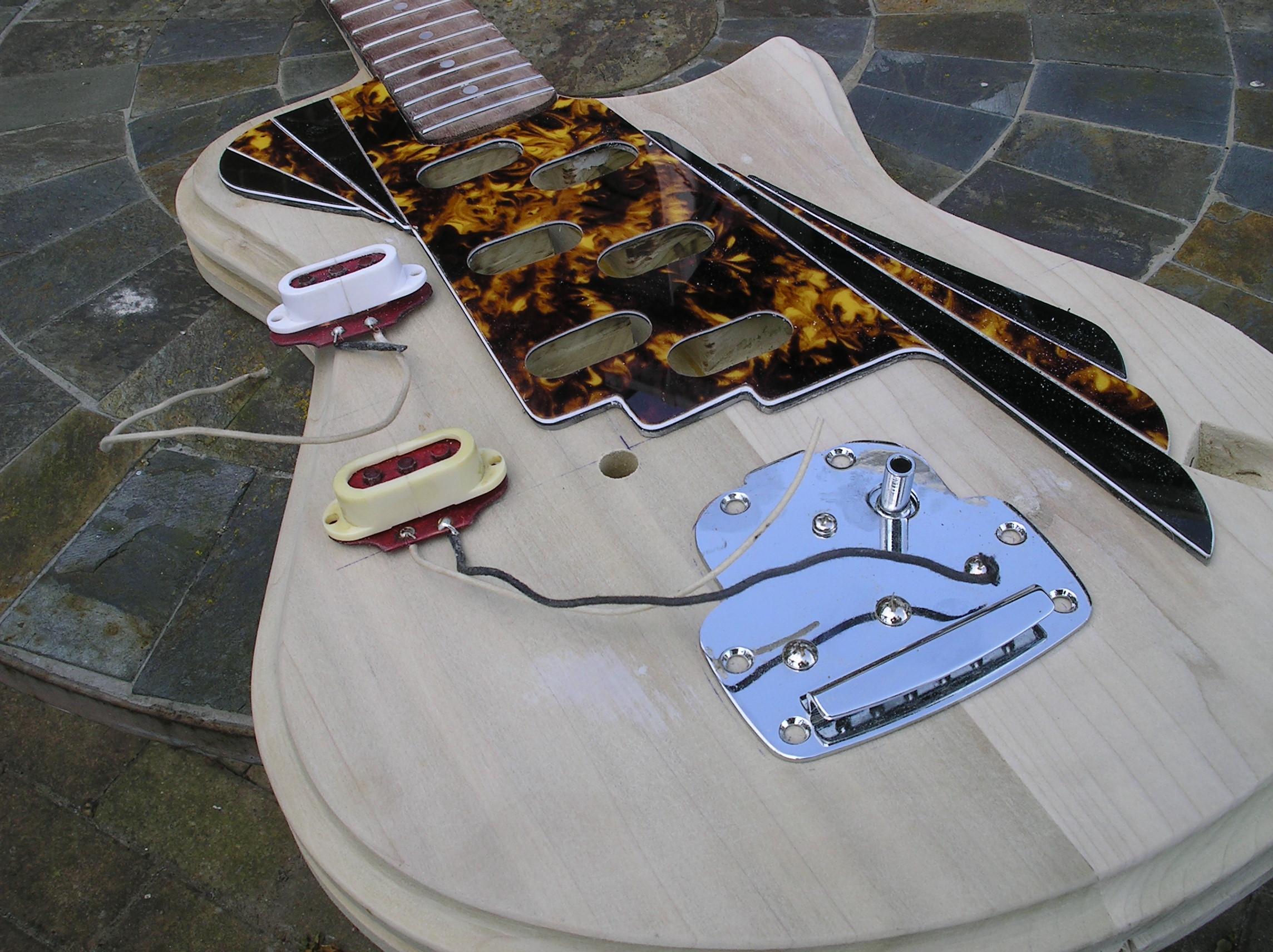

Thanks to all for the information...I'll get searching, the pickups I've made so far are from scratch and seem to work well when rigged up on other guitars but I'm now in the middle of making a bespoke guitar for them so we'll see how that goes....Here's a picture, they're three pole and in a kind of Strat configuration with two Strat style5 position selector switches so you can have the neck p/u bass strings and bridge p/u treble strings selected (as an extreme) the middle pickups are reverse wound. So we'll see what a mess I can get into with that!!!
Re: Pickup book
Depends on what you mean by "off beat" designs. There are a lot of things that will work, but as David says, what has come to be accepted into the design and tone lexicon of pickups ("on beat") is the result of many trials and errors, both through the tinkering and experimentation of pickup builders and the real-world survival of the fittest on the market. Looks like you're trying out some cool stuff on that Deco axe. There are so many pickup designs that are simply variations or refinements on a theme.

Chris Richards wrote:Thanks to all for the information...I'll get searching, the pickups I've made so far are from scratch and seem to work well when rigged up on other guitars but I'm now in the middle of making a bespoke guitar for them so we'll see how that goes....Here's a picture, they're three pole and in a kind of Strat configuration with two Strat style5 position selector switches so you can have the neck p/u bass strings and bridge p/u treble strings selected (as an extreme) the middle pickups are reverse wound. So we'll see what a mess I can get into with that!!!
Chris, that is quite awesome! Really love the look!
