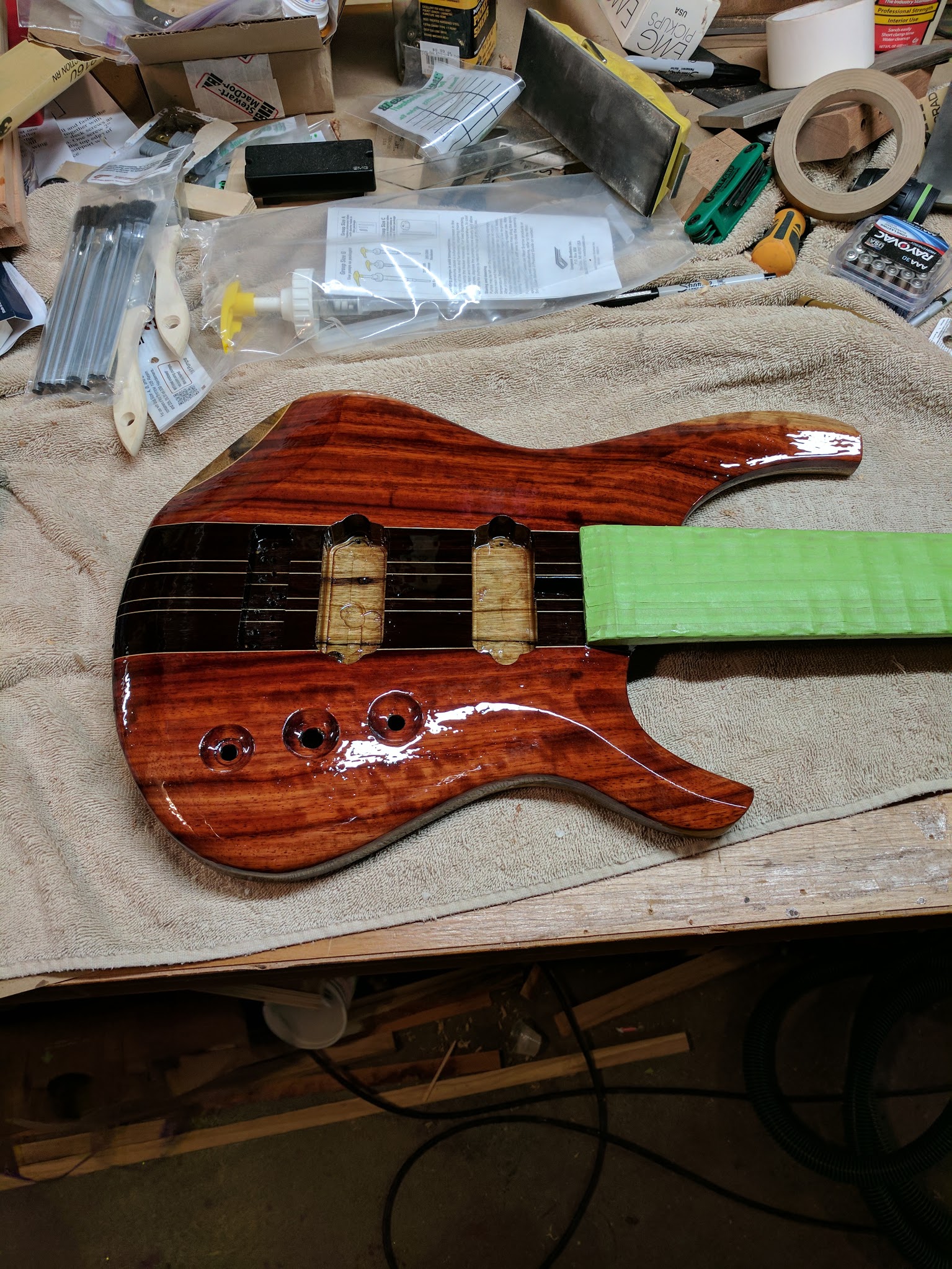

There's no need to heat or otherwise fidget with the epoxy filler if you just apply enough on the first coat to fully wet things out and then remove as much as you possibly can with the squeegee...if the film is thick enough to show bubbles or 'juicy' areas, keep taking it off. Second and third coats take less epoxy, but the idea is to remove as much as possible each time so that prep for the next coat is a light scuff with 320 to knock off the nibs and ScotchBrite maroon to degauss and tooth. Three coats will fill all but something like super curly ash, which might take 4 coats. The advantage to epoxy is that the stuff twists light in a nice way; the disadvantage is that it's not a one coat filler like most of the new latex or UV products, so eats some time.
