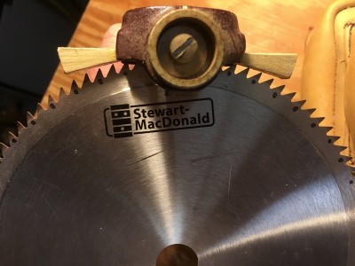

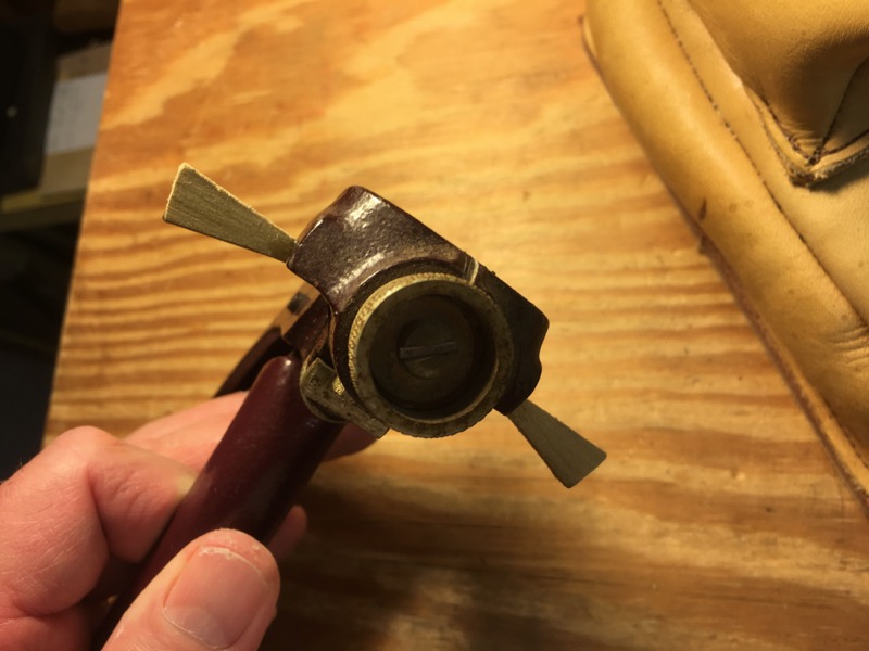

I need to fret some boards so I decided to give my Stanley blade set tool a try. I quickly realized that a circular blade did not register against the tool very well so I glued on some wood shims. They registered against the blade teeth fairly well.
Posts: 3249
Re: Adding set to a table saw blade
The saw set worked surprisingly well on the circular blade. One thing I discovered (and I seem to remember this happened to me when I last used the tool a couple of decades ago) that it is really easy to over set the teeth. Adjust the tool so that it seems like you are not moving the teeth at all. Maybe just a thousandth or two. You will be surprised how much set the teeth will actually take. I had to flatten the teeth and do it a second time.

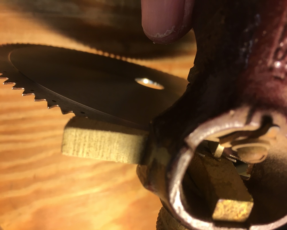

Here is a photo showing the tool's working part setting the blade's tooth. It's a bit hard to see but the shiny rectangle is the tool's post pressing the tooth against the anvil. You only want the break angle of the anvil about 0.015" to 0.020" down from the tip of the tooth. That is how you control the amount of set.

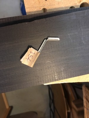

Here is a little tool that I make for each size fret wire that I use to test the width and depth of the slot. The bottom leg of the tool gets the barbs ground off.

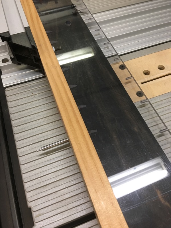

Here is my tablesaw setup.

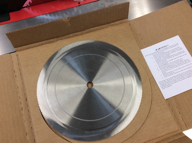

Looks like a beautiful blade. Do you know what kind of steel it is? I don't imagine it has carbide teeth. Is it an 8 or 10 inch blade. I have been trying to get several makers to make me a blade for my Saw Stop (I need a 10) and everybody keeps saying they are working on it, but nobody ever gets it done. Do you mind my asking what the cost was?
