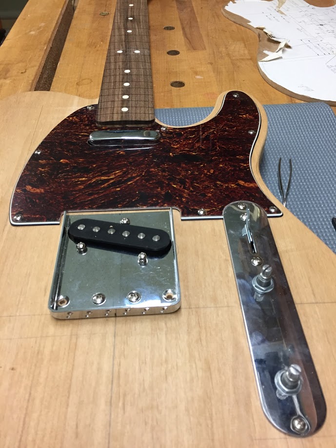

Still making progress as you can see from the pics below. I'm dry-fitting everything to make sure that I resolve any fit issues. This revealed that the control cavity was mis-routed a scrunch (a hair too narrow for the pots). Went back and corrected the template (which is where the issue was) and cleaned that up. Also, the bridge pickup was off-center for some reason, so I cleaned that up as well. Had to do a little trimming where the pick guard fits around the control cover, but everything is looking good now.
As I was working on this, I became a little concerned about my choice of bridge. It's a cheap vintage-style "ashtray" bridge from GFS, and I noticed that the edges of the holes where the strings pass through the bridge and through the guitar body had a nasty burr around them. I figured the treble strings in particular wouldn't last long if I tried to bring them into pitch riding against that burr. I used the ol' Dremel to grind off the burr and polish the edges, but I really have no great burning desire to stay "vintage". When I started this project I was working with a friend who was (jokingly) our "subject-matter expert" having built a fretless banjo at one point, and he was really hot on going very vintage.
I was looking at a Gotoh "modern" bridge that isn't too terribly expensive, but thought I'd ask what others have used for their Telecaster-clone builds.
Thanks.
Thanks.

Yeah, Mark - I've seen similar comments wrt the original "ashtray" design. If I was into building "aged" guitars, it would be a different story, but I'm after something that looks good and plays as good as I can make it.Mark Swanson wrote:I like the modern tele bridges. They work great and offer everything I want in a bridge, no hassles. I am not stuck on the vintage thing, why use inferior designs?
