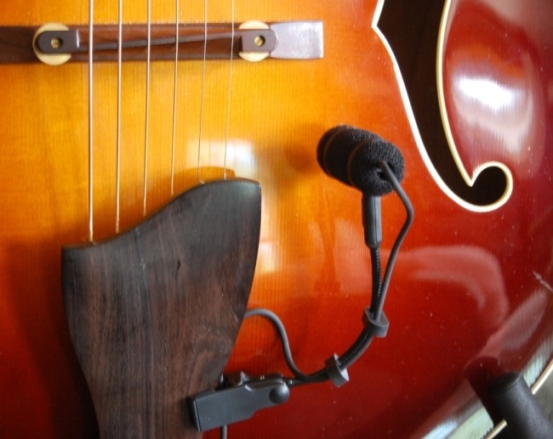

This is what I use for a true acoustic sound. Adding a magnetic pickup is something I have thought of for a long time. So far I haven't needed to switch from acoustic sound to electric sound on the same gig. With that said what would you suggest for my Eastman that currently does not have a pick guard?

The condensor microphone is probably a great idea to record the true acoustic sound of the guitar.
Two disadvantages come to mind: sensitivity to feedback. Long ago i tried something similar with a violin - horrible in that respect, but otherwise great sound). The 2nd disadvantage: the clip cannot be safely attached to most metal tailpieces.

I play in a 16 piece big band with my clip on condenser microphone. I have no issues with feedback. And no issues clipping on to the tailpiece.
