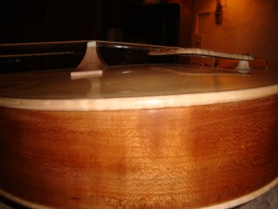

- Posts: 67
- Joined: Thu Oct 29, 2015 11:23 am
Re: experimenting with Alan Carruth's ideas on archtop bridge angle.
This is what I did.
I had the tailpiece raised as much as 1/4" higher than what you see. The bridge moved around a little while playing.
Currently at this level it stays in place even with heavy strumming.
If I were to stay with this arrangement I would use slide a rod inside the threaded coupler this would allow for a thicker diameter shaft and the tension would maintain the height.
Also, with this project I have almost no break angle over the zero fret.
- Posts: 922
My initial tailpiece mount design is essentially identical to yours, but I did not allow for the need to cantilever it above the top. Hence, the bolt that goes into the threaded insert in the tailblock ends up being almost 3/4" in bending, and it's not strong enough to support that torque without moving. That means the plinth that I have rotates down at the front, up at the back, and I don't like it. I will probably keep the design and use it again taking those things into account from the start, but for this guitar I will revert to another design that I know will work. How interesting it's been exploring this aspect of guitar building, I must say!

Thanks,
Because it is curly maple, I routed out as much wood as possible and laid in a curved layer of carbon fiber. Also, the tail block is Basswood with carbon fiber for added strength as well.
I was reading one of Alan's post about taping some lead weight to the tailpiece and changing the sound. So I clamped a bunch of small spring clamps to the tail piece and back off again (not a lot of weight) and I could not hear much difference. Maybe not enough weight or the carbon/wood structure doesn’t move much anyway?
