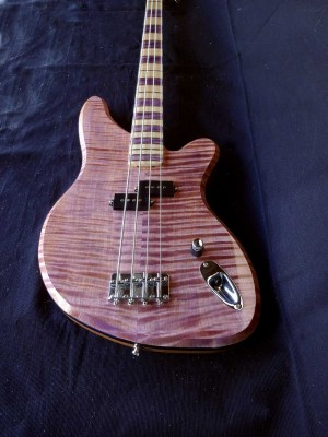

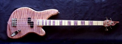

Bass #1 - dilute Kodak Ektacolor violet dye wiped on, then garnet shellac over that. The amber color of the shellac turns the violet a warm brown.
- Posts: 1327
Re: Some maple tops

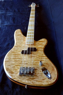

Bass #2 - She wanted amethyst color, which is about twice as much magenta as cyan. I mixed some printer ink refills I had, but it seemed a little grainy when I applied it to wood, so I matched it as best I could with the Ektacolor dyes, which seemed to apply a little smoother. The maple for the fret board was quite a bit whiter than the top, and it came out more blue. Oh well...

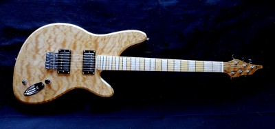

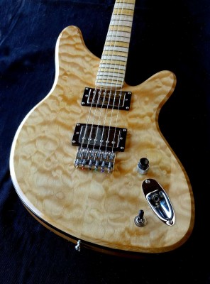

Guitar #1 - Just the garnet shellac wiped on.

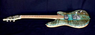

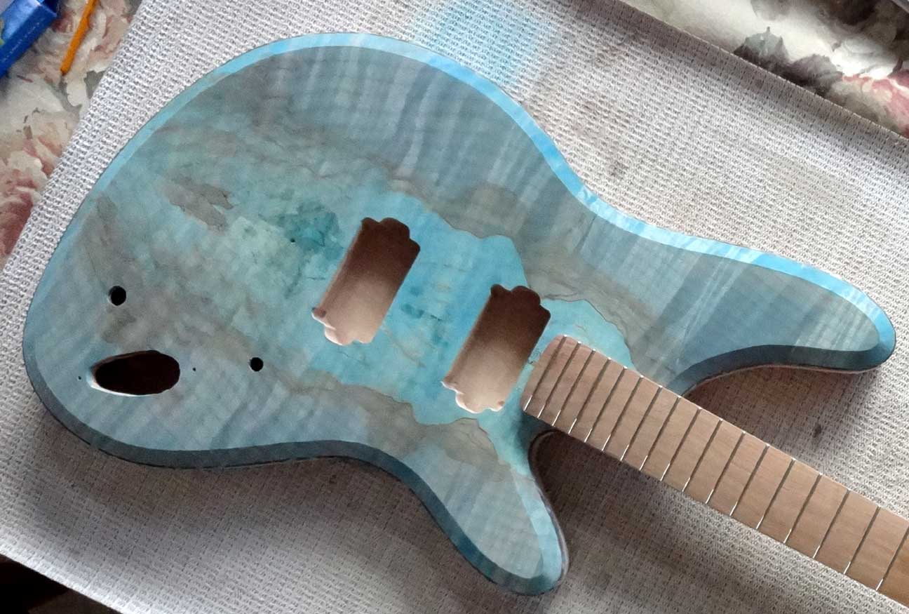

- Posts: 1327
Re: Some maple tops

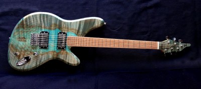

Guitar#2 - The maple is partially spalted, and took the dye quite differently. The dye is from watercolor tubes, pthalo blue and some black. I initially tried it in alcohol but it was incompatible, so I had to raise the grain and sand back, then apply it mixed in water.

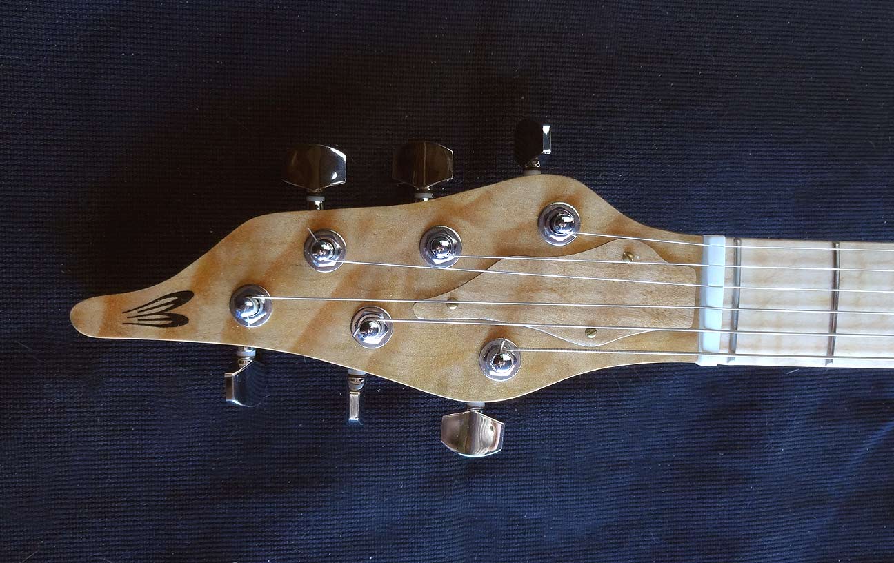

The garnet shellac one gets my vote. How did you die the fret position markers? Is the whole fingerboard treated with shellac, or just those frets?

I gave the fret position markers the same treatment as the tops and headstocks, after the neck was completed and the frets leveled, dressed and polished. I wiped stuff (dye, shellac, or dye and shellac) on with some kind of small pads that my wife uses to wipe stuff on her face (a small folded piece of cotton cloth would do as well.) I wrung them out pretty well to keep them fairly dry so it wouldn't slop over onto the edges of the board, and was careful to get it up to the fret edges but not over. Then I sprayed the whole neck and fret board in the usual manner with clear coats of lacquer. The un-dyed areas between the markers have only the lacquer finish.Randolph Rhett wrote:The garnet shellac one gets my vote. How did you die the fret position markers? Is the whole fingerboard treated with shellac, or just those frets?

Wow you have been busy! Those look great. I love the way the blue dye came out on the spalted top, that is wild. So that is just the same dye wiped uniformly on that top and it came out that way? I wanna try that with some spalt.

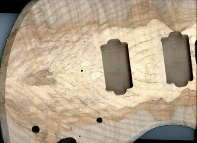

Re: Some maple tops
Do you happen to have a picture of what that spalted top looked like before the dye?

Yes, Dan, the dye (in this case regular watercolor paint from a tube, mixed with water) was just wiped on with a cloth. Same color everywhere, the spalted wood just took it differently, and somehow the black component was muted or lost.
