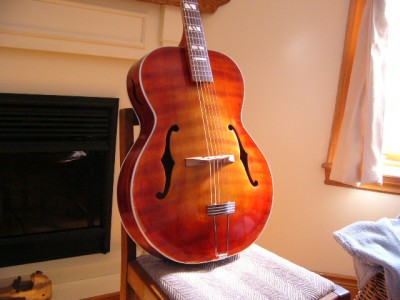

What affects the natural resonant frequency of an archtop, and what can you do about it? My archtop has a fairly definite resonance at D (4th string open D). When I sing into the side port and hit that note, it really resonates. The has the effect of making that note somewhat dead sounding. More dead fifth string fifth fret D than open D, if that makes sense. So I wonder what are the parameters that cause this? I suspect (based on tapping for tone) that my back and top are too close to the same note (they were at least a tone apart before I glued up the box, though). I have the traditional f holes and a small side port. I don't really feel like re-tuning the back or anything like that, the guitar sound phenomenal otherwise, to my ears. The bridge is a pretty light (I recall around 23 ounces) one piece Jatoba. I haven't experimented with tail piece weight or anything like that, because I just don't know what might have an effect. Any thoughts?

Normally the 'main air' resonance is the one that responds most strongly when you sing into a hole. This is generally the lowest pitched resonance on a guitar that can produce sound effectively, and that's a pretty high pitch for it if it's the open D string that's affected. It usually comes in somewhere between F# and A on the low E string, although it can be a bit higher on archtops. OTOH, a port can raise that pitch quite a lot: I've never used one an an archtop, since that's usually already high on them and I don't want to kick it up any further.
One most flat tops the next major resonance up is the 'main top' at about the open G string pitch. Again, this will normally be higher on archtops, but all the way up to D is a stretch for that too.
There are ways you can check it out. The 'air' resonance pitches are functions of the size and shape of the box, the sizes and locations of the holes, and how flexible the walls of the box are to some extent. If the pitch of this mode changeswhen you cover over a hole it's most likely an air resonance. Generally, the smaller the hole(s) the lower the 'air' mode pitches will be.
You can find out if the top or back are contributing to it be adding some mass to them. Poster adhesive is a good thing to use, since it's fairly easy to remove and won't leach oil into the wood as modeling clay can. Slap on a wad somewhere near the middle of the top or back and see what happens.
One complication on arch tops is the tailpiece, which can have it's own resonances. Try loading that as well and see what happens. In some cases the back strings between the bridge and tailpiece can get into the act too, although that's not usually such an issue.
Tracking down 'wolf' notes like this can be challenging. On the other hand, once you've found them they are often fairly easy to fix.

Thanks for your thoughts. I've also read the paper you did on body resonances, quite helpful. The idea of the port being involved had occurred to me, but your indication that it can raise the resonance pitch is very interesting. the resonance definitely changes when the port is covered, as does the overall sound of the guitar. I will try the adding weight thing as well.
edit: well, that didn't take but a second! singing into the F hole, with port open - quite strong and noticeable resonance at D, as before. Cover port with hand, less intense resonance at low B. How interesting! I will play with this further! I wonder if a tunnel on the port would have an effect?

A tube or sleeve of some sort on the port will have an effect similar to making it smaller. It's a useful way to fine tune the pitch. Even a paper tube would work. In fact, I saw a report once of a fellow you used cellophane to 'deepen' the F-holes on small violas to drop the 'main air' pitch. Of course, the mode tends to become weaker when you do this.
