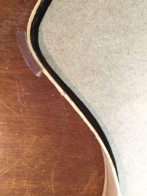

Hello,
I'm starting a rebuild of this old guitar that I posted about a few weeks ago.
https://www.flickr.com/photos/ejknapp/a ... 579281126/

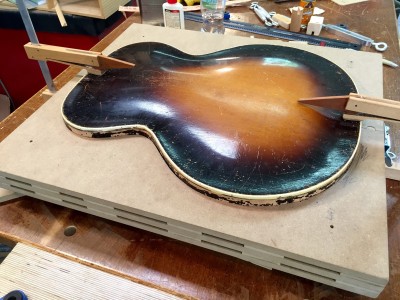

I finished a form for it based on the back which was intact with its binding.
The back fits pretty close to perfectly. It's not too tight with almost no gaps.

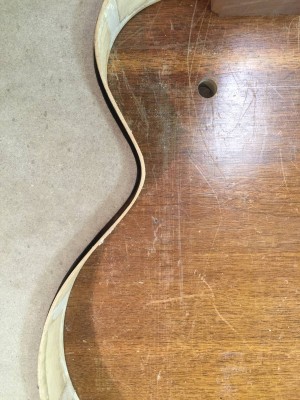

Then I put the sides in. They came to me as you see them, still glued to the neck and tail blocks. They were once attached to the back which fits the form.
The sides don't want to fit. They are too big and won't conform to the form sides even with extreme hand pressure.
I haven't made the clamping brace things yet and I have some questions before I do.
Why do you think the sides won't fit well? Is this normal that you have to use a lot of force to get them evenly against the form?
What do you think I should do? Should I go ahead and make the internal brace/clamps and see if I can get them to fit? (Yeah, I have to do that anyway.) Should I make some adjustment? This is all new territory for me. What is the wisdom of the experienced?
Thanks,

- Posts: 922
Re: Rebuild Project - Question about Forms and Fit
I would make up some internal push-clamps and slowly move the sides out, humidifying as it went. It might take a week to push them out and get them to stay with no pressure, but they really are very close now. I'm really jealous that you get to do this, not me, btw!
Edit: Did you account for the binding and purfling dimension when you fitted the form to the back? The form should be 1/16" clear of the back everywhere, so 1/8" longer and 1/8" wider across all the side to side dimensions. My 1946 Epiphone has 1/16" thick binding on the back, which would be typical.

- Posts: 3254
It is not unusual for an old guitar back to shrink in width whereas the side will not shrink much from drying. That is because when wood drys it shrinks more in width than length. I would not force the sides to fit the form because that would probably crack them. You have a decision to make. Either take some length off the sides so they fit the back or somehow make the back wider (which would be very difficult). What about the top? Is it the same size as the back?

Heh, I'm trying to make up for lost time, I've had this project guitar for too long.Brian Evans wrote:I would make up some internal push-clamps and slowly move the sides out, humidifying as it went. It might take a week to push them out and get them to stay with no pressure, but they really are very close now. I'm really jealous that you get to do this, not me, btw!
I believe I did but correct me if I'm wrong. The back still has the binding and there wasn't any purfling. Here's a closer pic.Brian Evans wrote:Edit: Did you account for the binding and purfling dimension when you fitted the form to the back? The form should be 1/16" clear of the back everywhere, so 1/8" longer and 1/8" wider across all the side to side dimensions. My 1946 Epiphone has 1/16" thick binding on the back, which would be typical.
I am assuming that is the original outside dimension. Right?

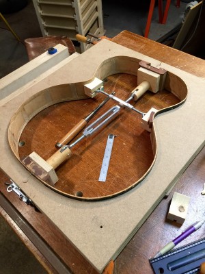

Well, now! It looks like my sides and back might be the same size after all. I made the push clamps with a simple naive implementation. They seem to work well enough for now.
As I was trying things out I noticed that the mold itself was too small. It was the right width but was not long enough. I tweaked the mold and the back fits perfectly to the sides with minimal clamping pressure with the push clamps.
This project seems fully backwards from making a new guitar. Fitting the mold to an existing guitar seems like a different skill and I'm making this up as I go.
Thanks for all the help. Next I am starting on the neck. I have to make a new one so the adventure begins.
