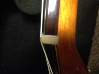

The nut does not have flat slots, it has ramps which makes the strings contact further towards the head stock which contributes to the above problems.
Also the nut is kind of narrow about 4mm, I did some searching and could not find a nut like this anywhere. The standard seems to be flat slots and 6mm thick.
It seems if I am going to make a new saddle I should probably replace the nut first with one that has flat slots which will make the strings about 2mm shorter which should help intonation.
Here is a picture of the nut.
Thanks for any advise.

I think you are going to need the help of a calculator and an equation for figuring fret placement. Fortunately there is an abundance of fret spacing calculators on the internet. Next you need a decent measuring device, whether a ruler or a caliper to measure the distance of frets from the nut. Determine whether the frets are correct or not before modifying anything.
Your nut should have the slots cut as ramps so the strings are supported at the very end of the fingerboard, UNLESS the frets are not in the correct place.

First thing I would do, is change the nut.
The edge of the nut facing the fret board should be at 90 degrees vertically, to the end of the fret board.
Assuming that your fret board is fretted properly, that should at least get that end of things fixed.
Next is replacing the bridge.
With a bridge that is 3.3 mm thick, you may have enough there to shape the top edge back to the rear, thereby making your intonation better.
If that is not enough adjustment, then you may have to move the entire bridge plate.

I am going to replace the nut.
I measured the distance from the front edge of the nut to the first fret and it appears to be right, so I don't know why they used this nut.

A pre-made nut does not mean that you still don't need to file the slots to the proper height. And like you said, the dimensions and string spacing are not likely to be correct for your guitar.
If you have a set of needle files you can make the nut from scratch to fit your specific guitar.

Removing material from the bottom of the nut may work to a degree. At least it could get you close, as long as you don't go too far. The height of the slots is based on the crown of the fretboard. Also the higher strings should be closer to the fret than the lower strings.

And I would imagine your plan of just taking it off the bottom would be extremely difficult. There is a very good chance you could go to far and then you've just wasted a nut. Not the mention the likelihood of getting the bottom all out of square. and as Barry alluded to, if the slots on the nut aren't already matched to the radius of your fretboard then there's another problem. Doing this the right way, even without the best tools is really the best way to go.
