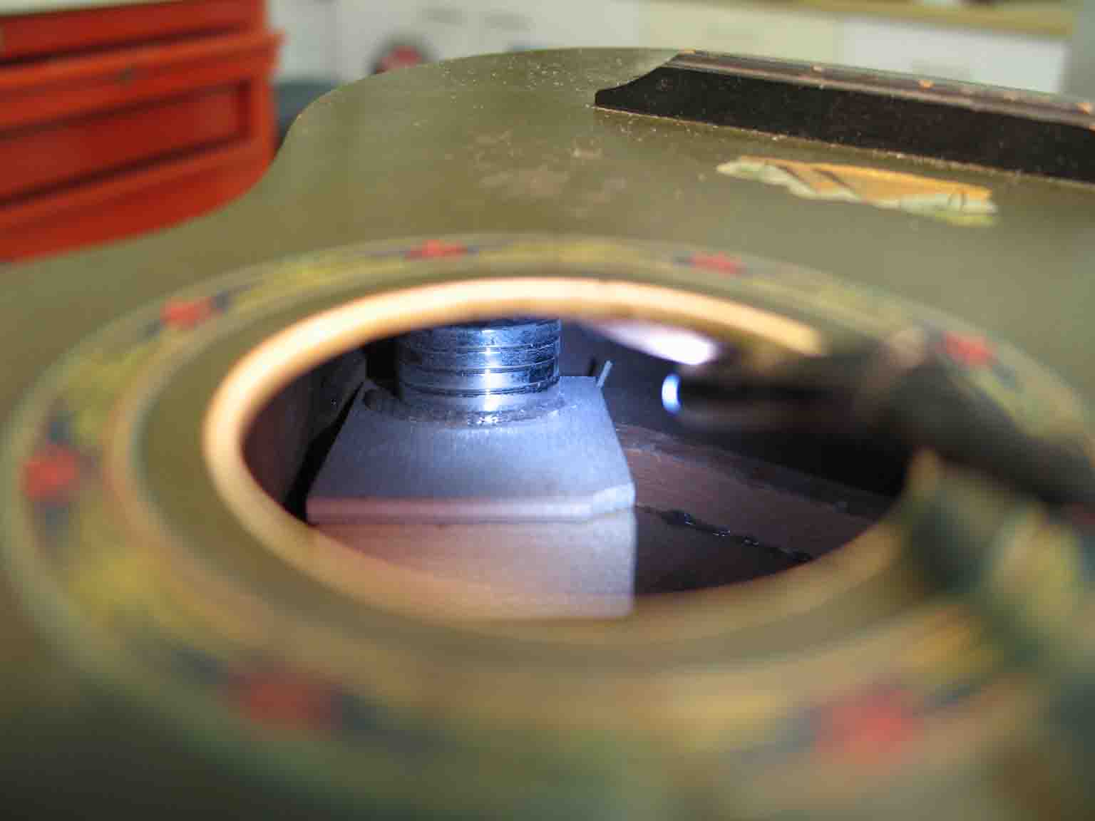

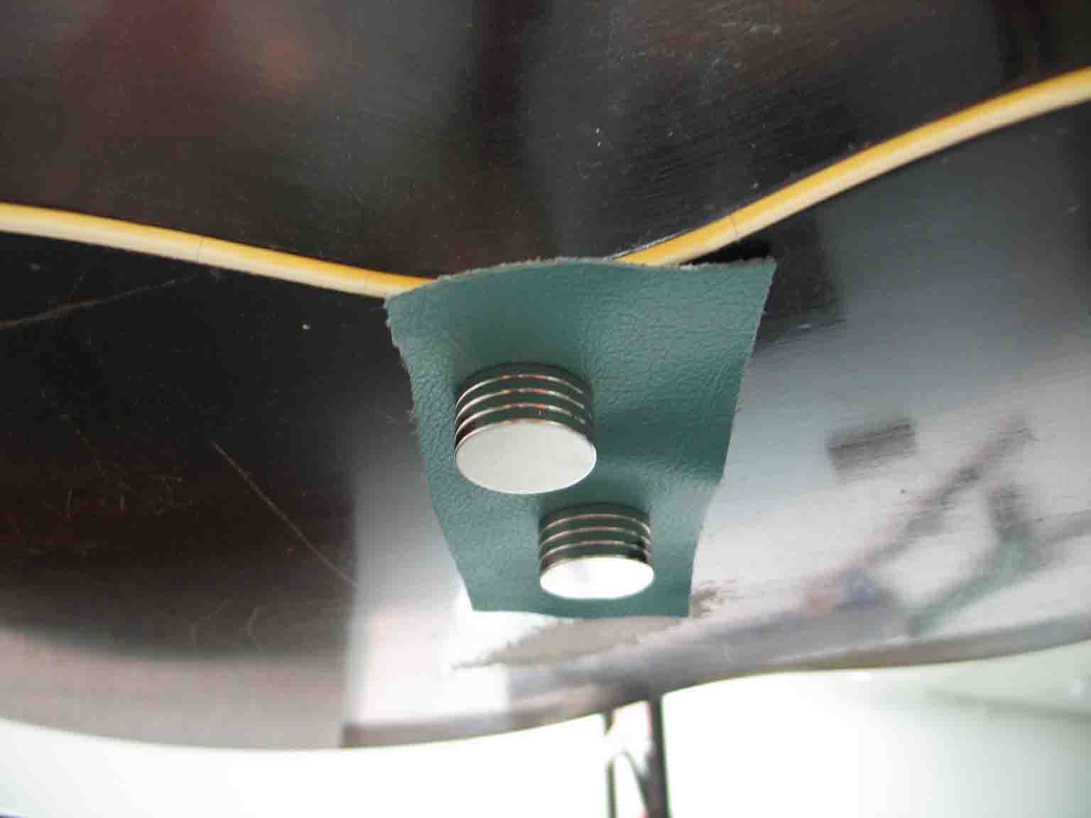

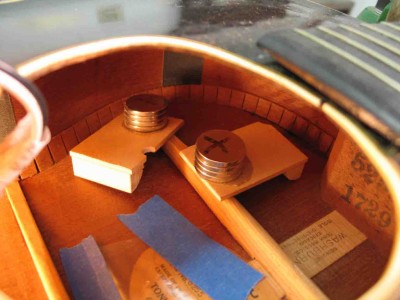

I made these very simple fixtures, with the magnets double stick taped on. I think the image gets the idea across and solves how you get a magnet to balance on top of a brace. The magnets are 1" X 1/8" Neodymium, four used inside and 4 outside is usually enough magnetic pull the get the job done. If you pay attention to the polarity, and you should, you can also use their repulsive power to arrange the fixtures pretty close to a neighbor. You can see I have mine labeled + and - so I can keep track of them once glue has been applied. Clear the deck of anything magnetic in proximity to your project! Lay the magnets out on the bench ready to go in order, organization will help negate the chance of flying magnets. With a sound hole that is large enough to get a hand in there, place the magnet fixture with one hand and hold it in place, then bring the other magnet on the outside to it while grasping it firmly in some protective leather. With an instrument that the sound hole is too small or the brace can't be reached, use something like a steel palette knife, taped to a dowel rod if necessary, and put it into position and hold it there while bringing the outside magnet set into place.
Practice your set up! Do a dry run of both arranging the magnets on the bench and placing them in the instrument. If you have never messed around with Neodymium magnets, play around with them before they ever even get near your bench and get a feel for them. Watch out though, they can raise a blood blister on your fingers before you even know what happened, they are VERY strong! The last thing you want is to have some slip up during placement and have magnets go flying around in an instrument, they can easily crack or break thin instrument wood if not carefully handled.

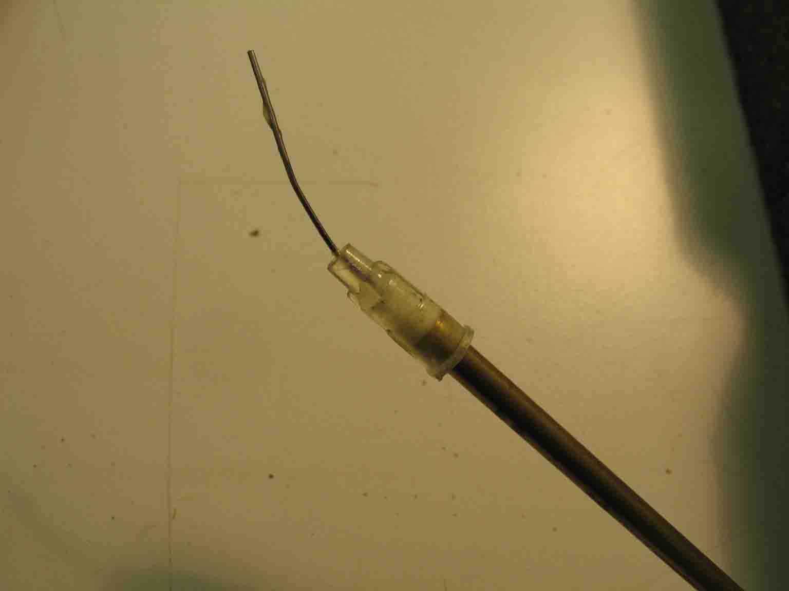

This is the rig I use to get glue delivered. A Stew Mac glue hypo, some 5/32" brass and vinyl tubing and a hypodermic needle. The Brass tubing is bent/ shaped for the job. I have a good assorted collection of shapes now.
I generally use original Titebond, diluted some with water but have also used it with hot hide glue. The problem with using hide glue in it is keeping it warm enough to not gel. I solved that by using an Infra Red lamp and the glue injector on a small sheet of Black laminated board. Infra Red won't heat up shiny objects but it gets the Black laminate good and hot. Use the injector combined with thin palette knives to get the glue under the loose brace. Have a reaching tool ready with a small bit of rag fixed it that will be dipped in water and used for glue clean up.

Re: back brace gluing problem
I like John G.'s idea. It looks less complicated than the "sound post" idea I suggested. I'll have to remember that one.
