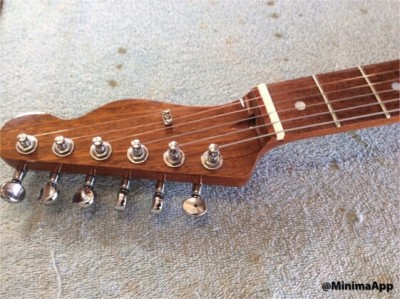

I know you're worried about shortening the scale length by 0.0115" (which would be within my margin of error :oops:) by widening the current fret slot. Depending on how much fret board you have in back of that slot, you could use it for a zero fret (which would keep the scale length correct) and then make a slot for a nut/string spacer in back of that, or just have it butt against the end of the fret board.
http://www.sgd-lutherie.com/images/DSC02735.jpg
