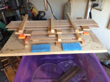

stickered lumber.JPG (30.82 KiB) Viewed 8796 times
Here's a picture of my next instrument's "stickered" sandwich. Someone earlier stated that "stickering" isn't necessary if your wood is dry. That's probably true if your material is kept in a stable humidity. I'm in the desert and the humidity varies a lot, so I keep my lumber stickered. Notice in the front of the stack there are two small sponges. These go inside the blanket box with my stickered sandwich. When the humidity gets below 40%, I soak the sponges, wring them out and put one in each end of the box well away from my lumber.
I travel during the summer and this blanket box goes under my motorhome couch. My pickup truck is stuffed with a portable woodworking shop that I set up when I am settled in someplace for awhile. I'm a pretty small scale operator and don't have a lot of wood around, just enough for my next project.
