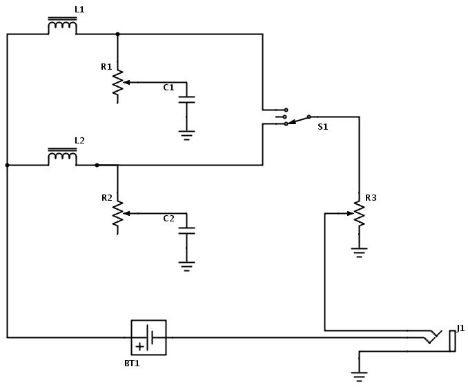

Here's the schematic. That's not a good representation of the switch- it's a 3-position switch that turns on one PU, or the other, or both. I've been tweaking it, it's a work in progress, but this is where it's at now:

If you have a VOM or DMM see if there's a dc voltage across the volume pot. You probably just need a DC blocking capacitor or two between the pickups and the output jack. I'm pretty sure that's why your volume is noisy. The caps should have been built into the pickups but we don't know that for sure.

I grabbed my multi-meter and checked the battery first, just for reference: 8.77V. I plugged the guitar in to the amp and checked the volume pot. There is most certainly a DC voltage across it. I read a voltage drop across the volume pot that varies from 0 to 9, depending on the volume setting.
So if I understand this properly, we either want the full voltage drop across the pickups (which would be the case if they had a cap built in), or the full voltage drop downstream of the volume pot, which would be the case if we add a cap next to the jack (closest to where the amp would have a DC blocking cap). In the former case, the pot is at 0 potential, in the latter case it's at 9V potential, and no voltage drop in either case. Am I understanding correctly?
Do we prefer one of those cases over the other? Better to add a cap just behind each PU, or one just ahead of the jack?

I think the best would be to put the blocking caps as close to the pickups as possible. Selecting the right value is important as the pickup is an inductor with a variable resistor. Adding a capacitor turns it into a tuned circuit and if the cap is too small it will cut into the audible frequencies, if it's too large a value it won't block all the DC. I'd start with 10mfd electrolytics but make sure you have them in series and get the polarity right.
What buffer circuit did you use in the pickups? Is it the old J-FET Alembic Stratoblaster? https://www.google.com/search?client=sa ... 8&oe=UTF-8
Guitars are supposed to be all AC signal with no DC offset. A DC voltage drop across the pot implies that you are slowly heating up the carbon track in the pot and that's going to generate some noise and use up the battery a lot faster. A problem with designing unity gain preamps for pickups is that unity gain circuits are rather unstable and can go into oscillation. You really need to look for a circuit design that can avoid this. Look at some of these for ideas: https://www.google.com/search?client=sa ... 8&oe=UTF-8

I did not make the PUs myself (which is why one would make the buffer circuit? or else I've got more serious issues than I thought...). They are Schaller S6's.

As far as I can tell the only strat style active pickups Schaller makes are the 273 and 275. The S6 single coils has alnico magnets but it's definitely a passive pickup. What happens when you simply disconnect the battery?
This is a more common error than one might imagine. People see a pickup with a hot and ground and a drain wire and instinctively assume it's an active pickup. No harm done in all likelihood but it would explain something.

I got a set of caps and installed them and this significantly reduced the noise. I went ahead and replaced the pot as well because with all the trial and error, it was pretty abused. I soldered the ground to the shaft washer as mentioned above.
Also, I yanked the battery and it did fine without it. I was wondering why I ever thought they were active in the first place, went back and checked my notes- the vendor that sold them to me calls them active in their wiring lit (thought it just says "...active pickups, like Schallers,...etc.", does not mention model names).
So now everything is nice and quiet! Thank you David for the help!

Thanks for getting back to this. I was really wondering what might be going on. Now you can pull the caps out too as you should have no need for them. They may be blocking some of the low end which might not be a bad thing in a guitar but you won't know until you try it both ways.
