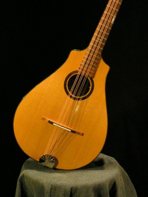

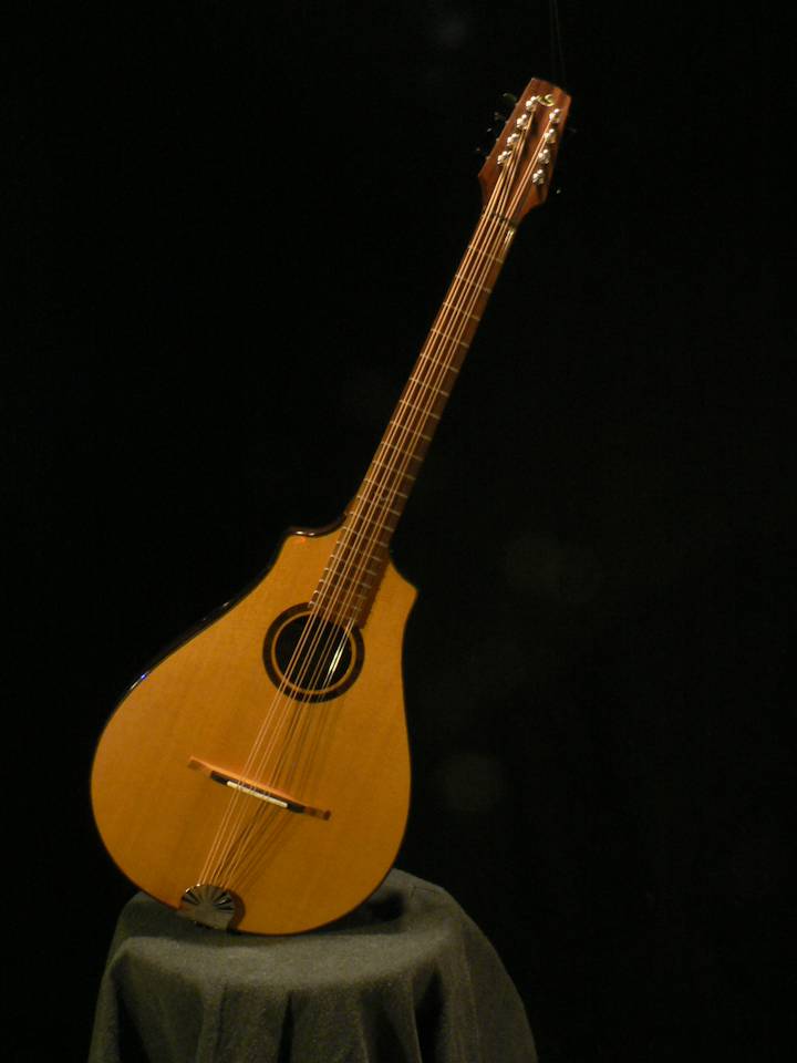

Here are some photos of an "Octofone". This was an instrument that was originally made by Regal, in pre-WW2 times. it is meant to be played as an Octave Mandolin. I own one of the originals, and I re-designed it and here is version 2.0! It has cherry back and sides, A nice old spruce top and mahogany neck. The fingerboard and bridge are Osage Orange, which I baked according to one of the recent discussions here. It darkened nicely.
I am pretty pleased with the tone, it's bigger and louder than I expected, and I actually like the sound better than the wider and flatter octave mandolins I have built before.

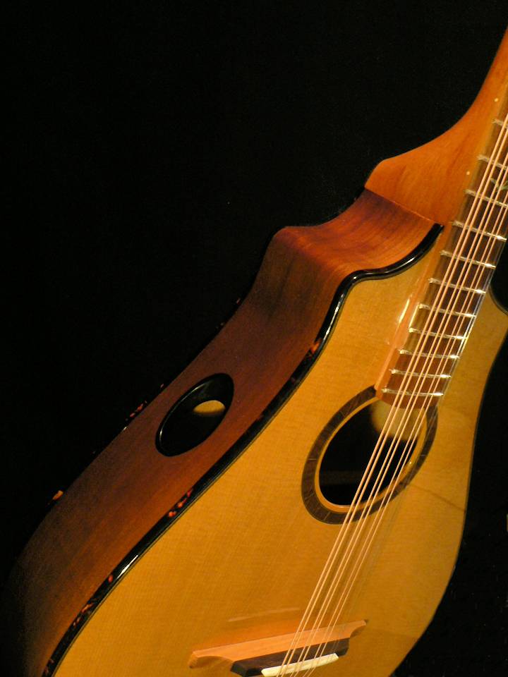

I had an idea for a cool soundport insert...if I cut a round tube at an angle, I got a section that looked like this and I inlaid it into the soundport. I'll be doing this again!

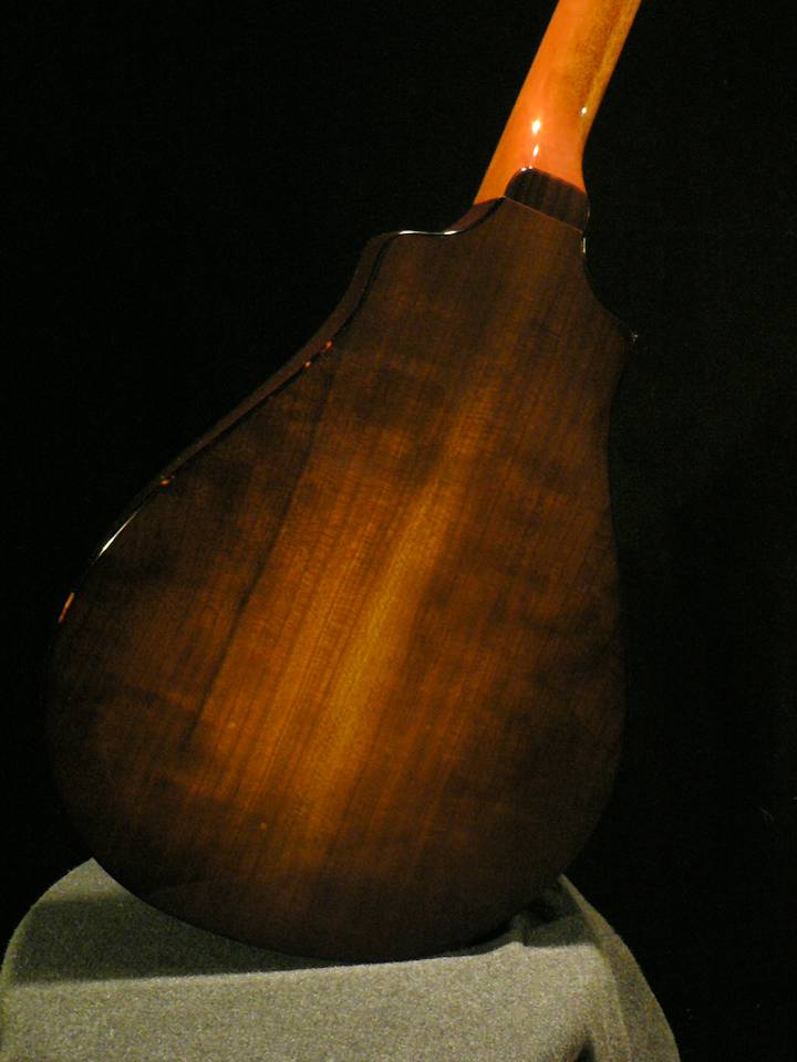

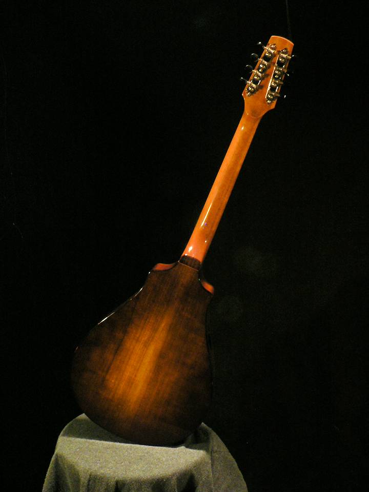

The back and sides are tinted with a bit of tobacco brown. I did a slight burst on the back...the color looks blotchy here, but that is something the photo did. It doesn't look that way in person.

Very nice! I like the shape, the coloring, everything I see. What kind of top curve do you have? Did you x-brace it? I recently did a fingerboard with Osage Orange the same way. I was very pleased with it.

Thanks! I used a 15' radius on the top and back. 3.0? Not yet, this is the first 2.0 I have made, I'll stick with this for a while!

That soundport is all kinds of cool. What type of tube did you use (what is the material)?
Re: The Octofone 2.0
I'll put up some sort of soundclip soon...For the tube, I actually used a piece of shipping tube, some kind of plastic ABS or PVC. I painted it black. For the next ones, I think I'll get some carbon fiber tube from Dragonplate. The woven stuff would look great.

I agree woven carbon wold look cool. What about wrapping a long strip of veneer (with glue) around a rod or pipe building up thickness like a roll of tape to form a short section of wooden pipe. Then cutting that on an angle. You could then, in theory, match any wood bindings you wanted to use. Or glue up a tube similar to a rosette stack, then instead of cutting out several flat slices, you cut them on the angle. If you had a simple repeating top perfling pattern you could match it. Both of those ideas are probably more trouble than they are worth; I'm just brain storming.
How did you go about matching the hole in the side to the section of tube?

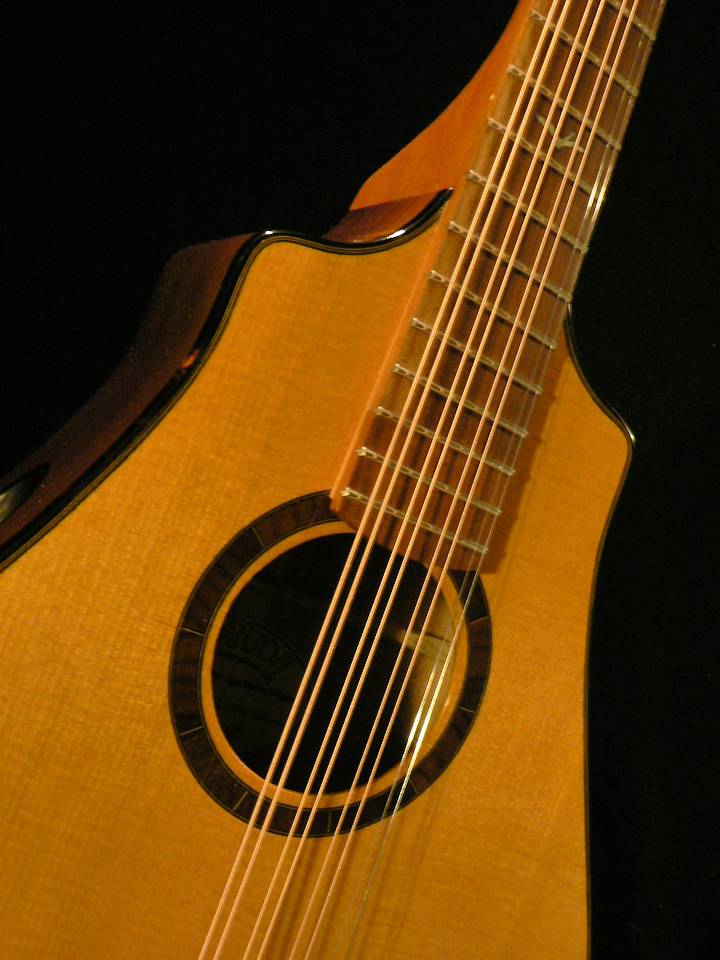

Very, Very nice Mark! I love it. I too would like to hear a sound clip. It is a beautiful instrument. I noticed some nice variation on the binding. Is it wood, or vinyl. I like the cherry very much. I am using cherry for the first time on a 3/4 size classical, now. The two toned bridge is also very nice. I am not familiar with the octofone, how is it tuned?

I tune it as a regular mandolin, one octave lower. There are other ways to do it though.

That sound makes it worth building that instrument. Very nice! What is the scale length?
Thanks, Bob! It's a 22 inch scale.
